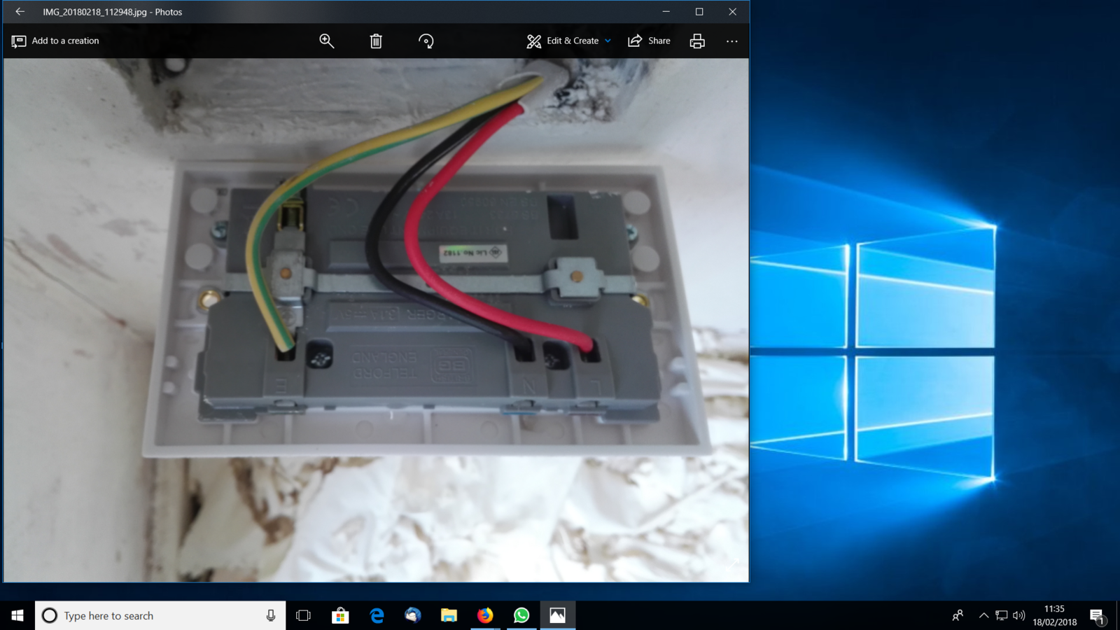

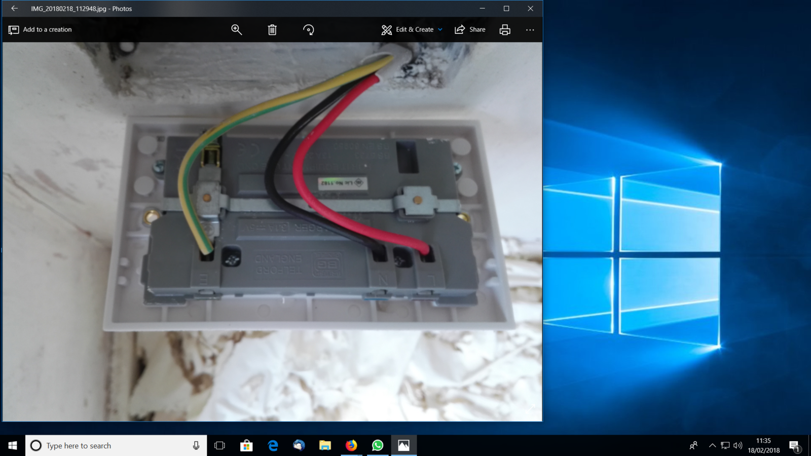

In addition to the above, if you choose to change any of your light switches to dimmers, you might run into the depth problem.
If you choose to fit sockets with USB on board, you might run into the depth problem.
OK, BAS beat me to it by seconds
Thanks. Was going to have a dimmer in the living room and master bedroom, do dimmer switches normally need deeper holes and deeper back boxes?
Usually in the 70s 16mm deep boxes were fitted for light switches. Some dimmers with a chunkier surface profile will fit on the shallow boxes, slimmer profile dimmers will need a 25mm deep box.
They may have improved on the design since I last used them
This is one I swapped from a non-USB socket. Is it the same design?
TBH, I don't know how much work is needed/being done/already done to this place, but if builders and electricians are on site it might be worth having any shallow boxes replaced as they go.
