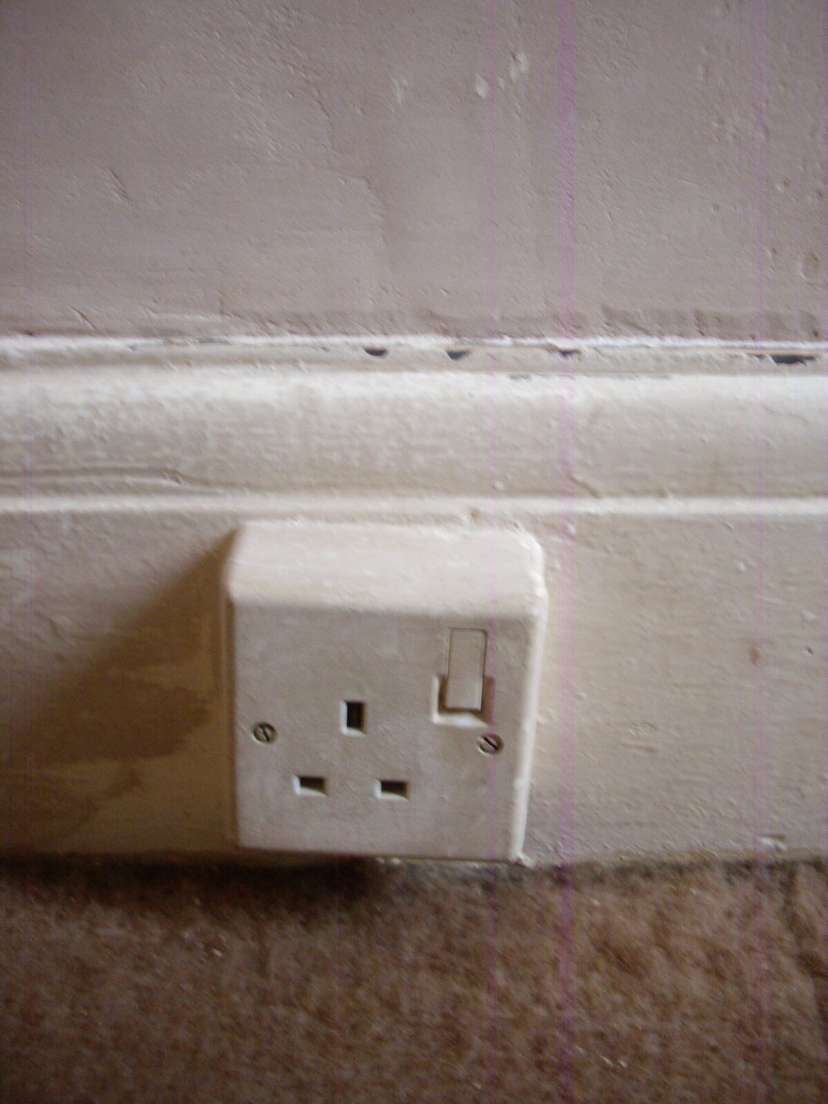

I'm currently redecorating a room where a single socket sticks out from the skirting board and i've an idea to replace it with a double socket - but i only have the cover: can i enlarge the hole where the single socket is now and screw the double into the wood, or should i get a complete box to put into the wall above?
Better to do it before i clean up the skirting and paint, methinks.

I haven't got to that stage yet - it's still in R&D - but my guess is the cables run under the floorboards, so i'll take my cam today for a better view when i reach that point where a decision has to be made.
When you look under the floor, you might find the "ring" runs along next to the wall and rises up for each socket.
It might be possible go rise up to two new sockets in the wall (at a convenient distance apart) using the existing cable, and a new piece of cable bridging between them.
This is handy in old houses with insufficient sockets, and avoids contriving "maintenance free" joints.
I don't want to take up the carpet sq. just yet but there's another socket behind this one in another room - can i assume they're linked?
It'd be so much easier to use the existing wiring to connect a double socket and screw the face onto the skirting without using a back box.
As an interim measure could you turn the sockets through 90 degrees? Some older single boxes had four fixing lugs so just release the faceplate and turn, if they don't have four lugs you will have to unscrew the back box and turn that. Ok it doesn't stop you kicking them etc but it means they become usable
As has been suggested, wouldn't 180 degrees be more appropriate ('as an interim measure')? - and that would work even with 2-lug back-boxes.
