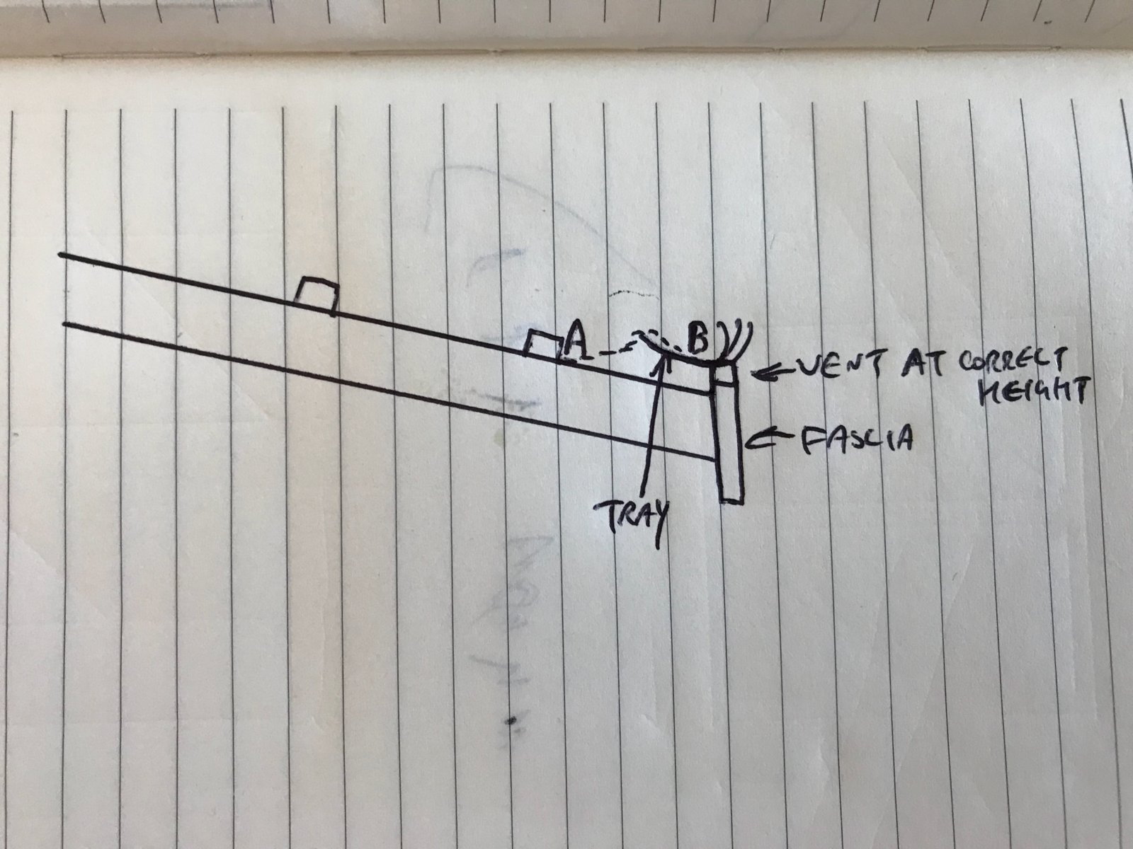

17degree roof, marley mendips tiles, combined eaves tray and bird comb at the eaves supposed to be fixed to the top of the fascia and felt rested on top of it. However level of bottom tile batten is lower than top of eaves vent, so felt would droop. Eaves tile angle correct with this installed. Not sure what my options are other than bin the eaves tray or put the felt below it instead, which would totally negate the ventilation aspect of it?
Strange as it says suitable for min 15 degrees pitch so not sure what I’ve done wrong
Bottom tile droops then
How can it?
Work out what height the tile needs to be, and the vent goes at that height. Then you know how deep the fascia needs to be.
Fix the fascia, fix the vent and then get out of the sun.
See pic, point b is higher than point a
Vent is at the correct height for the tile angle

I take it all back, I seem to have something wrong with my eyesight, as a level does indeed confirm it’s a downward slope (just). I really need to keep out of the sun now. Sorry to waste your time on such a nice day (y)
