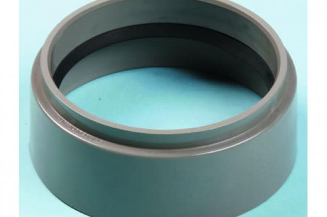

Terrain offer an adaptor to covert a solvent socket into a ring seal to create as expansion joint where required. 109.4G.jpg

Funnily enough, last job I was on had that in situ... Took me a while to work out what it was (while I was planning new runs) and when I realised, I thought it was a good product (y)
