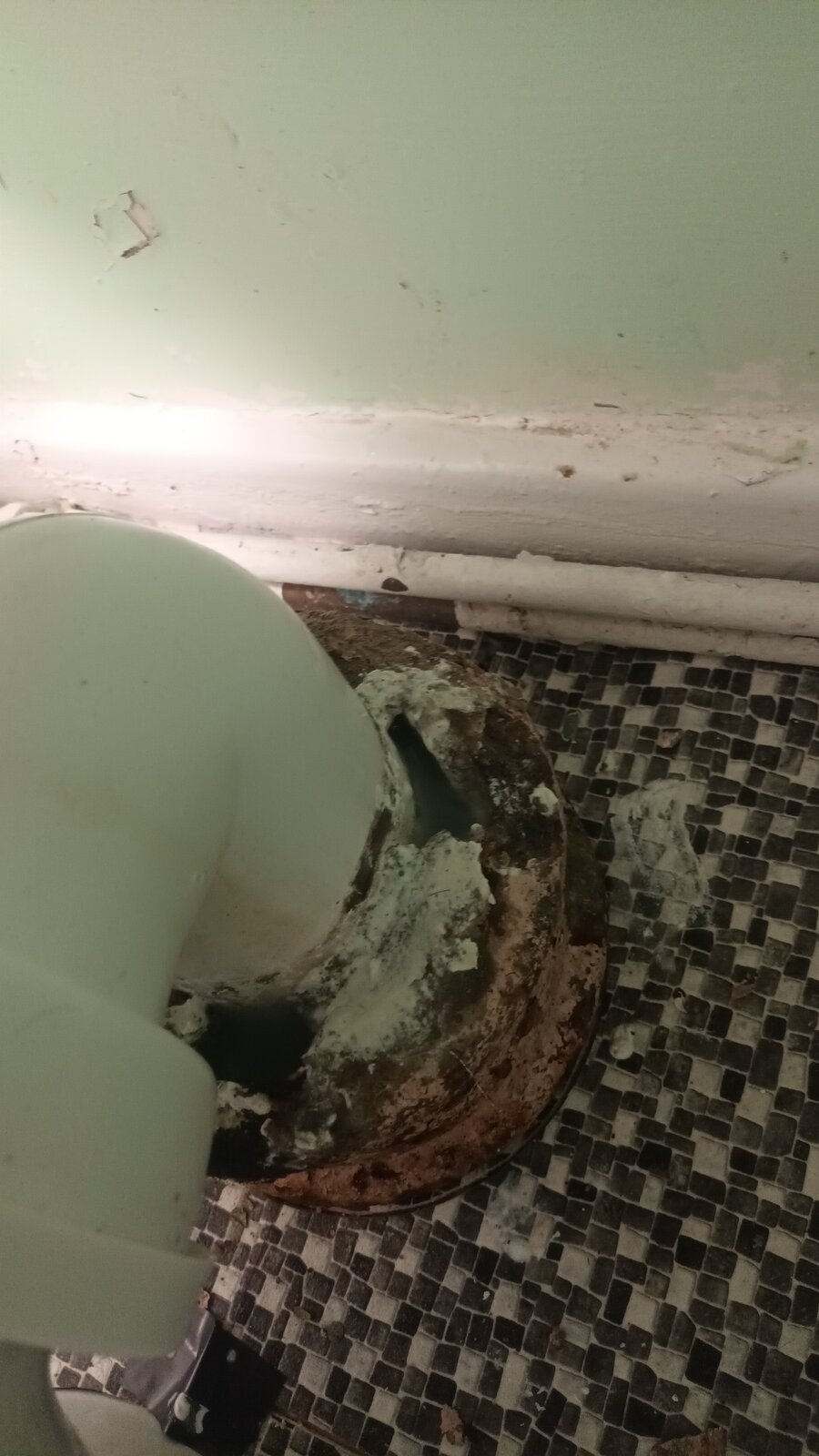

Hi to all on not DIY forums I moved into a flat in W,yorks in June and noticed I were getting slugs in my flat bathroom and W.C. and for weeks I wondered how the slugs were getting inside the bathroom just over a week a so ago.
I noticed a gap in my internal sewer pipe where the iron barrel stack pipe has the narrower plastic pipe plumbed in and just been filled in with cement as the pipes are different circumfrances the iron barrel 4 inch been imperial and the later plastic pipe 85mm metric size. The cement ont the pipe has eroded away and the iron pipe quite corroded and thus left a quarter inch gap between the 2 pipes were they are joined could anyone help on how to reseal the gap on the pipe joint?
Can you add a picture
Yes here is one of where the hole is on the joint of the pipe on my basin if you need a left hand shot of the pipe Wayners: can do that also

That's really needs replacing with plastic soil pipe insert.
Depends on pipe condition but I suspect it all needs replacing with plastic.
What is your plan. Temporary fix or look to replace?
OP,
The quickest, simplest & cheapest method of dealing with what you have is to remove the WC up & away from the soil pipe. Examine the flooring where the pan was for water damage.
Remove the pan connector from the spigot, and then thoroughly clean around the soil pipe opening.
The CI soil pipe might be cracked or perished so take well lighted pics from each side of the clean soil pipe?
Are you on the ground floor?

Well 1st of all the flat I live in is a council flat owned by Kirklees council they are responsible for the upkeep of any jobs as the council officer for this area l live in at huddersfield is the landlady of the area is a area estate manager a better name for her job.
Yes the flat is on the ground floor it's a semi detached block of 4 flats the upstairs neighbours soil pipe from his bathroom W.C. is also joined onto the same cast iron pipe that runs into the sewer ducts as my cast iron barrel stack joins onto the main soil pipe by means of a right angle under the foundation of the floor.
Someone is coming to look at it what needs doing to render replace the pipe from the council on Monday, would my floor need digging up if I did need a new iron barrel pipe if the old one is cracked or badly corroded Ree?

Would you nige tell me or Ree or Wayne if the pipe is cracked in the floor under the soil or concrete foundation of the flat would my floorboards and concrete flags have to be pulled up and the floor dug out with a electric kangol jack hammer demolition drill outside where the main soil pipe comes down the external wall I'm just dreading it been a hell of a mess just to replace a underground soil pipe.
OP,
Your landlord's contractors will have to make the call whether to dig out the old CI or attempt a repair?
Depending on a number of site conditions, they could attempt a "repair" or they could abandon the old CI soil pipe - & run a more conventional soil pipe in plastic that comes into your b/r thro a clean cut saw hole in the wall.
Inside the CI would be cut level with the floor and then packed with concrete, outside the CI would be disconnected - there would be no need to change the WC. No inside digging would be needed.
That should be pretty easy for a Plumber to remove the pan, clean the Cast up, and refit with a new pan connector. Putty or a suitable sanitary sealant could then be used to tidy up the gap, and provide a secondary seal on the joint.
Pipe can be cleaned and lined if damaged, replacement would be a last resort given it's location.
