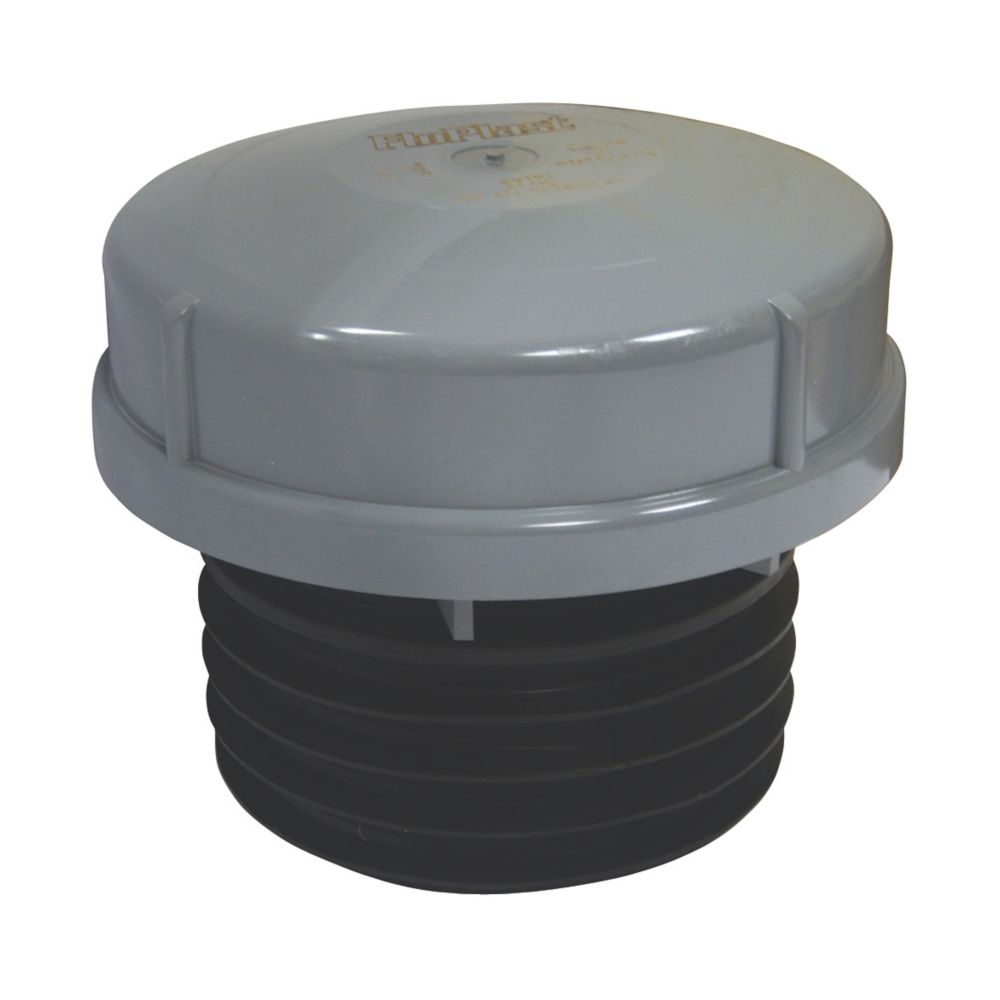

You could get something like the below and remove the vent to outside and have it tiled back over, as long as there is air getting into the soil pipe that is the main thing.
ae235
http://www.screwfix.com/p/floplast-af110g-push-fit-air-admittance-valve-grey/78150

Can that Air Admittance valve be attached side ways on or do i need to angle the PVC pipe 90 degrees first?
If it has good air flow all around and unlikely to get blocks by insulation etc... then I cant see why sideways would matter, but see if anyone can offer a more concrete answer. But if the water is getting in from the roof, changing to the air admittance alone wont solve the issue and you will need to seal the roof/tiles.
Do not replace the open vent with an AAV, it is asking for trouble. Drains need to breathe, an AAV only allows them to breathe in! Building regs also state the head of the drain must be ventilated, so that vent is there for a reason.
Even if you did fit an AAV you still have the issue of the hole in the roof to deal with! I suspect the Manthorpe vent tile is the same profile as the roof tiles, so I would be looking at sealing that up if water is getting in internally, possibly extend the soil pipe slightly, fit a 90° bend, then reattach the flexi, that way any rain getting into the vent will disappear down the soil pipe.
