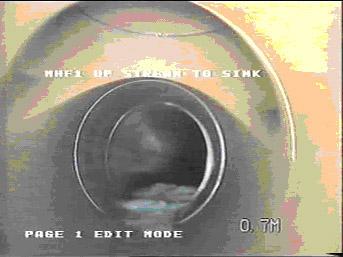

The drains are under the floors which are block and beam. I have worked out the layout from CCTV surveys which have been undertaken. The CCTV also shows a lot of "material" stuck to the sides and top of drains due to the splatter effect of a 5m odd freefall !

Heres the pics
You can see the base of the soil stack at the top of the picture. You are of course looking up the run to the head of theh drain where the whb joins.
It takes about a bucket of water down the sink to clear the build up of solids........and it collects at the very next flush !

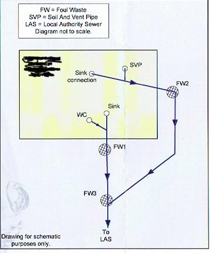

SVP serves two bathrooms (1st Floor and 2nd Floor)
WC is ground floor toilet.
Are the sink wastes below ground in 110mm and reduce at ground level, which is the normal way, or have they reduced in the end of the tee and run 40mm from that point.
Where is the SVP and stud stack positioned.
Hopefully schematic above will help answer your question.
Had to edit my address away !
Sinks are 40mm to ground level and enter 100mm pipes via a boss and radius bend.
So all the pipes in the schematic is 110mm.
In that case to get a back up, the pipes must be running the wrong way, or there's a blockage up stream.

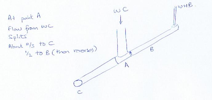

Tried to draw the layout as basically as I can.

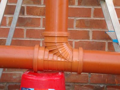

This photo may also help to show what I think the arrangement is (it is the other way round to my drawing):
Stack from above.
Upstream left, downstream right. The equal branch is deceptive as despite appearance the side "arm" in no way tuns the flow entering from this direction.
Does anyone know if the branch would be recommended in any other orientation than with the main flow vertical - as opposed to horizontal in this case ?
Stream from stack hits bottom of branch and heads in both directions (force of falling vertically). About one third heads UP the drain despite fall. This stream should reverse back down drain but is partially obstructed .See the paper in this photo. It is held back UPSTREAM of where the stack joins.
