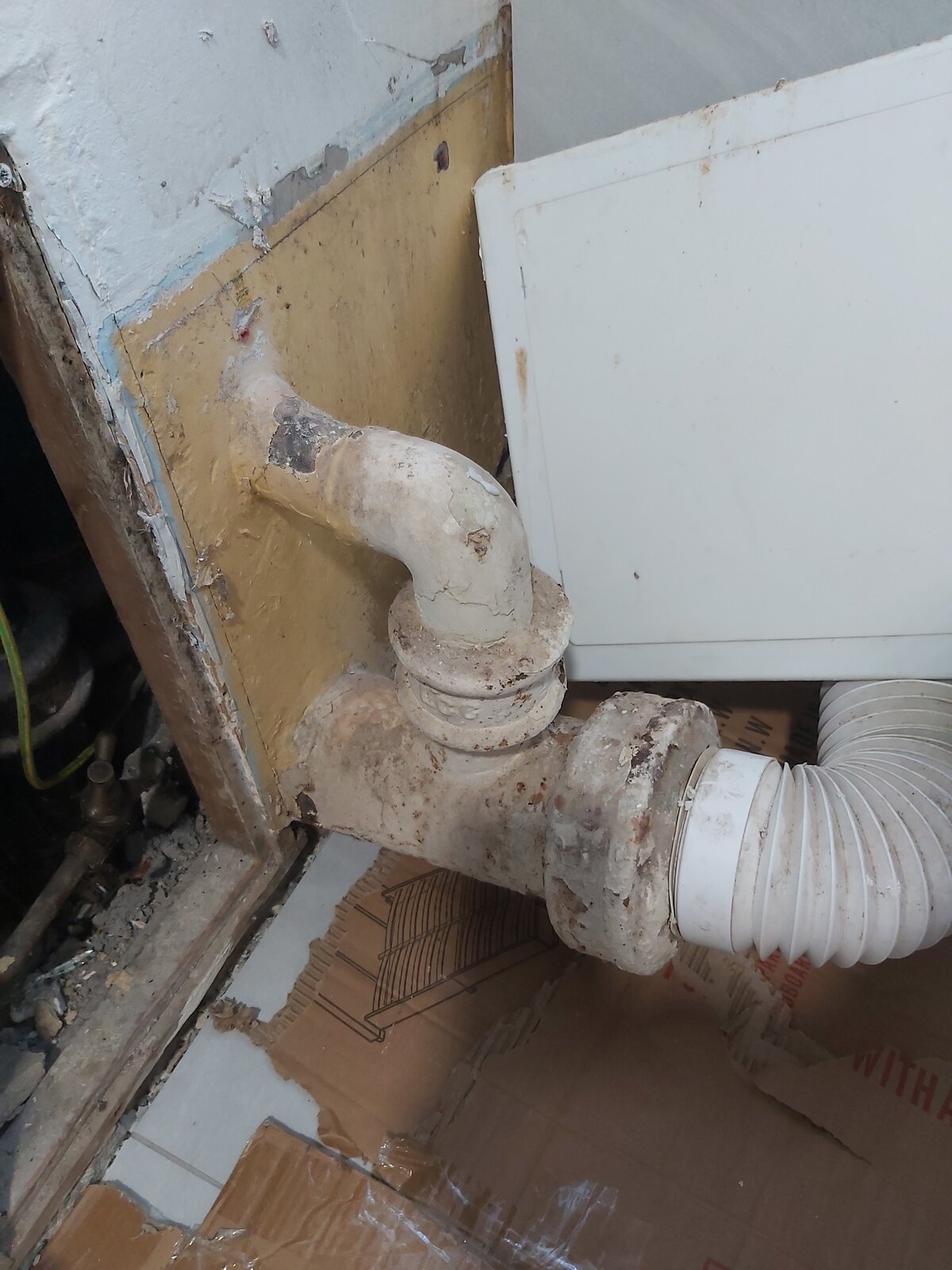

Hi all, newbie here
Have any of you come across this before in a ex council flat ?
I want to cut the stack back and fit a toilet back to the wall. Currently it protrudes out too far but I don't know what the copper pipe going into the top is for.
Thanks in advance.

Not something I’ve seen before, just check if:
  1. It’s connected to another wc
  2. If it forms part of the vent (likely)
Yes it does and thanks a million. you confirmed what I was thinking
An air vent to the stack - in 2 inch copper - it may well go back into the stack @ higher level - so best to seal it with something after it's cut back, or you could get smells.
