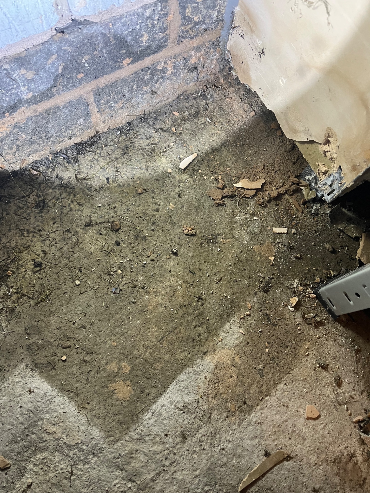

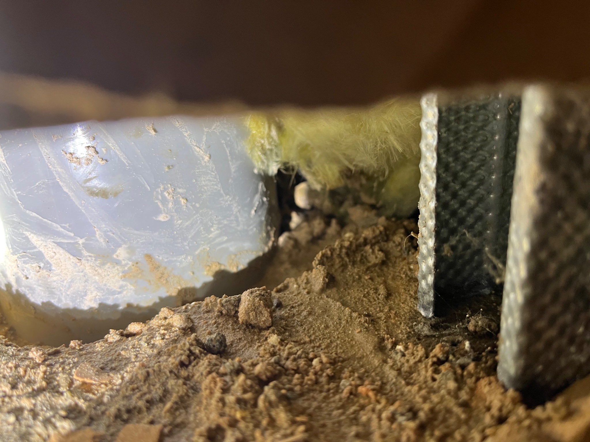

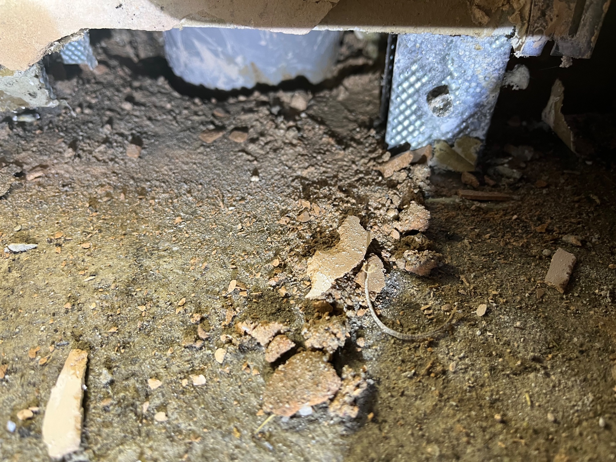

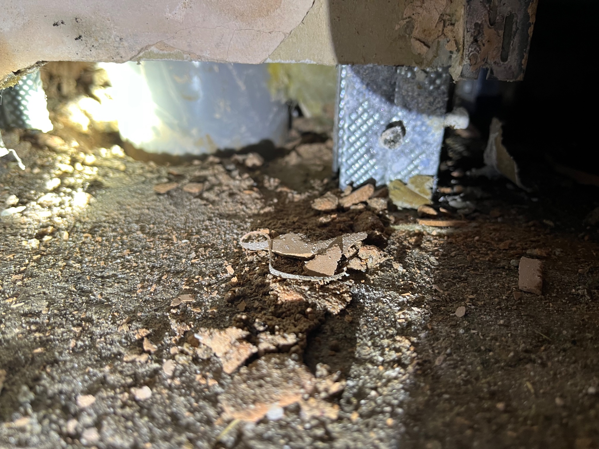

I noticed a damp patch in my garage today. I don’t think it’s been there very long but can’t say how long. On further inspection, the floor is very damp around the base of the soil stack that disappears into the floor presumably to couple up with the sewer feed under the garage. Pipe itself is dry and doesn’t seem to be leaking above the pipe anywhere as has remained dry even after emptying a full bath
I’ll need to remove some of the plasterboard to get access to the pipe. I presumably need to replace a seal between the stack pipe and the pipe it connects to but worried about whether I can remove the stack as it disappears into the floor.

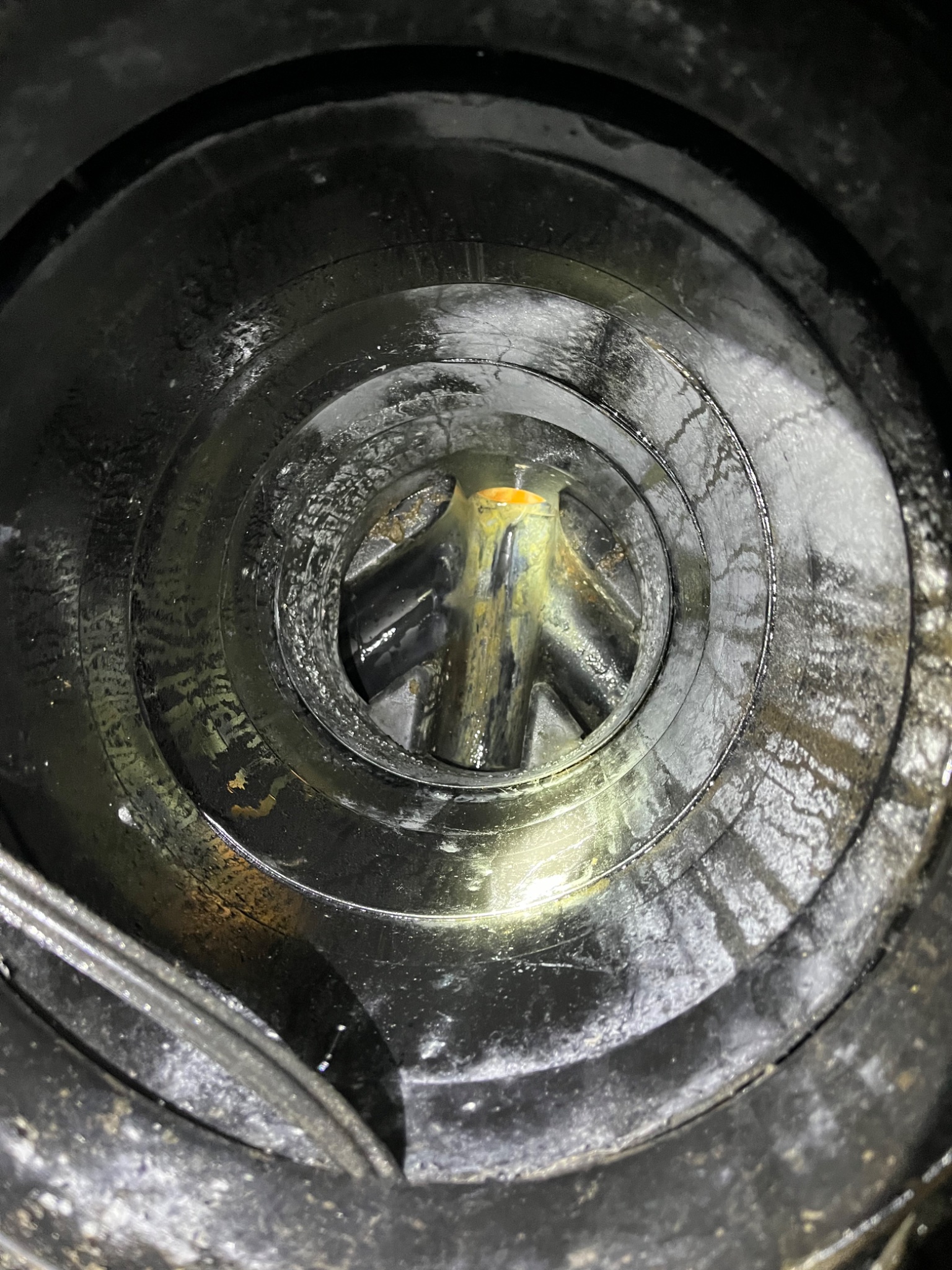

Very rare for it to block in the Vertical Section, (unless a waste pipe has been pushed too far into a Boss and is protruding into the stack and collecting waste), access points fitted to stacks tend to be to offer access Downstream, if it isnt possible to work upstream from a Chamber.
Lift Manhole cover, get someone to flush the WC and see if you can see or hear anything at the Chamber. If you know which direction the Stack is(should) be coming from and no flow appears (or noise from falling water can be heard), then rod in that direction, you should feel any blockage.
Couldn’t resist having a look this evening. So this is the easiest chamber to access. The left hand channel connects to the downstairs WC and the middle channel is connected to the 1st floor WC and presumably the bath and where the soil stack in the garage is draining to. I haven’t worked out what the right hand channel is connected to. I ran the kitchen tap and there was no flow at any of the channels. The water runs from bottom to top of this pic.

Confirmed that all upstairs outlets run through said soil stack out to the middle channel in the chamber. I see flow when flushing WC and running sinks and baths.

Right hand inlet looks clean, I'd wager it's blanked off. Kitchen Wastes must go to the Sewer, if they don't you have a Cross Connection and it'll need rectifying.
Could well be. Either way I’m quite confident the middle channel is the problem one. I’ve managed to get the rods down this evening until I met some firm resistance where I assume is where the pipe changes direction the other end to meet the soil stack.
Couldn’t feel much of a blockage and flushed through with a few toilet flushes and a bath or 2. I suppose only time will tell if I cleared anything as the damp floor in garage should dry up?
Not sure what next steps are now if it doesn’t dry up. CCTV? Cut into the soil stack? Could be messy
