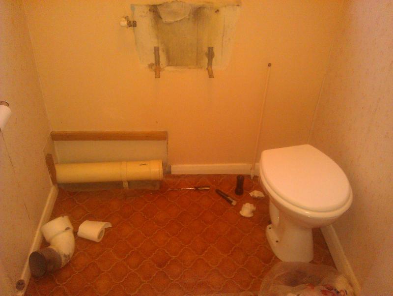

Well after an hour or two (mainly finding my pipe cutter for the pipe feeding the cistern) I have managed the following:
Toilet and cistern removed

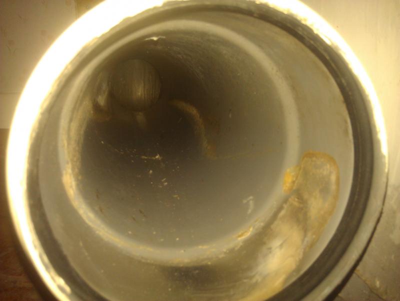

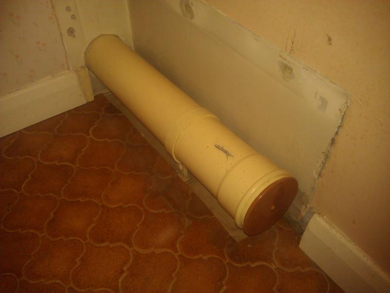

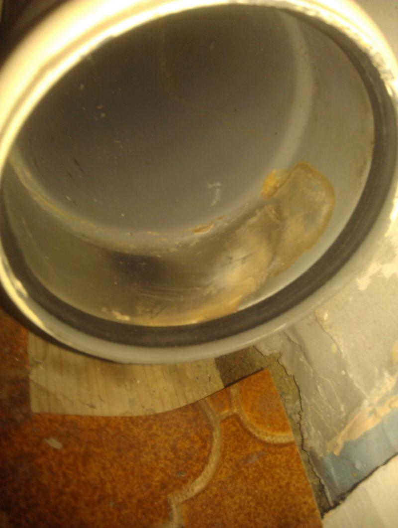

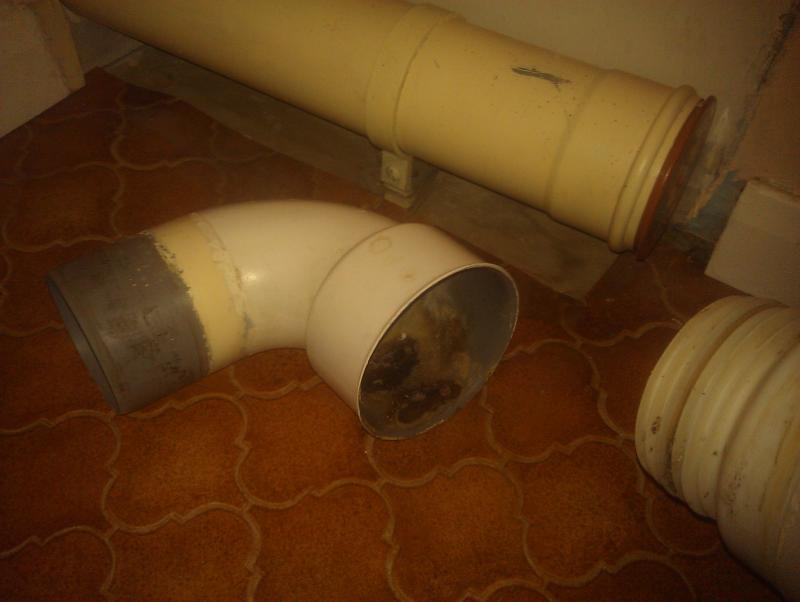

90 degree toilet attachment removed from 110mm waste pipe after some fairly robust persuasion. It had been painted so a quick run around with a blade freed that. The pipe had been fully inserted right up to the end of the socket so took some effort and gentle prying with a flat bladed screwdriver as there was no initial wiggle.
Removed the seal in the 110mm waste pipe and cleaned seal and pipe then replaced and inserted end cap for now. Used some silicone lube which helped but is still a firm fit (I'd be happy to reuse).
Installed new temporary toilet facility
Will be carefully drilling / chiselling wall around 110mm waste next (after purchasing an SDS drill) to open this up to allow access.
Having looked down pipe there is a juction between the horizontal waste pipe from the toilet and the 90 degree t connection on the soil stack in the bathroom - the juction is currently located in the wall.
Will no doubt all get a little more tricky now due to restricted access.
