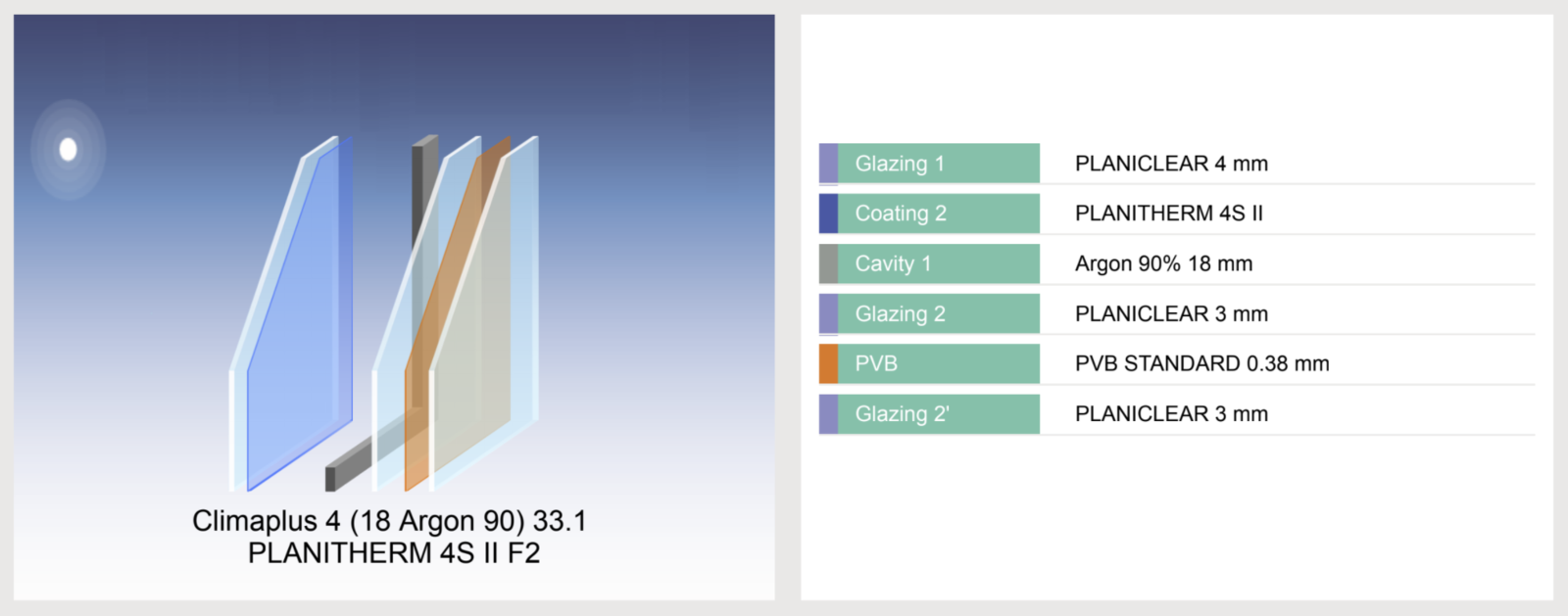

I was hoping for some advice. We've got two south south west facing full hight loft windows. We're considering solar control glass as I know lofts have a habit of getting very hot and windows that size aren't going to help.
I was hoping someone could advise on cost. I don't know if this has an effect, but the windows need to be toughened and laminated. I'm being told that the solar glass will cost 3x the price of normal glass. Does that sound correct, as it seems quite steep to me?

The spec for the glass is this:
