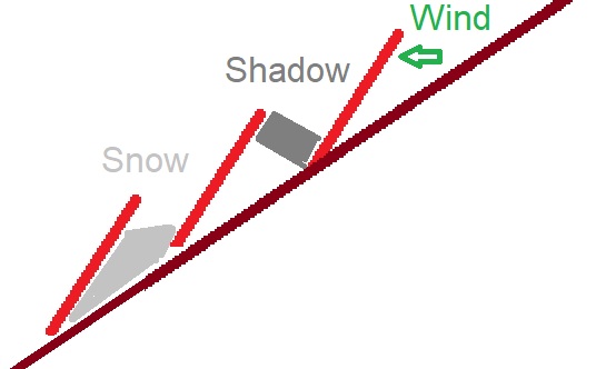

In the UK the usual angle for a pitched roof (~35 deg) is so close to the year-round optimum that it is not usually worthwhile to fit panels other than parallel to it in view of the extra cost, extra wind loading and hassle with PP. Flat roofs are another matter.
as I have seen many panel on flat roofs that have been angled
A flat roof is a totally different matter.
If the panels on a pitched roof are not parallel to the pitch of the roof then they will be at risk of being torn off the roof from wind and/or snow build up. There may also be a problem with one panel shading the panel above it reducing the effective area.

Altering the angle will have very little effect on generation but will create a pile of problems and expense.
Winter output will always be dramatically less that in the summer. Adjusting angles will not change that.
The only viable way to have various angles throughout the year is to have a ground mounted system with tracking installed, and that will cost many multiples of a roof system, and even with that, most of the gains will be in the summer.
