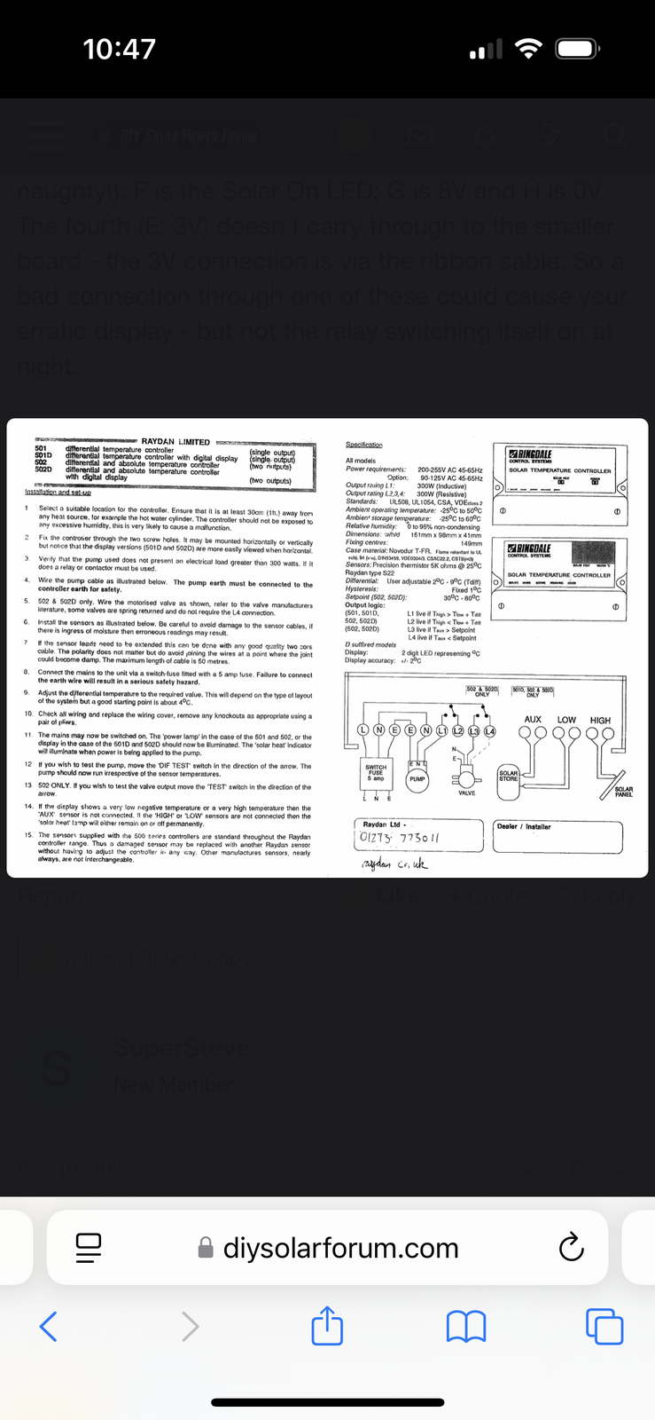

All I’ve managed to find was this
I was under the impression the differential was the difference in tank temp vs the solar panel temp

There's quite a lot of info in that attachment but some, like the output logic, a bit confusing, to me, at any rate.
The cylinder shows two probes (quite normal), one, the "Low" is installed just above the solar heating coil, the other, "Aux" is installed (normally) in the cylinder top with the boiler coil below it may be heating maybe the upper two thirds of the cylinder so you could have the upper two thirds at 70C but the lower as low as 15C or so, the solar system should then heat this one third up as well, OR if no boiler on, the solar will heat the whole cylinder.
The pump shows a start contact L1 but doesn't show what energises this as the logic shows this switched only for controller models 501 & 501D, (yours is 502D), what it does show though is that the pump stop contact L2 is energised when "T.high < T.low+T.diff which means when the solar panel temperature is (or falls) to the store temperature+4C then the pump stops, this means, by inference, that once the solar panel temperature reaches store temperature + 4C + the hysteresis (given as 1C), ie, when the panel temperature increases to store temp + 5C then the L2 is de energised and the contacts will switch over to L1 and pump restart. If this is how it operates then very unusual IMO to use a normally closed (NC) contact and a set switching hysteresis of 1C but it is what it is, maybe?. I would also increase that 50C SP to say 65C.
Its a mystery though why the circ pump runs for hours on end as we can see now that its not variable speed controlled, the schematic also shows a motorised valve, don't know what this does. Your cylinder should heat up in a few hours in this weather using solar only, mine is reaching 65/70C every day for the past 4 or 5 days.
Hmm okay from my research this is a very old controller, 90s electronics inside maybe 80s maybe worth noting the tubes are rather old I don’t have an actual install date but definatky older than 2011 so probably not as efficient as yours, I’ll change the settings as you said and continue to use them under supervision as they do heat the water just slowly, I’m just more concerned the circulation pump is going to burn out (it’s a grundfos ups 15/50) ….there not cheap either lol
If L1 was the switched pump contact like its being showed for models 501&501D, switching when the solar panel temp is > the store temp + Tdiff + hysteresis, then that would make real logical sense, thats how mine is done + a much bigger switching hysteresis, there may be no E.tube degradation as the pump, in effect is running all the time as its might be wrongly switched on and the solar panel is, at times actually re cooling the water in the cylinder, maybe worth switching the wiring from L2 to L1,

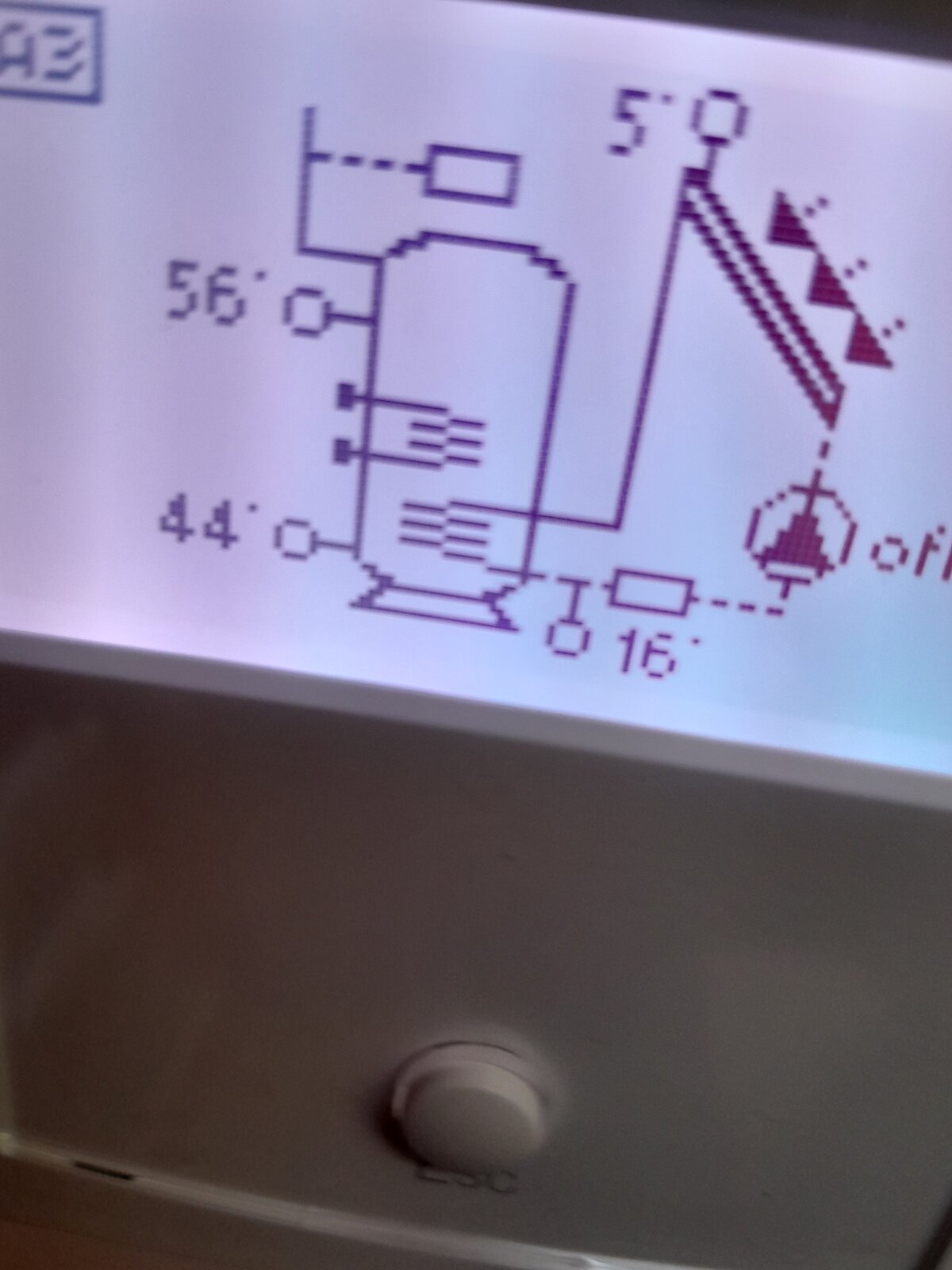

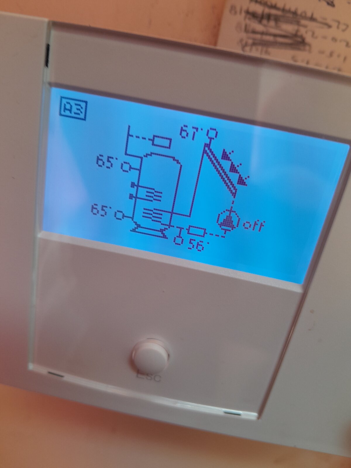

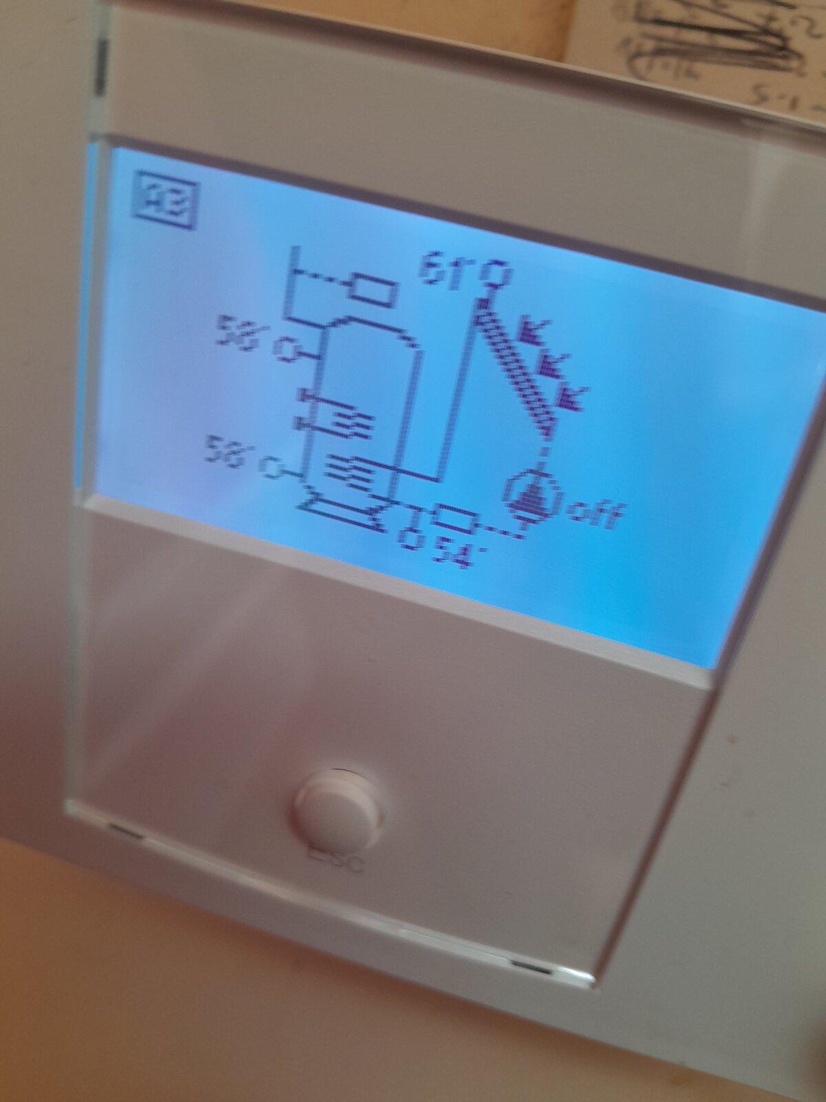

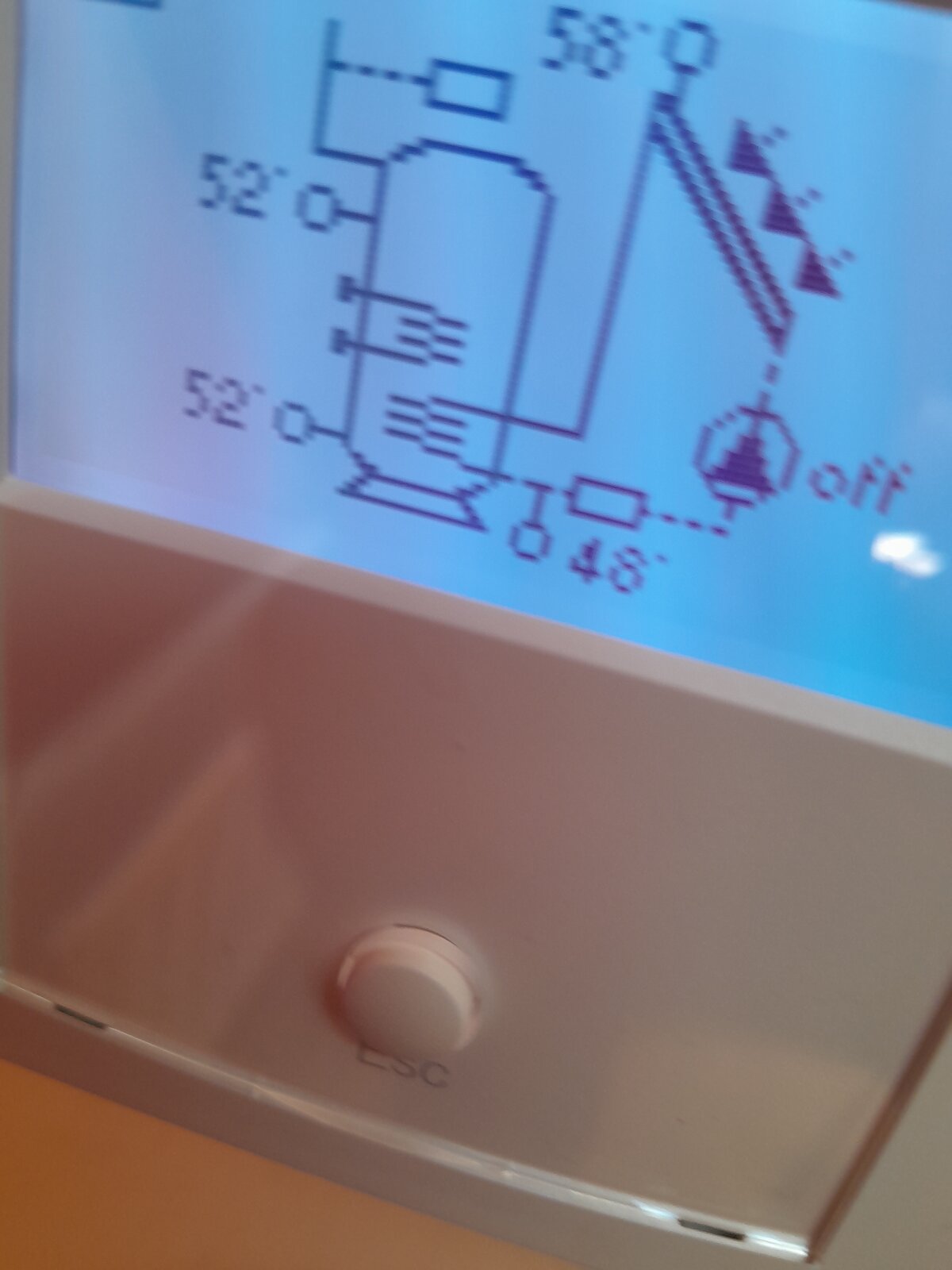

Here are are a few screenshots from my system today, the first was taken at 0743hrs after a shower, the store temperature (44C) probe is installed just above the solar coil which heats between 50L and 140L depending on whether the oil fired coil which heats 90L is in service or not, it hasn't been. There would have been some small HW usage up to 1257hrs where the solar coil has now heated all the water up to 52C and is now beginning to heat the whole cylinder, there was little or no usage until 65C was reached at 1532hrs. The two other temperatures are the solar panel and the return from the cylinder coil which are used to calculate the solar output which was ~ 0.97kWh/hr between 1257hrs and 1357hrs and ~ 0.72kWh/hr between 1357hrs and 1532hrs, it was getting slightly cloudy during that hour and 35minutes.
