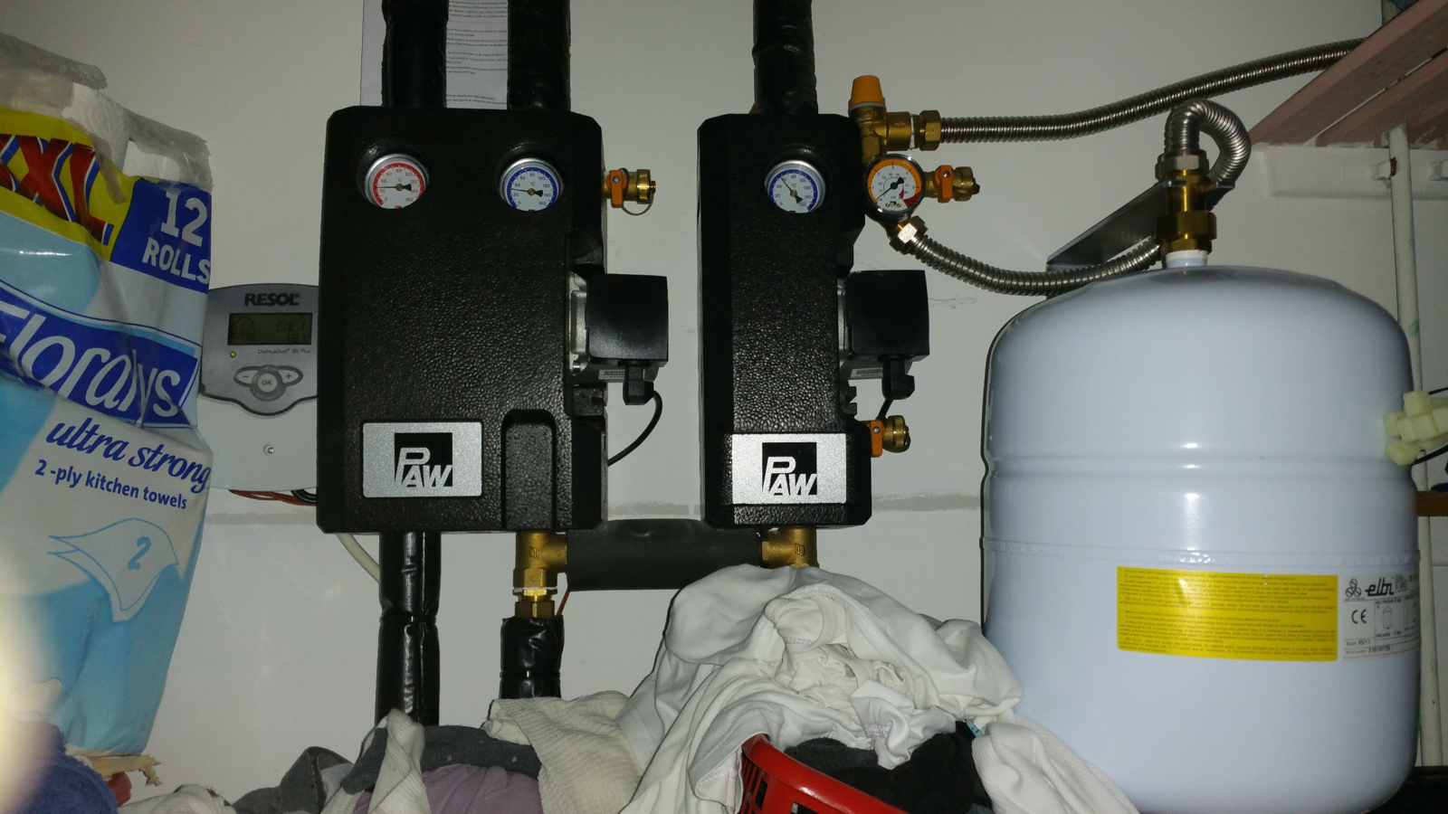

Found pictures of hot water system. The pumps on the right are activated when the water is warmer than the tank, it was useless, I tried to fix it, I assumed it had worked, but the power to it was labelled immersion heater, and my father-in-law had turned it off, as he did not any longer have an immersion heater. So we assumed it had overheated as a result, so got the specialist in to recharge the system, and it still did not work.
To be frank, I look at my PV panels, which can produce 6 kW, and the panels on this system, and if area of roof covered is an indication then at best the panels were 500 watt. Likely a lot less, so producing even if working A1, not enough to maintain the DHW never mind heat it up, since to do it the immersion was removed, the only way to top up was to run the gas central heating, and that is what had been done until smart meter fitted, and the pilot flame went out.
It was only then we realised it was the gas central heating keeping the DHW hot, the solar panels were doing nothing. It never did work as far as I can make out, it was a con sold to an old age pensioner who did not realise what was going on. But it did raise the energy rating band, even when it did not work. Must admit it looks the part, pity it did not work, new owners ripped it out to gain more room in the house.

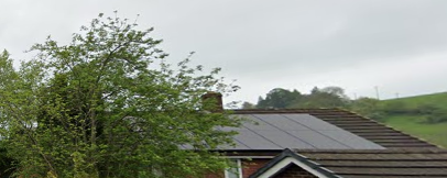

Picture of roof from Google Maps,
and view of one of the panels, there is a matching one front of house. A very small area compared with my house, 1753785003648.png which is far bigger to start with, and with 14 panels (6 kW) it does make a real difference.
It's a sound enough principle, provided that the water coming from the panels got hot enough for long enough to provide useful heating of the DHW. Hence, if it was 'useless' the,n either those conditions were not satisfied or else, as you suggest, the system was 'broken' in some way.
To my mind, it is down to loses, with even a very small PV panel, any energy produced will heat the water, but with a direct water system one has to ensure the hot coil in the bottom of the cylinder is actually warming not cooling the water, so those two pumps must only be energised when there is heat to transfer.
Sure, and since 'heat rises', one obviously needs a pump. In addition, and for the same reason, unless the pump (when not energised) provides adequate 'isolation' (I doubt that it does) then there would also have to be be valves, to prevent 'heated water rising' from the cylinder to be 'cooled' in the panel (when cylinder temp was greater than panel temp)

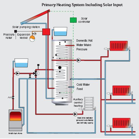

In this basic diagram, the hot coil for the solar is at the bottom of the cylinder, so little chance of it cooling the cylinder, in practice, a system like this would likely have twin tanks, and they are rather large, so require a re-enforced floor to what is normally found, even with twin 100 gallon tanks, the heat (energy) retained in the tanks will not last that long, as with my PV solar and batteries, the storage relies on some heat at regular intervals, without the solar my battery would not last the day, and without off-peak they would not last the night, but a system as shown allows the fire to be lit with one charge of fuel, and keep the home warm all day.

In this basic diagram, the hot coil for the solar is at the bottom of the cylinder, so little chance of it cooling the cylinder ...
I'm not so sure about that. When a hot water cylinder is 'up to temperature', the water at the bottom of it can be pretty hot, certainly hotter than the water in a solar panel on a cold day!
My cylinder had a 9-inch immersion heater when we moved in. It did not heat very far down the tank, and has now been replaced with a 27-inch version, as the hot water was not lasting day to day. There is the Willis system which will heat the whole cylinder, but in the main stratification is reasonably well-defined, and heat does not go far below the immersion or hot coil.

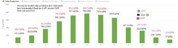

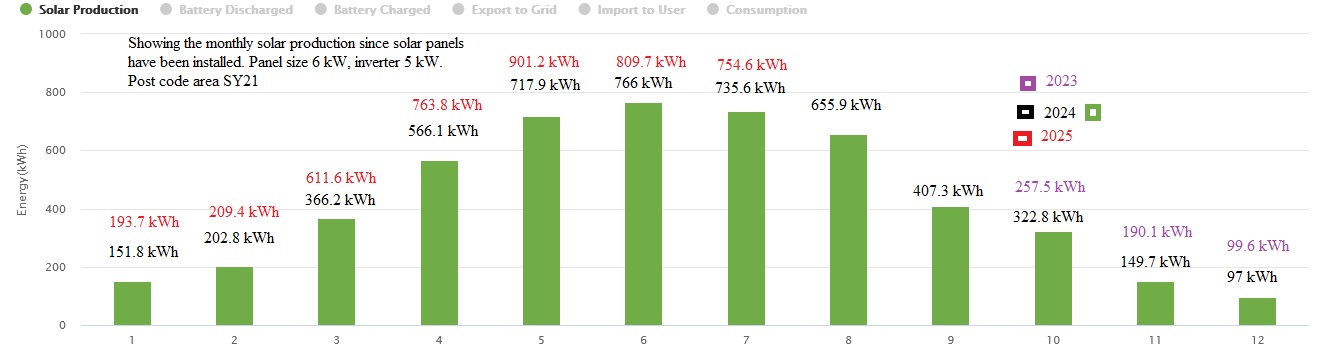

I have not had solar for 2 years yet, but I can see the production Solar production.jpgand I am very pleased with the results. However, December one is not producing much solar, and the gains are mainly due to the battery, and using off-peak for a good proportion of the day. My software will only go back a couple of months to show use through the day, but I use around 12 kWh per day, so 19 hours (5 are at off-peak) and only 5.76 kWh of usable battery (10% reserved for power cuts) plus 3 kWh from solar average, so around 3 kWh short so paying peak rate for that. But the point is 6 kW solar panels are only producing 3 kWh average per day in December, so the output of direct water panels, is likely not going to exceed losses, so one is only going to get any useful output for 6 months at best.
My cylinder had a 9-inch immersion heater when we moved in. It did not heat very far down the tank ...
I think that people have a fair bit too much faith//belief in the temperature differences in a DHW cylinder. There is conduction, as well as convection, going on - and that (including conduction through the copper of the cylinder),unlike convention,goes 'down' about as easily as it goes 'up'.
I think that illustrates one of the things that confuses people. 'Hot water not lasting a day' does not necessarily mean that the water lower down in the cylinder was never hot. Even if (by whatever process) you started with the cylinder totally filled with 'up to temp' water, as soon as HW was used, cold would be drawn into the cylinder to replace it, and that would cool the water in the cylinder.
