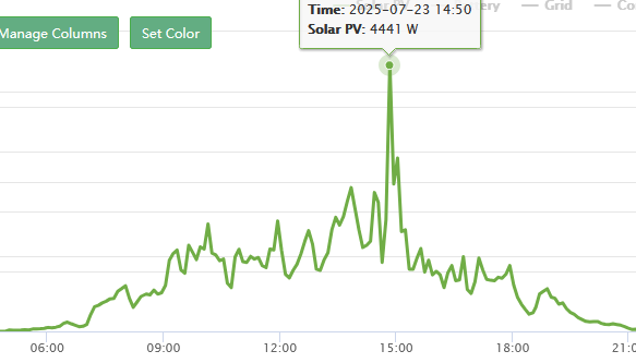

Solar panels don't work like that. If you look at yesterday, for example 1753354471906.png the solar exceeded 3 kW for a very short time, and I have panels rated at 6 kW, so the likes of the iboost+ have a CT coil that monitors how much is being supplied to the grid, and it controls how much power goes into the water to match how much is being generated, so it may be only using 200 watt to heat the water at times, it does not need the export to hit 3 kW before is switches on.

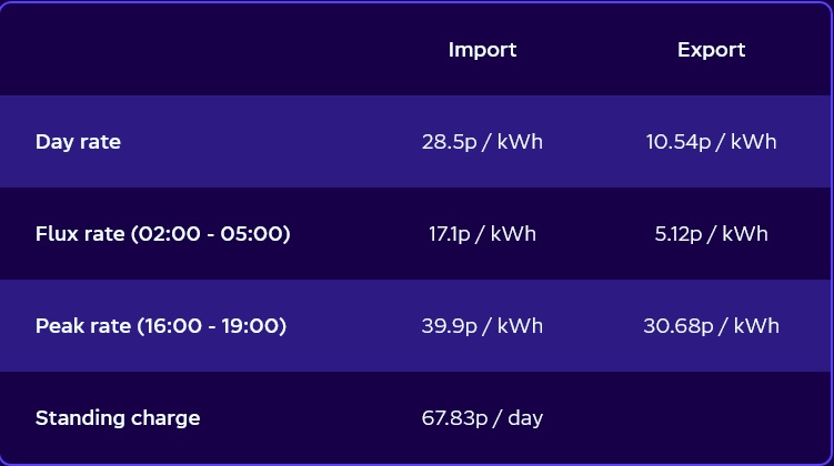

Some tariffs there still is a slight gain using solar rather than off-peak, but it would also depend on time of the day, Oct Flux end April.jpg the rates shown here can't be programmed into my iboost+ but there are some other makes, which can be programmed, but at these prices
one has to ask if it is worth it? The EDDi does seem to be a better unit, however some bits do not come as standard with it, the iboost+ comes with a wireless CT coil, it is extra with the EDDi.
If my iboost+ were to fail, I would not replace it, but would use a simple time switch instead. However, unless you have a smart meter, you can't have a split tariff, only those who had Economy 7 before the smart meter came out, can continue to have a time clock to change rates, and to be frank the Economy 7 and Economy 10 rates were not that good, it seems if you have enough money to buy an EV car you can have some very good rates, but if you're stuck with the old storage heaters, tough, they already have you're custom, you can pay extra for your power.

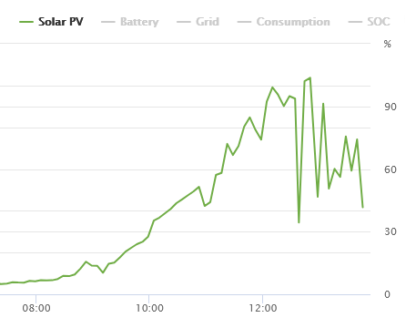

The hot water cylinder is inside the house, only the panels are on the roof, but with direct water, can't see how it can switch the flow on/off fast enough not to cool water already heated, my PV solar 1753447764000.png is up/down like a yo-yo, also the area is quite large, 14 panels, total 6 kW, my father-in-law had two, water solar panels, either side of the roof, so at best likely to produce 600 watt, and that for rather a short time. I use 14 kWh per week on DHW, so it will need 2 kWh per day, so need an output of around 300 watt for 8 hours, and that seems unlikely.
Typical I get around 15 kWh from 14 solar panels, so the panels were simply not big enough for them to heat the domestic hot water, the hope is the solar takes the chill off the water, and something else finishes off the job. So if you're lucky you may get 7 kWh per week from solar, I pay 8.5p/kWh for off-peak, so 60p per week from solar it would take rather a long time to get pay back with water system.

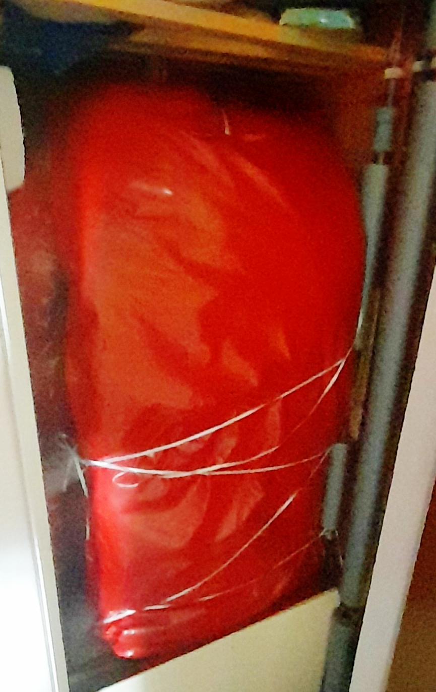

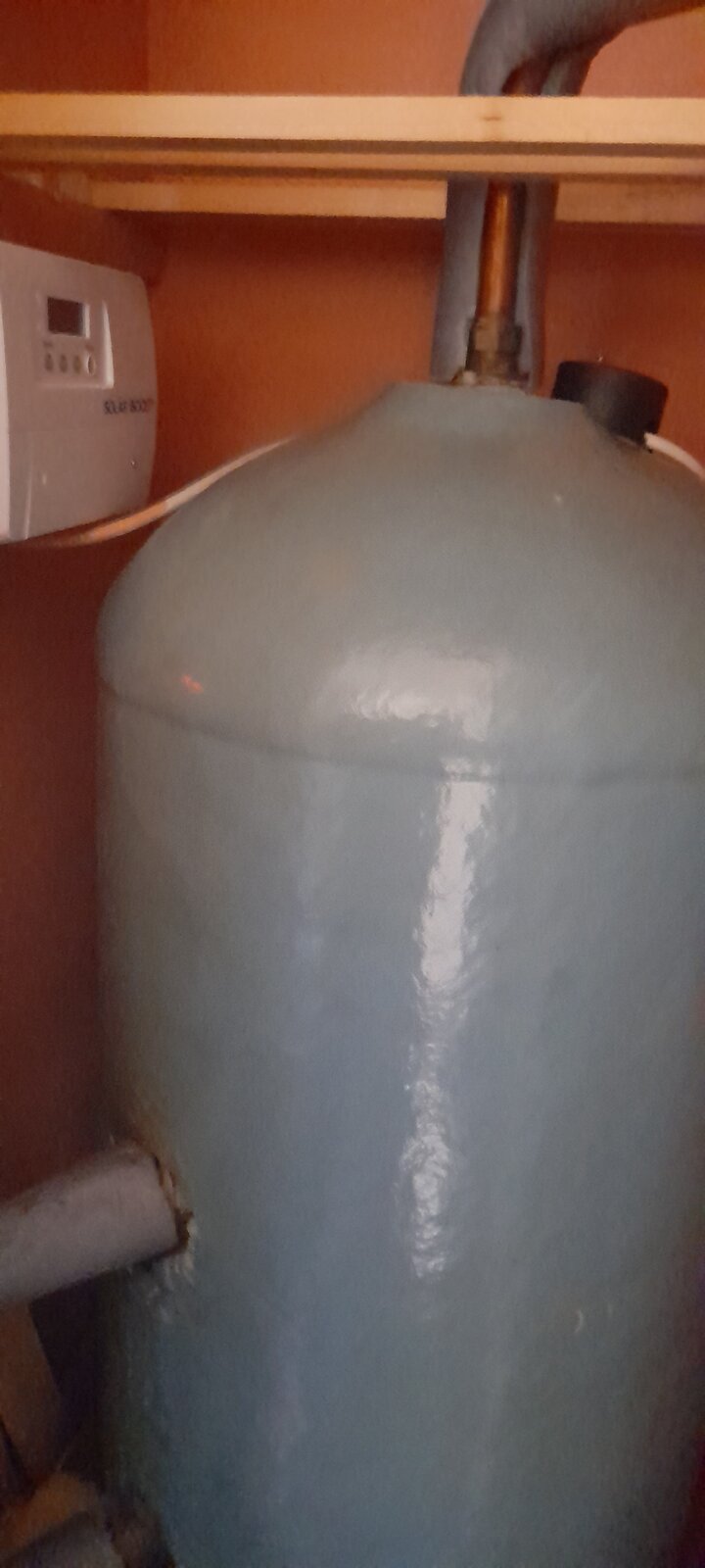

It is hard to work out how much energy is used to maintain the cylinder temperature, and how much is used, it would need a weeks holiday to see how much used to maintain the cylinder, and with a 9" immersion heater I was using around 5 kWh per week, and with a 27" around 15 kWh per week, but whole reason for changing was I found I was running out of hot water, I tried extra insulation, and all it did was reduce it by 3 kWh per week, still using 12 kWh per week.
Only 2 of us, and we only use the bath to store my wife's e-bike in, and showers are instant electric, so around 2 kWh required to maintain DHW and as you add more area to gain heat, you also add more to lose heat, so it is unlikely to work in the North of this country.

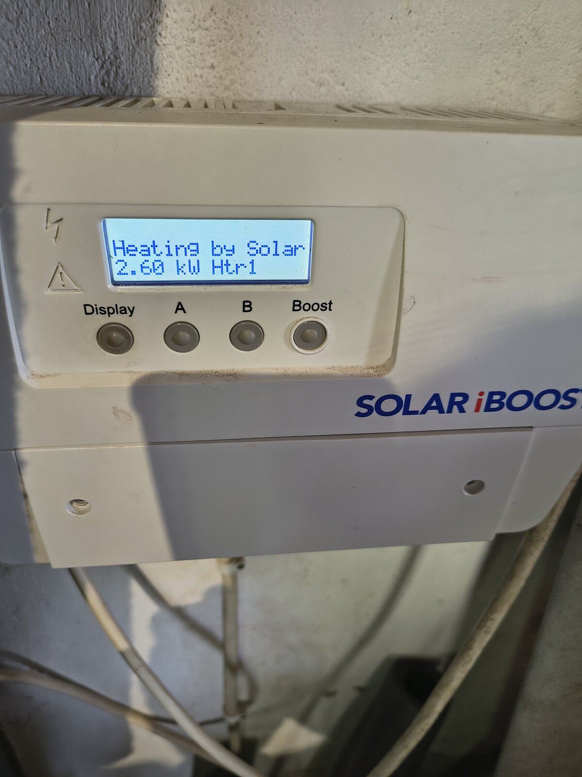

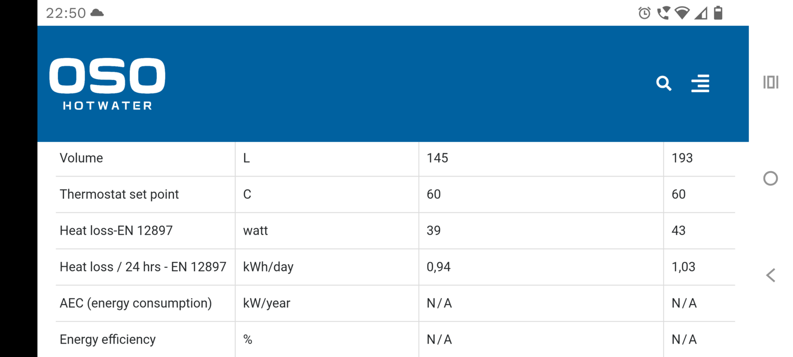

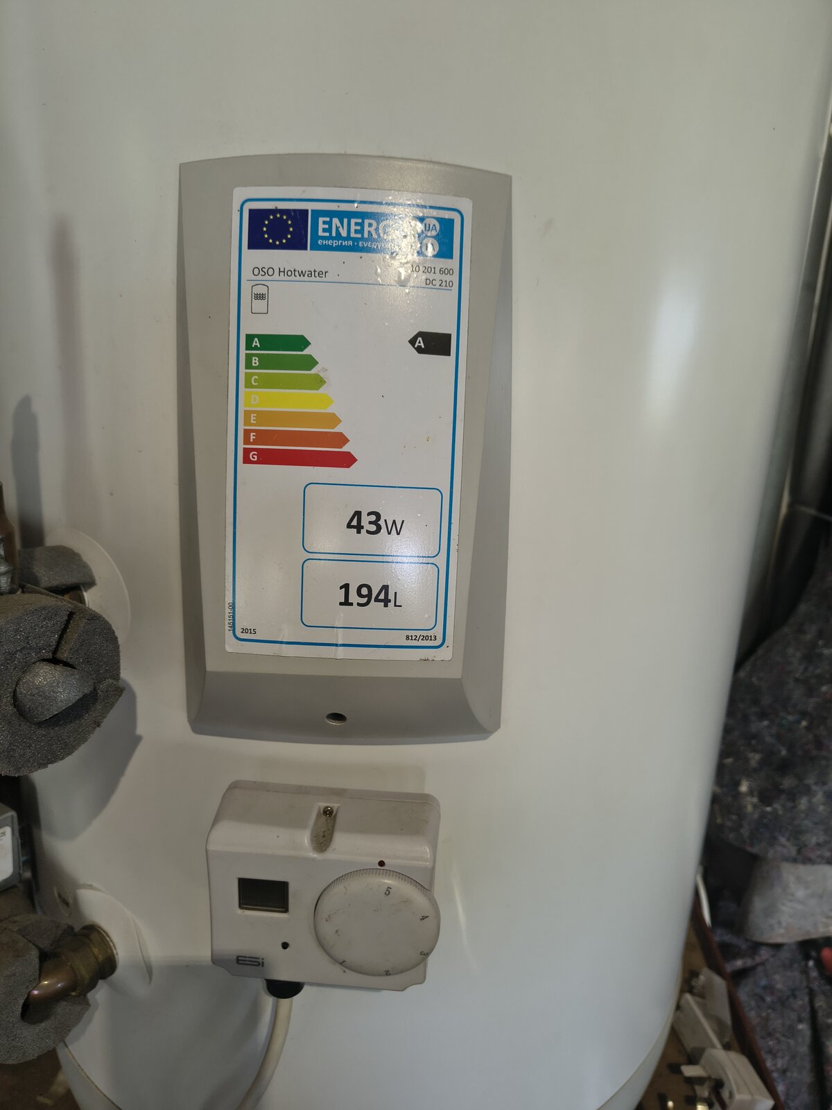

I have a 200L UV cylinder with a heat loss of 43watts. It take around 5kw to cover our daily usage and maintain tank temperature, just now it was putting 2.6kw into the tank which would otherwise be exported
I have solar panels ,I must admit abroad .Today I am making 4.9KW house is using 1,54 KW rest is going back to grid, If I turn on my emersion house is using 3.35KW rest is going back to grid
So still heating water for free
No, the heat loss is 43 watts. Also known as 43 joules per second.
In one day or 24 hours, the total energy loss is stated there as 1.03kWh, as 43 watts x 24 hours is 1032 watt hours, or 1.032 kWh.

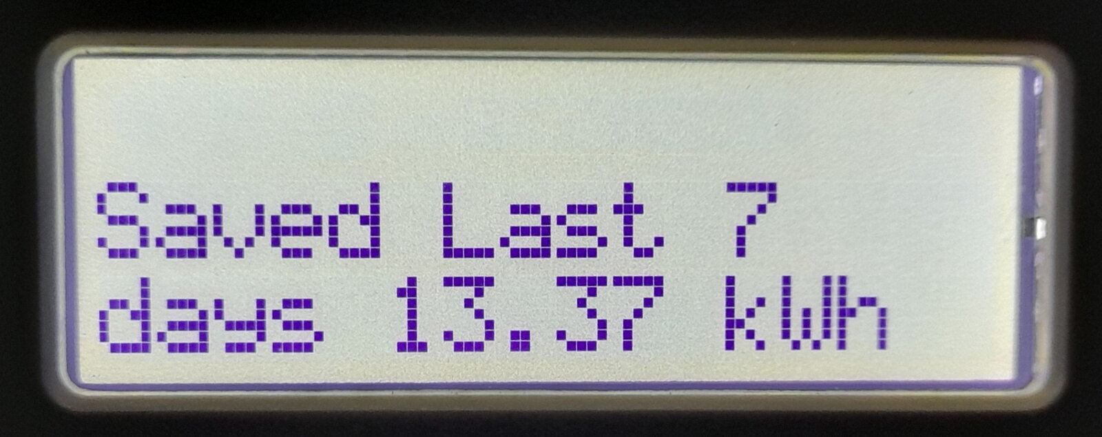

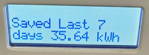

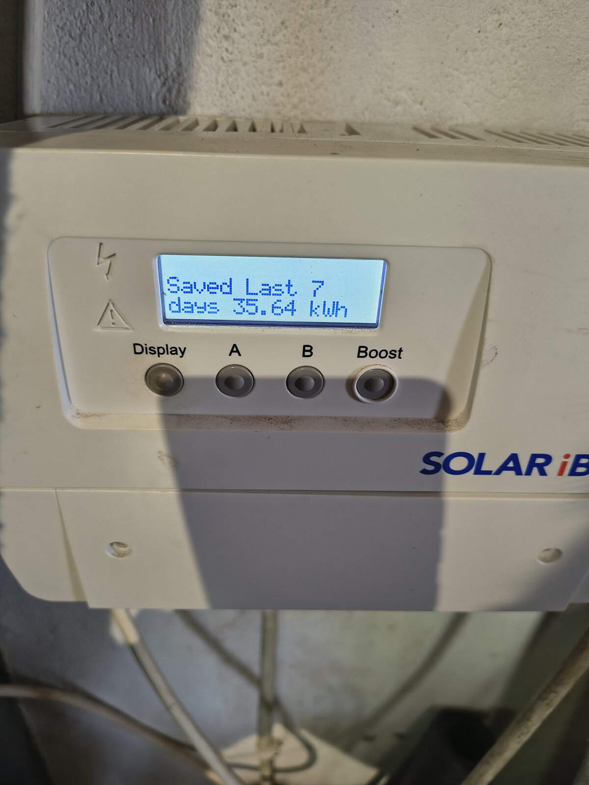

My mistake, should have known better, wrap on the knurls for me. So 43 watts for 7 days, as that is what has been read from the iboost+ = 7.224 kWh so since 35.64 recorded, it would seem 28.416 kWh actually used as hot water.
Back to original question, with that tank, you need a kWh to maintain DHW at some undisclosed temperature over 24 hours, I would assume 65ºC as want to ensure no legionnaires which are killed at 60ºC I believe, this was the problem with my DHW heated with oil, there was no tank thermostat, so we used just time, we found that 4 burns at ½ hour per burn per week kept the water warm enough to wash hands, but no idea how hot the tank was, and if we could get legionnaires incubating in the tank.
