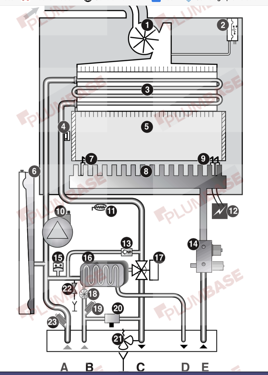

proud owner of a saunier duval f24e therma classic ;-). That does not want to work with the central heating but the hot water is fine after it was refilled. [heating system was drained for decorating]
(advice for these boilers is to replace - and I could not agree more - but we have already moved and are selling the apartment on - the new owners can get grants here to upgrade to a more "modern" heating system )
The central heating flow pipe only gets warm a few cm's below the boiler. Never too hot to hold.
Could it have been messed up during the refilling - if the radiator return or flow valves were closed when the boiler was switched on?
The diverter valve replaced about 5yrs ago when the valve body split. Genuine parts - used.
Parts diag - https://www.sparesbase.co.uk/saunier-themaclassic-f24e-10000877-3549855/explodedviews
This is whats been done so far :
Diverter solenoid - certainly looks ok, changing positions when going from hotwater to central heating.
I think it defaults to hotwater, and extends the actuator when on central heating. But would need to check.
Diverter valve - can actuate this manually (bit tricky to do so for any length of time!!!)
And still no joy, the heating flow pipe remains cold (just the usual first few cm only get quite warm )
Changed the diverter valve cartridge - thankfully came with a diagram. So I did not have to worry about the extra part not being used - looks like a blanking cap? However this did not fix things.
When the system is pressurised and the solenoid removed, the brass pin of the diverter valve will gently extend outwards about a cm or more. Is that normal? It was like that with the old and the new cartridge. Easy to press back in, until the force of the spring is felt, then it is quite hard to press with fingers bent inside the boiler.
Checked the heating circuit filter - looked in good condition. Washed and re-installed.
Removed the bypass valve cleaned and re-installed - all looks ok.
At a bit of a loss what to do next.

turns out you were correct - sort of. It made me check a few things and turns out all of the return valves on each radiator was closed. The rads had been removed for decorating 6 months or more back and this detail was forgotten.
With no other bypass valve out there, no return path for any of the hot water - bypass valve within the boiler was working overtime.
Thanks everyone for helping the process along. Embarrassed and very relieved.
