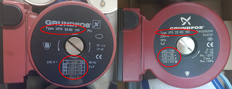

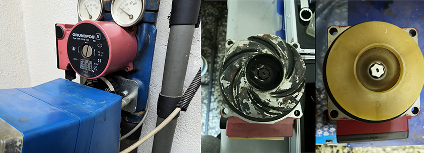

In my heating system, I have a UPS32-80 attached to a very specific TEKMAR cast iron block. The pump makes a deafening noise so I bought a new UPS32-80 to replace it.
Unfortunately, the new UPS32-80 has a plastic impeller whose water inlet has a larger diameter which prevents the new pump from fitting into the cast block.
My idea is to change the impeller from the old (metallic) pump to the new one but I have no idea how to remove both impellers without damaging the pumps.
Does anyone know how it can be done? Does it require a special tool?
Thanks for your time and attention.
I think you could try to undo the nut in the middle but you’ll have to use the old impeller as they are different sizes. It is usually the bearing gone which makes the noise. Bob
Those two pump heads look a different size
The two pumps are dimensionally and electrically identical. The only differences are, the old one was manufactured in 1995 and the new one in 2015 and, internally, the water inlet (center of the impeller) is wider in the new one, probably to strengthen the plastic impeller since, in the old one it is made of sheet metal.

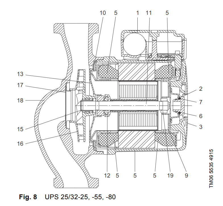

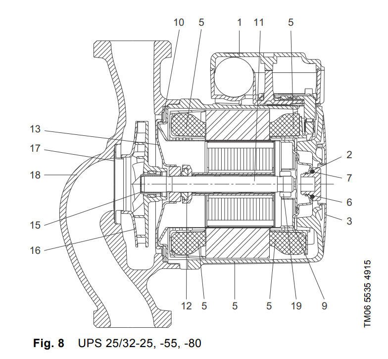

By bleeding it you take the load of the shaft bearing hence the change in tone.
Hi, JimCrow,
In the figure that you have sent me, which are the bearings?. It occurs to me that if the bearings are in the stator, perhaps by placing the "old" rotor (with its shaft and immovable impeller) in the new stator, the problem may be solved.
Any suggestions?

Really need the next page to put parts to numbers.
Should be a case of removing the nut in the middle, ideally you should have an impeller puller, so you can jack the impeller off the shaft, it is highly possible the old impeller will break as it's likely to be pretty siezed on the shaft.
The "new" pump is 13 years old, I would have reservations as to the condition of the bearings having been sat in the same position for that time.
