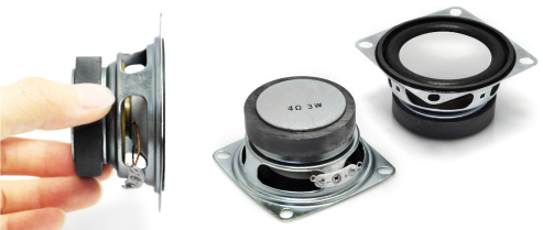

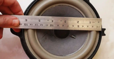

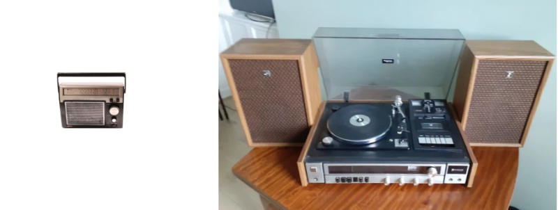

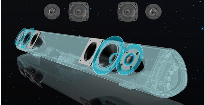

Hmm.... built-in subwoofers. There's a can of worms. :LOL: :LOL: :LOL:
Just as the portable transistor radio never sounded as rich in tone as the bigger speakers of a home stereo,
then it should stand to reason that a sound bar which might only be a couple of inches tall and maybe 3" deep is going to be limited on the size of the bass speaker drivers it can accommodate.
Typically, they are 2", 2.5" or 3" in diameter.
Contrast that with a sound bar with a separate subwoofer,
housing 5.5"~6" bass driver
and it shouldn't be too difficult to guess which will produce a richer tone.
Naturally though not everyone can find space for the sub, and that's fine so long as the expectations are adjusted accordingly.
There are some tricks that are commonly used to help bolster the bass output from smaller drivers. Bass porting is now pretty-much universally employed. It can't make the sound significantly deeper than the driver size can manage on its own. But it can add a little more power to the sound and at a frequency just below where the bass from these small drivers would normally tail off.

Tiny speakers seem to have come on in leaps and bounds since those days. The speakers in my LG sets, are much smaller than you would ever find in an early, small transistor radio - yet they are able to really blast out the sound, and not too bad on the base notes.

Lucid, you amaze me with your patience in explaining things (all the typing, and the added graphics!), also in doing the searching for me. All I could reasonable expect, now, is for you to order the two items and pay for them for me! However, since that seems a bit too much to ask, even of you, I shall do as you say, following the links you give. I mean, it would be foolish not to do that, and still soldier on, expecting to find something better and that fits all my demands. All that you tell me is a tremendous relief. I'm very grateful — really!

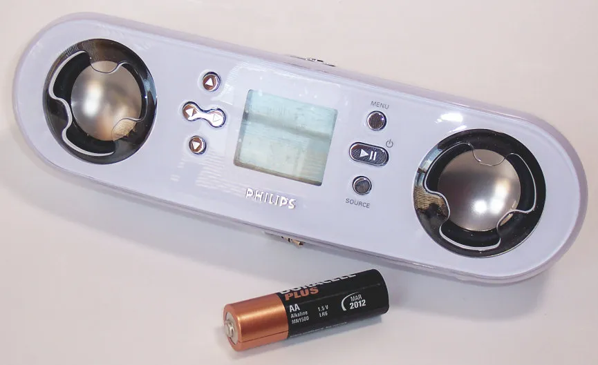

That's true. They have. I remember hearing the Philips Shoqbox PSS110 twenty-odd years ago when I worked for Philips.
I was impressed by what these little 1"~1.5" could do. Some of it was bass porting. Some was down to making the drivers have a bigger excursion (Xmax). Creating sound is about moving air. If you can't make the piston a bigger diameter then the alternative is to increase the stroke. Then there was the change to Class D amps; smaller and more power efficient than a conventional transformer design.
What was also involved was something called psychoacoustics. (Yes, that's really a thing.)
We're sort of familiar with the idea that MP3 reduces file space by throwing away what the algorithm thinks will be less noticeable parts of some bit of digitised music. Psychoacoustics works on a similar principle but for sound as it's playing. The human brain is remarkable at filling in gaps in information. Here we have an abstract drawing. It's just a few lines on your screen, but your mind makes something familiar from it.
The speaker in an old transistor radio was a simpler device, and it wasn't encased in a way that would assist the efficiency or boost the output. The transistor amps weren't as efficient, so they'd run into distortion quite a lot earlier than modern gear. There were none of the tricks used by digital signal processing.
All of that said, there's still a limit to what can be done with small speaker drivers.
