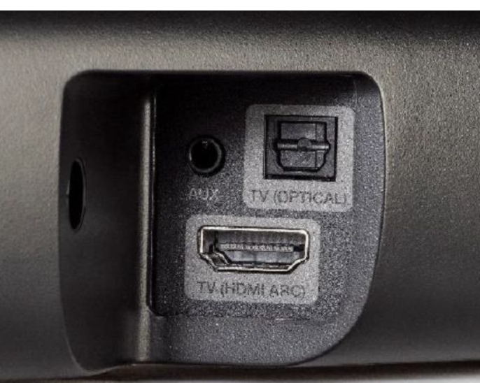

You're correct to be circumspect. Take nothing for granted. It is possible though to buy some sound bars that will cover both bases; optical that you need right now and HDMI ARC that you're very likely to need in the future.
This is the rear connections of the Denon DHT-S416 at £249. It isn't the only sound bar with such a feature. I just happen to know that it has both sockets.
Something else to consider is how you'll control the sound. It might seem odd to bring this up, but I'll explain. If you're new to external audio systems then you might expect that the optical sound level will vary when the TV volume buttons are used. That would be a perfectly reasonable assumption. However, optical stays at a fixed level. It's the sound bar speaker itself which changes volume and not the optical signal level. This is why all sound bars come with a remote control.
You've been using your Samsung TV for 17 years, so you're used to picking up the TV remote to change the sound level. That's also probably what you did with the previous TV too. The habit is well ingrained. Changing what you do so you remember to pick up the sound bar remote would come to after a while, but there would be plenty of times when you'd end up putting the TV speakers on at the same time as the sound bar. That's not ideal. It would sound slightly strange.
It would be handy then if there was a way to make the sound bar respond to the TV remote for volume. That's exactly what this Denon and a few other sound bars can do. They will learn the volume up, down, and mute of the TV remote and respond to that. I do have to point out though that the TV needs to stay mute. The same infrared commands that control the sound bar will also change the TV speaker level unless the TV can somehow ignore them. Samsung does have this 'ignore' feature in some of its older sets. It's called 'Internal Mute'. It's an option in the TV sound menus. [Menu, then tab down to the speaker symbol, and once in that sub menu you might see Internal Mute. The selection is Off/On. The default setting is Off.] You can try this without any external audio system hooked up. Switching the Internal Mute to On simply turns the TV speakers off.
When it comes time for a new TV you will use the HDMI connector. There's a feature in HDMI which takes care of this TV-controls-the-sound-bar thing. It will even switch the sound bar on and off with the TV.

You're correct to be circumspect. Take nothing for granted. It is possible though to buy some sound bars that will cover both bases; optical that you need right now and HDMI ARC that you're very likely to need in the future. View attachment 308854

The information you have on HDMI is incomplete. When the socket is marked ARC on both devices then it provides a link from a TV to a sound bar for audio. That's exactly what you need.
Regarding sound bars, and most consumer electronics, there's generally a specifications list that details the features. Optical, normal HDMI, and HDMI ARC will be listed if they're featured. You can also check directly on a manufacturer's Web site if you're unsure whether a retailer has transcribed it correctly.
