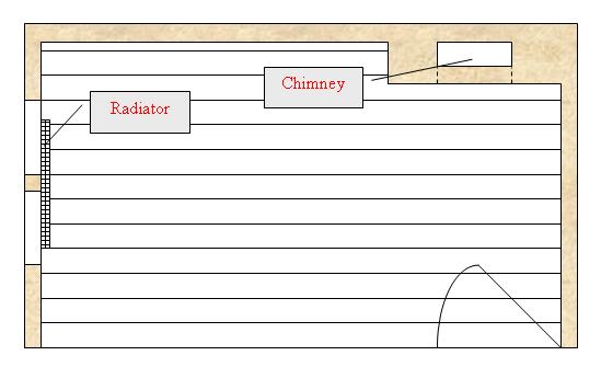

The bedroom is laid out roughly like this (approx 3.5m x 4.5m, with a pointless, draught inducing chimney that just goes up to the loft space and will need blocking off):

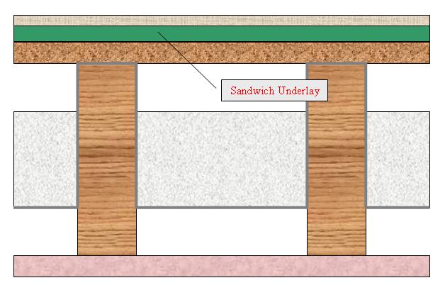

After sorting the floor, I'm hoping to resolve the damp and cold issue with this approach:

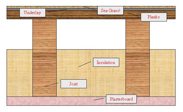

However, first of all is sorting out the floor itself. Currently (and without investigating too far beneath the floorboards), the floor looks to be made up of the following:
Insulation looks to be very old yellow fluffy stuff. Hate to think what kind of now banned substances it's made of! Doubt it's doing a job at all. On top of the joists are planks. From what I've seen, they don't look too great, plenty of gaps, etc.
You can see from the image above that the joists appear to go along the length of the bedroom, which does seem a bit daft. As a consequence, there is a bit of sag in the middle. We're not looking to rectify this as it'd mean ripping it out and starting again. It's bearable and too major an undertaking to deal with.
As the primary reason for our sorting the floor is to minimise airborne noise, we've looked at the following options to improve on what is there:
1. Insulation, Chipboard, 2mm Acoustic Matting, Medium Acoustic Underlay & New Carpet
We've already got a load of Rockwool insulation to put between the joists and for building regs we think we need to suspend it using chicken wire for fire purposes. The chipboard should help fill in most of the gaps that the current planks will have, plus we'll probably fill with acoustic mastic. A single layer of acoustic matting should help capture a lot of the sound, plus isolate acoustically the room from the chipboard. The underlay has medium acoustic performance (probably rubber crumb stuff, but a good 1cm thick) and should help with both airborne and impact noise transmission. The carpet will be decent carpet and we'll probably get someone to fit this over the rest that we'll be doing.

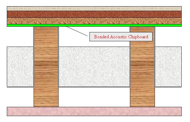

2. As Option 1, But With Joist Caps
I like the idea of separating acoustically the chipboard from the joists as far as possible to minimise the transmission of sound from the room below up to the chipboard. Not sure if this is practical or whether it will achieve anything, but if it's possible to decouple the downstairs ceiling from the upstairs floor, is this worth investing in? If so, how would I fix the chipboard to the joists, or would I not bother, so it just floats?
3. Insulation, Chipboard With Impregnated Acoustic Layer, Medium Acoustic Underlay & New Carpet
Similar to 2. except that the decoupling job of the joist caps has been replaced by the impregnated layer of rubbery stuff on the chipboard. Also this would do the job of the acoustic matting. Maybe won't save money, but should be simpler to install.
