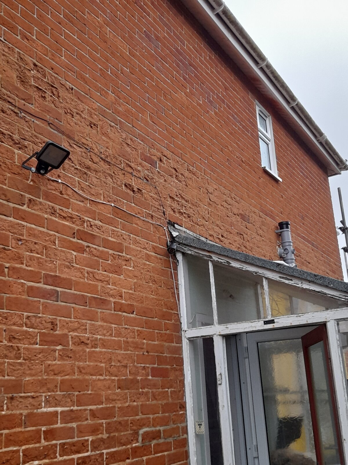

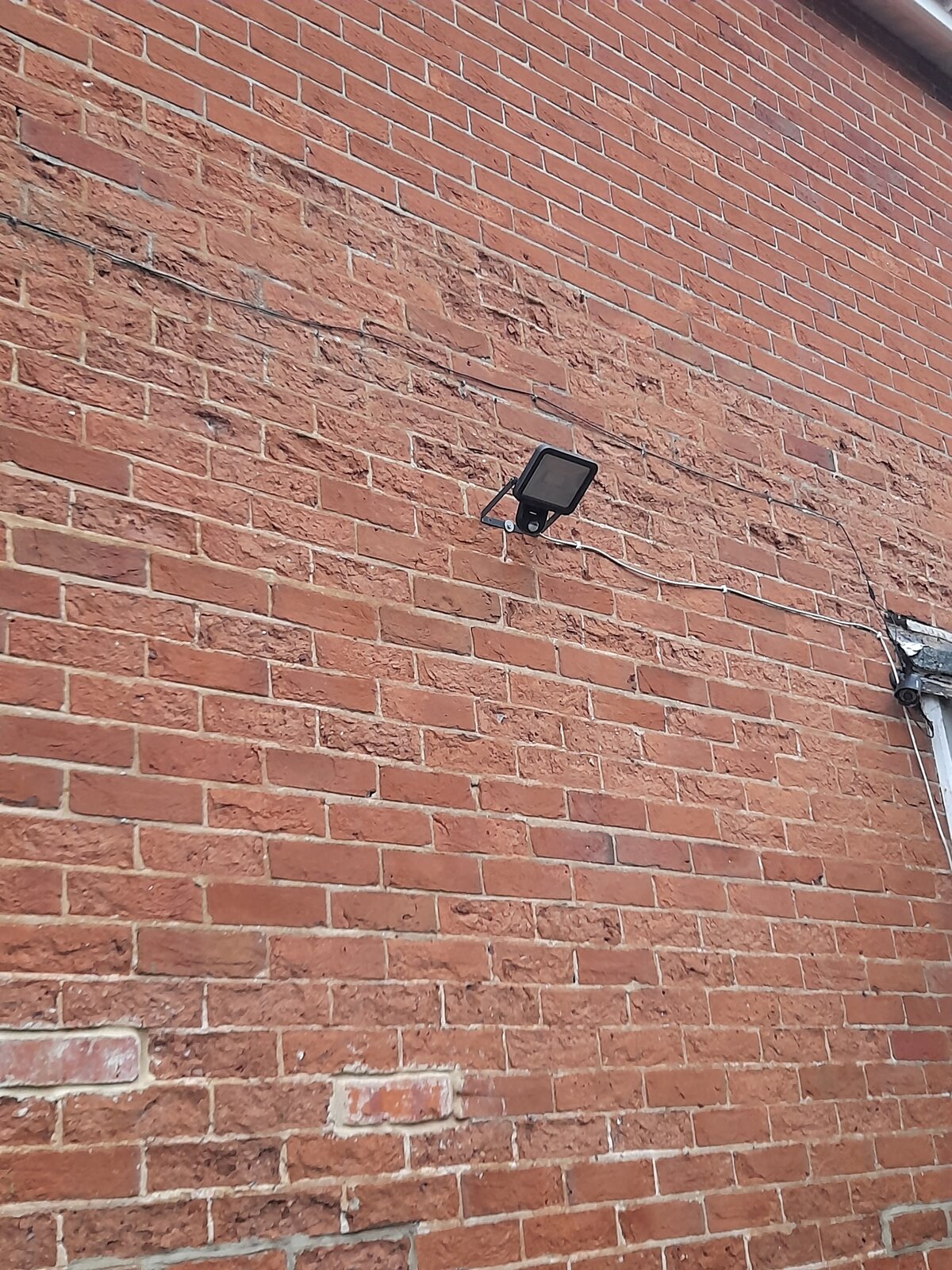

I've been in the house for 7 years, a victorian 1901 with cavity. We installed central heating have brown spotty walls upstairs. Have injected chemicals downstairs with chemicals. Around 7 courses spalled bricks above damp course down length of house. Walls are always cold.
Humidity in house 58-70% if dehumidifier not running. I do all the standard, no furniture next to wall, dehumidifier crack a window etc
I always get differing opinions, ask for quotes to repoint and they just want to render. Builders are happy to clad or render. I read it can cause damp issues and I would just like this better/ solved and not waste more money. Any suggestions?

Strange location for spalling.
It looks like a cavity wall
Is water getting in from the roof or gutter?

Why is the soil pipe so strange?
Stand back and take some wider pics, roof to ground. Include all plumbing and downpipes, airbricks, and nearby drains, gullies and manholes please.
Can you see the original dpc? How far above today's ground level is it?

Soil pipe is to my newly installed upstairs bathroom. Spots happened prior to bathroom installation. Just prior to bathroom all drains surveyed and lined as a roots had gone into pipe. New manhole when new soil pipe added.
Will add photos tomorrow.
