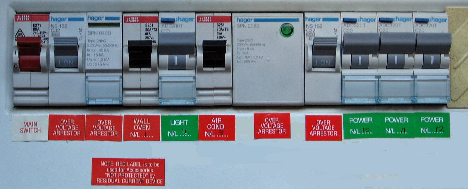

The following installation (for a Two Bedroom Australian house)
has two "Over Voltage Arrestors" - of different "capacities" -
along with the RCBOs and MCBs.
(RCBOs would now be required in a "new" installation for the Wall Oven and Air Conditioner circuits.)
Type 1 main board
Type 2 sub boards
Type 3 close to sensitive equipment.

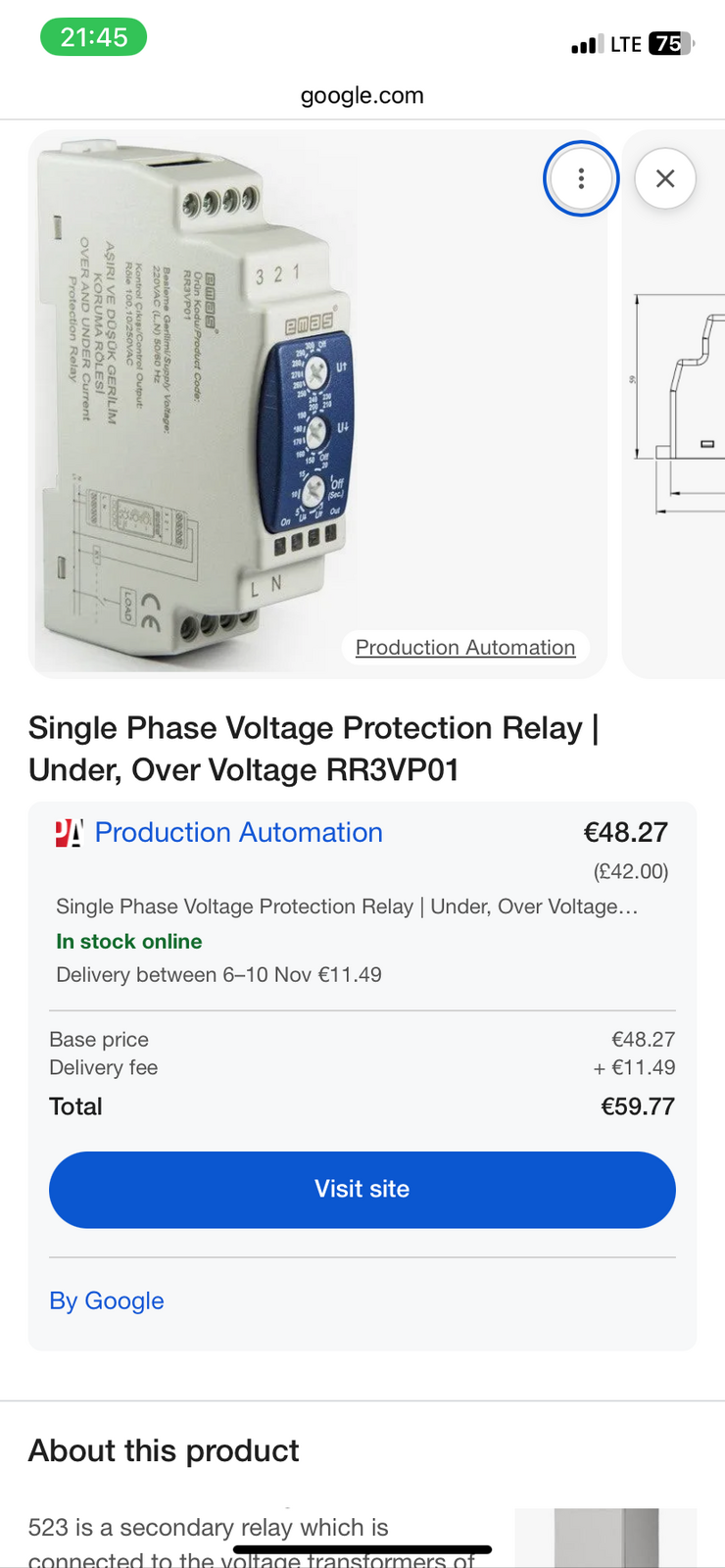

Most/all delicate electronics, are fed via SMPSU's with a very wide range of acceptable input voltages. Of more use, might be some form of over voltage alarm, than an SPD.
Alarm could be too late . I think damage could be done
Got below type for my place not fitted yet
It depends how quickly, it increases. Many years ago, we had our supply go up to 260v, it was obvious from the tungsten lamps, the voltage had gone up. I was able to simply switch things off, to protect them, then ring the DNO. I have nothing like that now, which would respond to slight over voltage, but a 'voltage alarm' might be handy. Nothing would be damaged, by under voltage.
