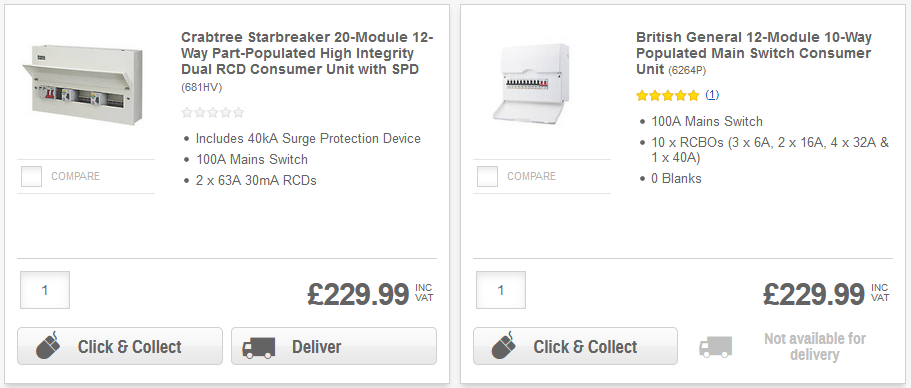

I have lost aerial boosters in the past, it seems likely these protected my video and TV, however not had a fire as a result, but when diodes fail it can result in over heating and fires, so spikes can have a knock on effect.
At around £30 for the fusebox SPD it was not worth taking a chance, if never used or required so what, but at £100 for some makes, then we start to say hang on do we need that?
It is the same with people trying to get away with just two RCD's, we are looking at £70 to £250 for a cheap make of consumer unit like fusebox between just two RCD's and no SPD and all RCBO and SPD, but for a Hager consumer unit likely looking at £500+ with SPD £100 and £35 for each RCBO it soon mounts up.
So screwfix website
two consumer units same price, in fact the most expensive they do, to left two RCD's at only 63A so questionable if it complies unless only a 60 amp DNO fuse, and to right no SPD, so top of range clearly the Crabtree is more expensive really as no MCB's included, a BG SPD is £25 and one module thick so cheap enough to add and Crabtree MCB's £3.50 so add another £35 plus two RCD's well no that does not work, as best Screwfix offer is type AC 80 amp, so it would seem unlikely buying from screwfix the Crabtree could be made to comply. However BG do two RCBO's on screwfix web site both are type AC.
So Screwfix website most expensive consumer units on offer both type AC RCD's so could not be used to supply and electric car charging point, one with under rated RCD's and one without a SPD. Clearly not a trade supplier, but it shows the problems.
