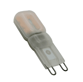

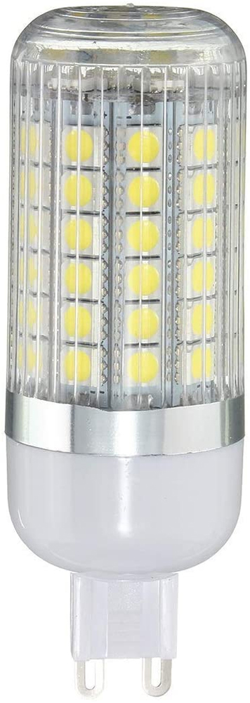

Flameport mentioned LED lamps/bulbs, which is a good example. Cheap, and many not-so-cheap, ones rely on just a capacitor to limit the current through the LED element, and it therefore follows that a high frequency (rapid rise time) transient can result in a high (potentially 'lethal' to the LED) transient current to flow through the LED element, even if the voltage of that transient is low (see **).
To have a more sophisticated means of current limitation would considerably increase cost, and it is (should be) for the consumer to decide whether that cost is worthwhile in order to reduce the (I think extremely small) risk of a 'transient-induced failure'. There must be something approaching a total of around 50 LED lamps/bulbs in the 'commonly used' parts of my house, and I nearly always buy 'the cheapest I can find'. In the days of incandescent bulbs, I was probably, on average, having to replace at least one every week but, with LEDs I probably only have to replace one every 'few months'. Even if the ones I replace had all been killed by transients (which is probably extremely unlikely), I personally would not see that as a reason for installing something to 'protect' them, and certainly not as a reason for buying, say, 50 much more expensive lamps/bulbs.

I did open one LED lamp, wish I had taken pictures, but found why it did not work, dry joint so repaired and went back into service, however it starts with a capacitor to limit current, in series, then a full wave rectifier, then a smoothing capacitor in parallel, so there is no strobe effect and a small leak resistor so stray currents will not cause it to flash when switched off.
Clearly with that current limiter frequency is rather important, but can't see spikes like you show affecting them. I have had one other LED lamp fail, since it replaced a florescent tube and the old ballast could be removed or left in place I would assume a pulse width modulated regulator as clearly it needed a large voltage variation depending is ballast removed or not, and that unit worked one day, then not the next, and I assume the regulator failed, it had another florescent on the same switch, so does seem likely the back EMF on turning off was cause of failure. However the replacement unit then ran until my son who now lives in the house replaced it with GU10 down lights.

The series capacitor was a metal type and the parallel one an electrolytic type, but did not note values. Was rather chuffed when I found the dry joint so soldered it and returned to service. It was this G9 type G9-big.jpg which does not allow the use of the glass cover as it is so big, the electrolytic capacitor was nearly as big as the whole lamp it replaced G9-small.jpg no wonder the old lamp flickered and new one steady as a rock.
That's obviously what one would expect. If the electrolytic was adequate, it should protect the LED element against very brief rapidly-rising 'spikes', even if 'high voltage' (>500V), without the need for an SPD :-)
To remove rapidly-rising 'spikes' a small capacitor should be fitted in parallel with the electrolytic capacitor.
Many electrolytic capacitors are constructed from two metal foil electrodes separated by a very thin moist paper or fabric layer and these are tightly wound into a spiral. This winding is inductive and presents an impedance to high frequency. The insulation between the electrodes is created by a non conducting layer of metal oxide ( or other salt ) on the electrodes
True (I should have referred to the 'parallel'/'smoothing' capacitor, not the 'electrolytic' one), but don't forget that it cannot be all that 'small' - the 'parallel capacitance' has to be quite 'large' (effective capacitance wise) in relation to the series capacitor, since they are effectively acting as a 'potential divider' across the spike voltage.

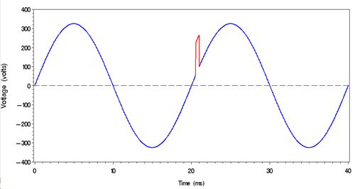

I wonder (i.e. do they 'filter')??
They do not.
They only work for spikes which have a voltage above the normal peak AC, what's shown in the graph would not be affected by an SPD at all.
SPDs are simple devices - they have a very high resistance at normal operating voltages, and a very low resistance above that.
They do not. They only work for spikes which have a voltage above the normal peak AC, what's shown in the graph would not be affected by an SPD at all. SPDs are simple devices - they have a very high resistance at normal operating voltages, and a very low resistance above that.
As you will presumably realise by 'reading between my lines', that was my suspicion.
So that presumably makes them even more 'useless', since they won't protect my cheap LEDs (or anything else) against rapidly rising transients unless they are 'high' voltages?
