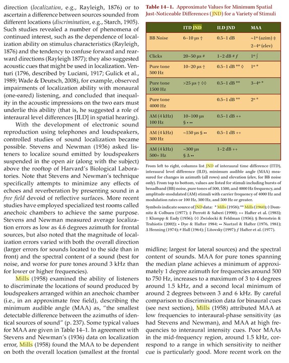

That's not my experience over the last 40 years. What's your evidence?
https://www.steinberg.net/forums/viewtopic.php?t=121659
And this:

The assertion "....3dB difference which is an almost imperceptible volume change to the human ear" was not qualified.
As I recently implied, I think you'll find that the ability of humans to perceive differences between sound intensities reduces considerably at higher intensities - and, indeed probably eventually hits a ceiling ('saturates').
And you said "particularly at high sound intensities", not "but only at high sound intensities".
It was essentially being qualified, since that 3dB related to the 2:1 difference between "x-max" and "x-damage"
Indeed, because I have always been under the impression that around 3dB was the smallest discernible difference at 'ordinary' sound levels (and probably worse than that at high sound levels). However, as I also wrote, I may always have been wrong in that understanding.
