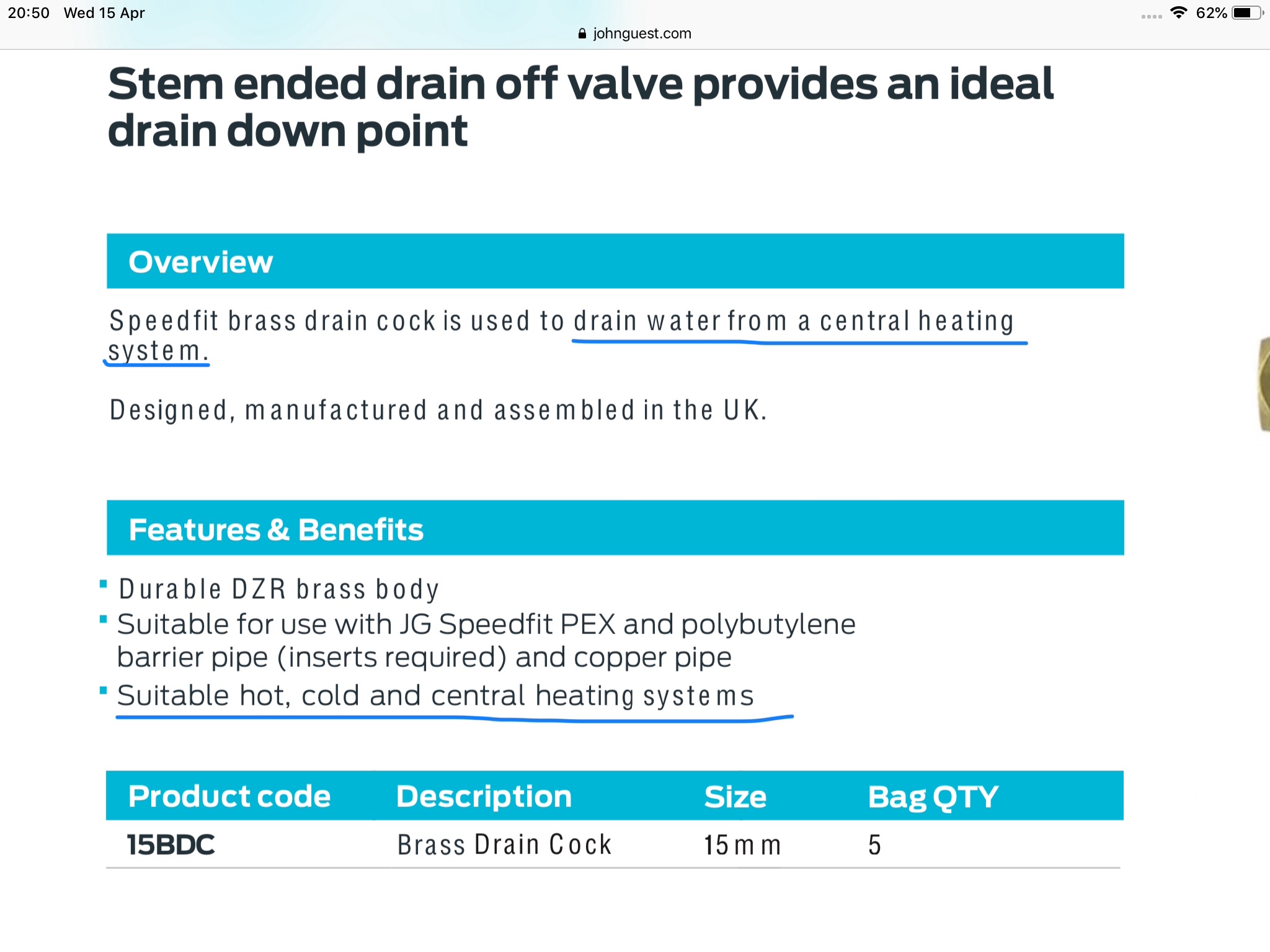

Look at JG's data sheet for the fitting rather than the web page - web pages can be wrong, data sheet normally aren't - It is classed as being suitable for Hot/Cold and CH systems

As suggested though, in the data form from JG - it states it's suitable for hot and cold water as well as CH, therefore I would presume from that it should then comply, though in other blurb is does say it's just for CH. You could be correct where the types of EDPM rubber used isn't WRAS approved but I wouldn't see why they wouldn't bother for such a small fitting.

Me neither, but think thy have dropped a ball with this one. Tbh, I wouldn’t give JG or their parent my money after a recent issue. Note, it doesn’t say potable though
Not, it doesn’t say potable though
It doesn't, no, but the language used on that datasheet, "suitable for hot and cold water and central heating systems", is identical to that used on other Speedfit datasheets that are definitely WRAS approved and suitable for potable water.
