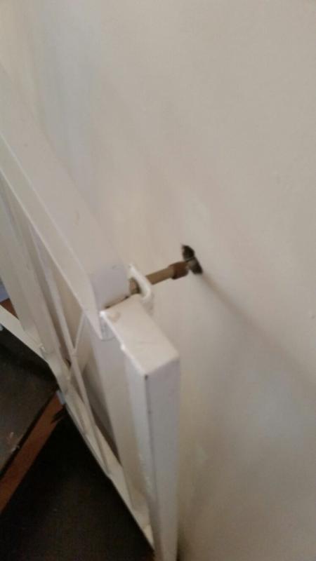

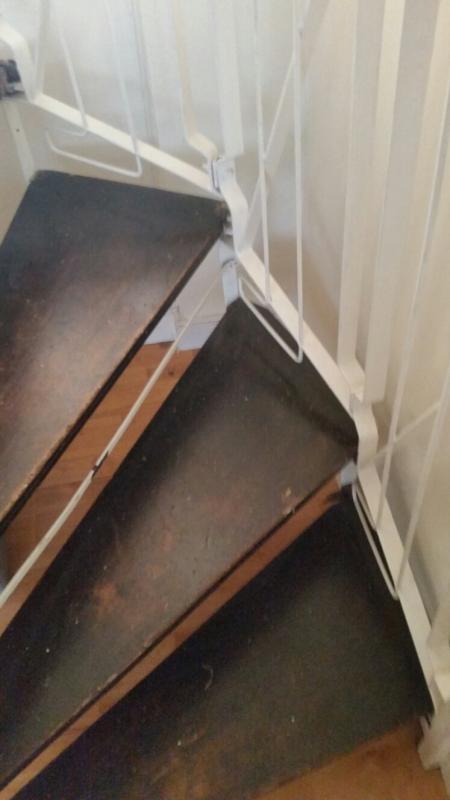

I've already had a builder look at it via the Estate agents - theyve confirmed that the metal staircase needs to re-secured to it's anchor points and that the stair treads need to be replaced with thicker hardwood treads.

It's a hand crafted mild steel staircase - it looks like someone has had a lorry load of 25*4mm flat bar to get rid of and they've decided to fabricate a staircase! it's a mixture of bolted and welded structure that has been given a very ugly coat of white gloss. In terms of overall diameter I'm estimating between 1700 and 1800mm
I'm a big guy (18st) and the staircase does flex somewhat - which is made worse by the fact that it is not anchored securely to the wall at ground level.

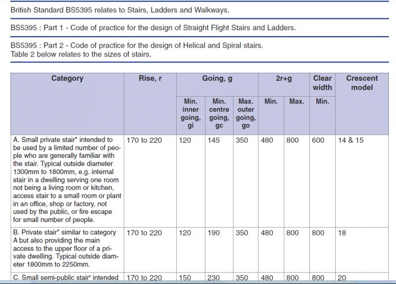

I downloaded this from a staircase suppliers website and its the closest to the british standard I've been able to get to in terms of specifications etc... it makes reference to 'not in a kitchen' ....
I'm guessing I need to go and take some measurements to see if the staircase complies.
2 things -
1st, the stairs have been there for 30 yrs and by default must be considered 'fit for purpose';
2nd, the existence of a BS now does not indicate that it may have been in place at the time and there is no law which says it has to comply, it is simply a code of practice. You will achieve nothing by trying to make this a sticking point with the seller.
