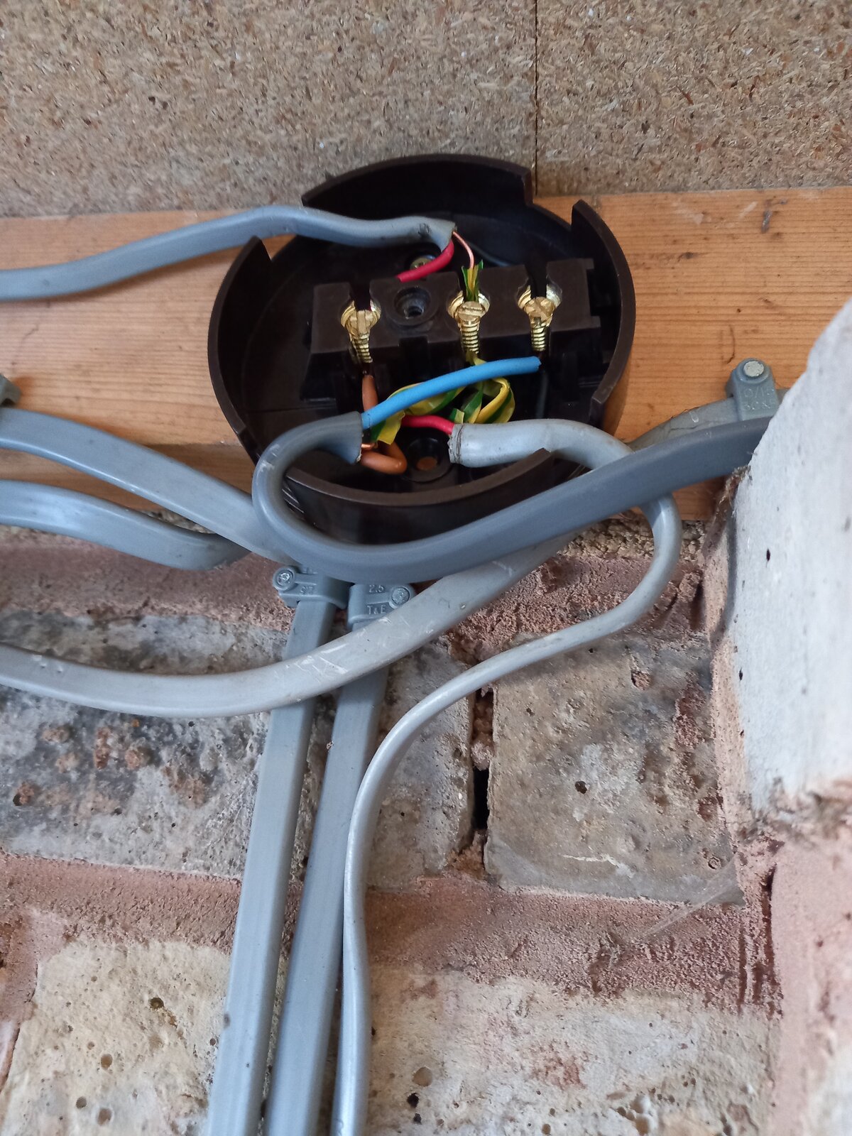

Nothing insitu before. I have 'tapped' into the supply from the switch that goes to the existing centre pendant (using a junction box of course). From this, 2.5mm t&e to the first of the four, then the second, then the third and finishing at the fourth.

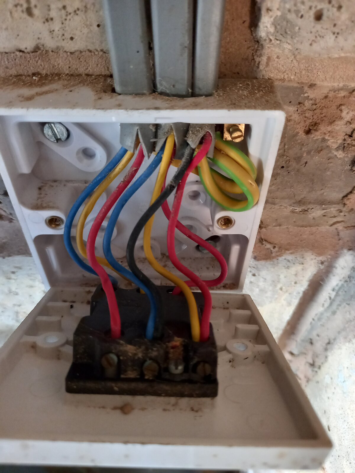

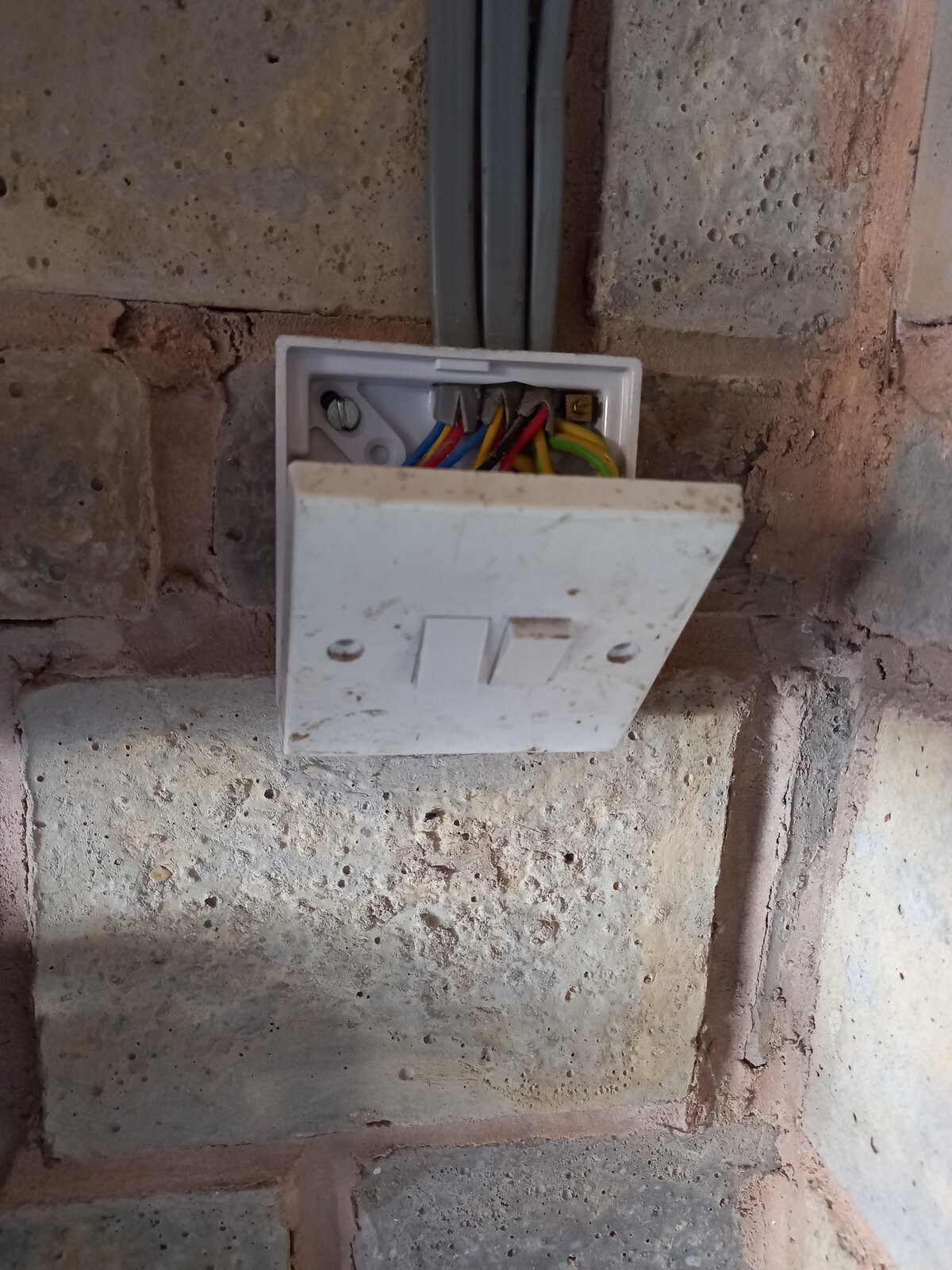

Here's the pics of the switch, it's insides and the connection that I've made into the wire. At the connection box, the larger wire is the one going to the new spots.
It is a 2-gang switch, as you can see. The left switch powers the room lighting, the right one isolates an external security light.
The room lights are also 2-way.
What are each of the wires for? What are the yellow ones? Which SHOULD I have tapped in to? I've clearly got something wrong. Doh!

Yes, you cannot “tap” into the switch wire there. At that point you have a live snd a switched live. No neutral.

You cannot come from the switch at all. There is no neutral there.
If the downlights will come on with another light, then simply take the switched live and neutral (and earth) ftom that light to the downlights.

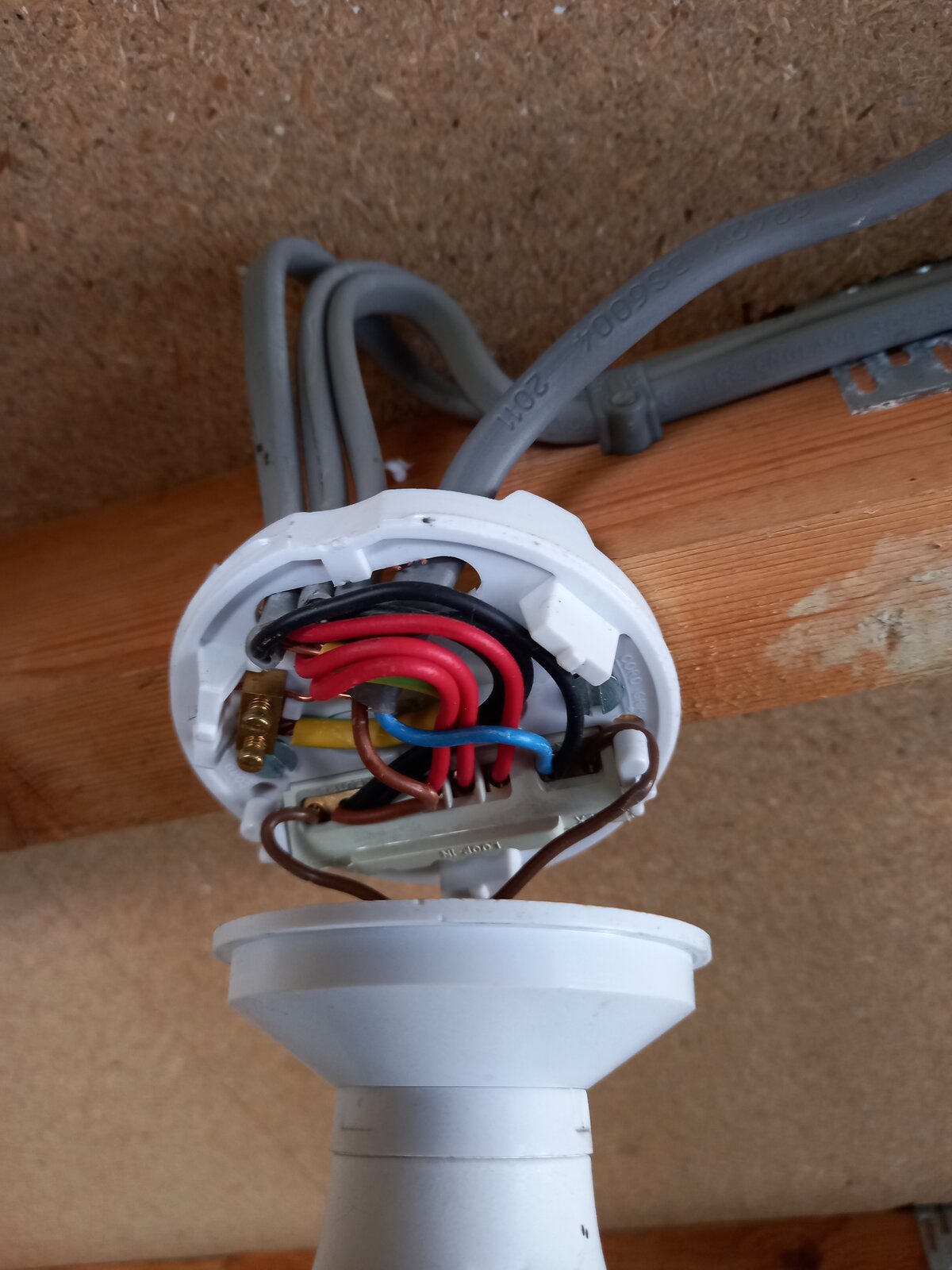

With regards taking a wire from the current light, it's a bit crowded in there. Can I 'tap' into one of the wires going into that instead?
Yes. Just tap in to the two outer wires(switched live and neutral) that go to the bulb holder. Plus the earth, of course.
You’ll not get replacement halogen lamps. So start with those and replace with LED GU10 bulbs when they blow. And they will.
The halogens will cost up to 10 times more to run so may be worth putting leds in now.
