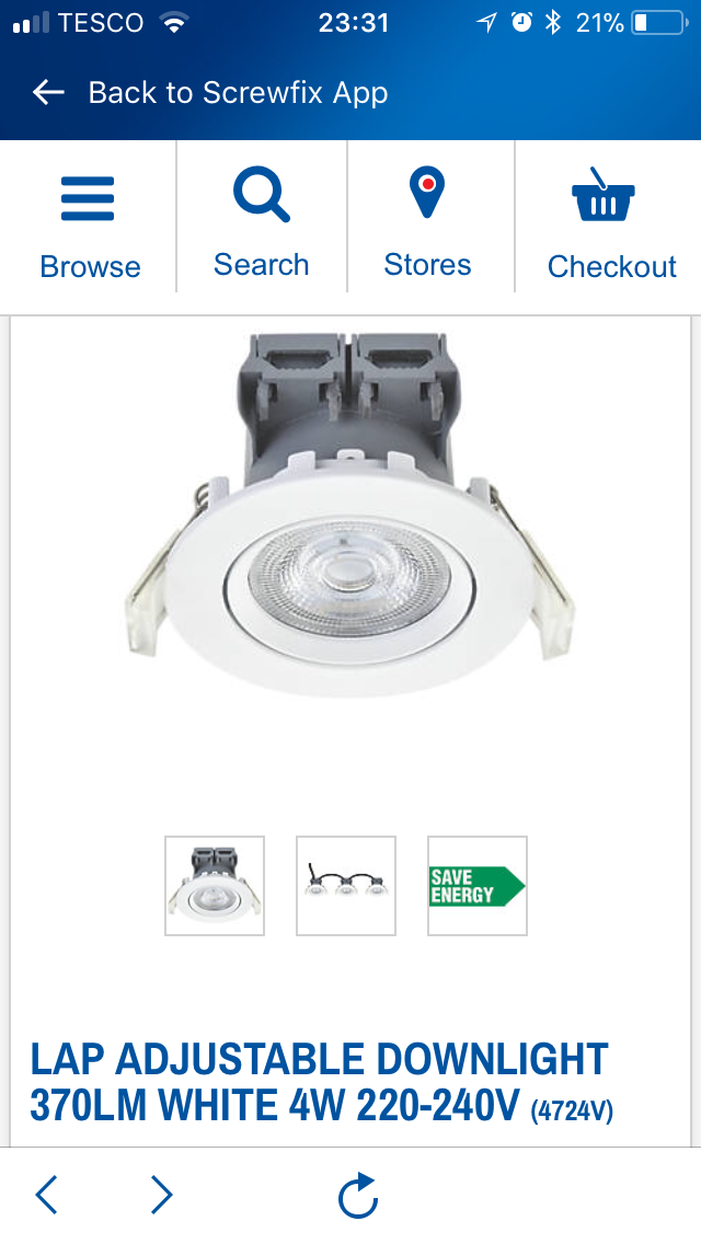

Are these units suitable?
Doesn't really matter as he is (it would seem) going to replace the lights in their entirety and has easy access to the wiring.
