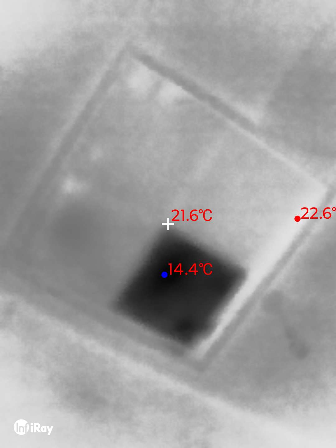

Regular PU foam in cans is a one part product, not a two part product. It is not exothermic. It uses moisture to cure and not heat (unlike epoxy resins and PU fillers). I have no idea what product was supposedly used in your link.
It's not exothermic, it's actually slightly endothermic, which portion of this hatch do you think had some foam put in the void between the two sides?
