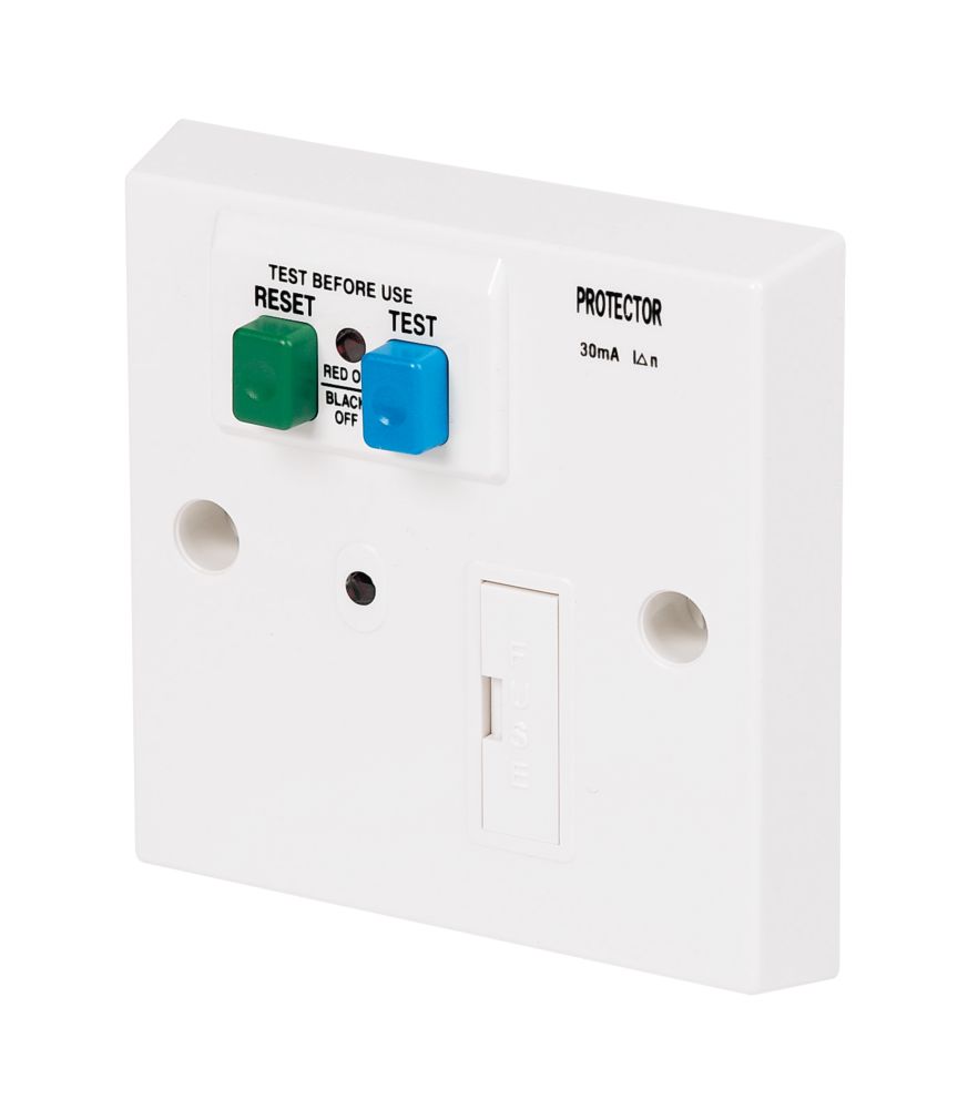

Hi i was wondering if someone could give me some advise please.
I have currently redecorating the house and want to add two sockets in the dining room.
At the moment i have one double socket which is a spur of the back of another double socket which is on the ring circuit in the bedroom next to the dining room. If i change this spur socket to a RCD one can i run two spurs of it?
Also, can i run a spur from the RCD into a junction box and then run two spurs of the junction box to double sockets. like star formation from jucntion box.
The first item from the ring should be something like this which will fuse down the supply to 13A and add a RCD using a back box like this you can put the first socket right next to it. There is then no limit to number of sockets which can come off the RCD FCU as long as the loop impedance and volt drop are within limits which is unlikely to be a problem in a house.
Not unless it is a fused RCD connection unit.

Not advisable to that, but providing the junction box is not hidden under floorboards or ceiling voids, buried in to walls/ is easily accessible and the rating of the extended circuit is suitable for the rating of the junction box as is the cable it could be possible. But I would use the daisy chain method or inter-connected junctions rather than just one.
What I would do personally as it seems you are going to have some disruption would be to extend the ring final circuit.
The back to back sockets should make this easy to do.
But be aware if you have no existing RCD protection all addition sockets must be covered by RCDS. If you do have RCD protection already, no need to add another RCD to circuit.
So options are:
Extend the RFC but have RCD protection at the CU or fuseboard.
Make the spurred socket part of the RFC and connect a fused connection unit or a RCD protected fuse connection, then add addition sockets.
Make the existing spurred in to either a FCU or a RCD/FCU then addition sockets from there.

Thanks ericmark and prenticeboyofderry for your quick responses. I think i will replace the first spur socket with a fused socket and then daisy chain from that onwards. Having looked at the CU i have found it to be a MK RCD CU. Once again many thanks for your help.
Check that the RCD does cover the socket circuit you are altering, sometimes they don't.
So press the test button on the RCD and see if the socket circuit de-energised. If it does, you will not need additional RCD protection on that circuit.
