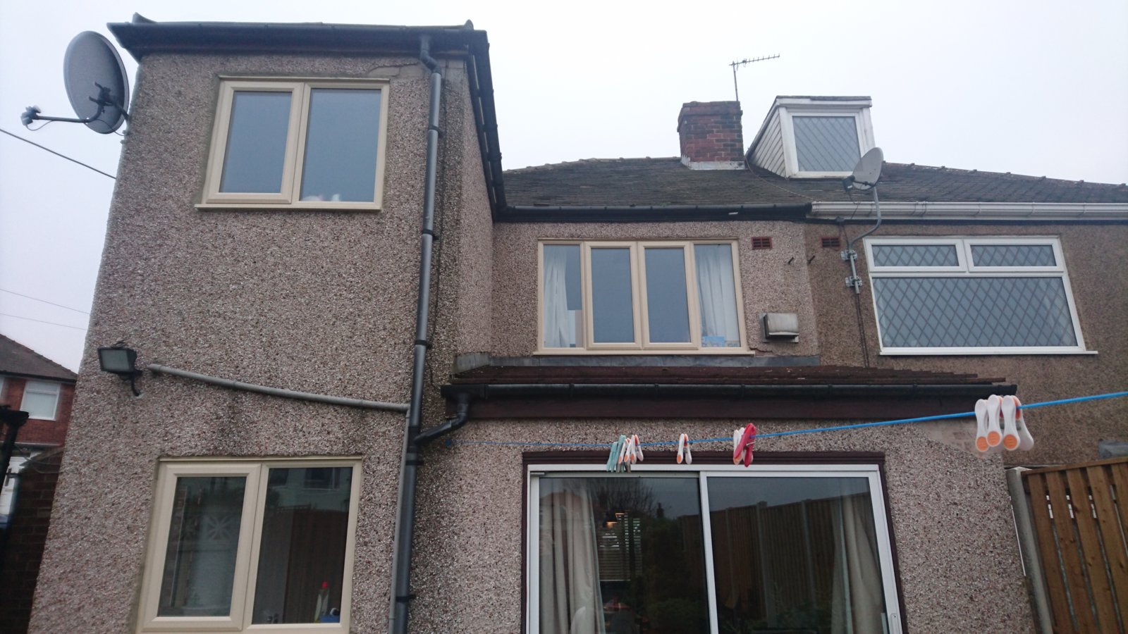

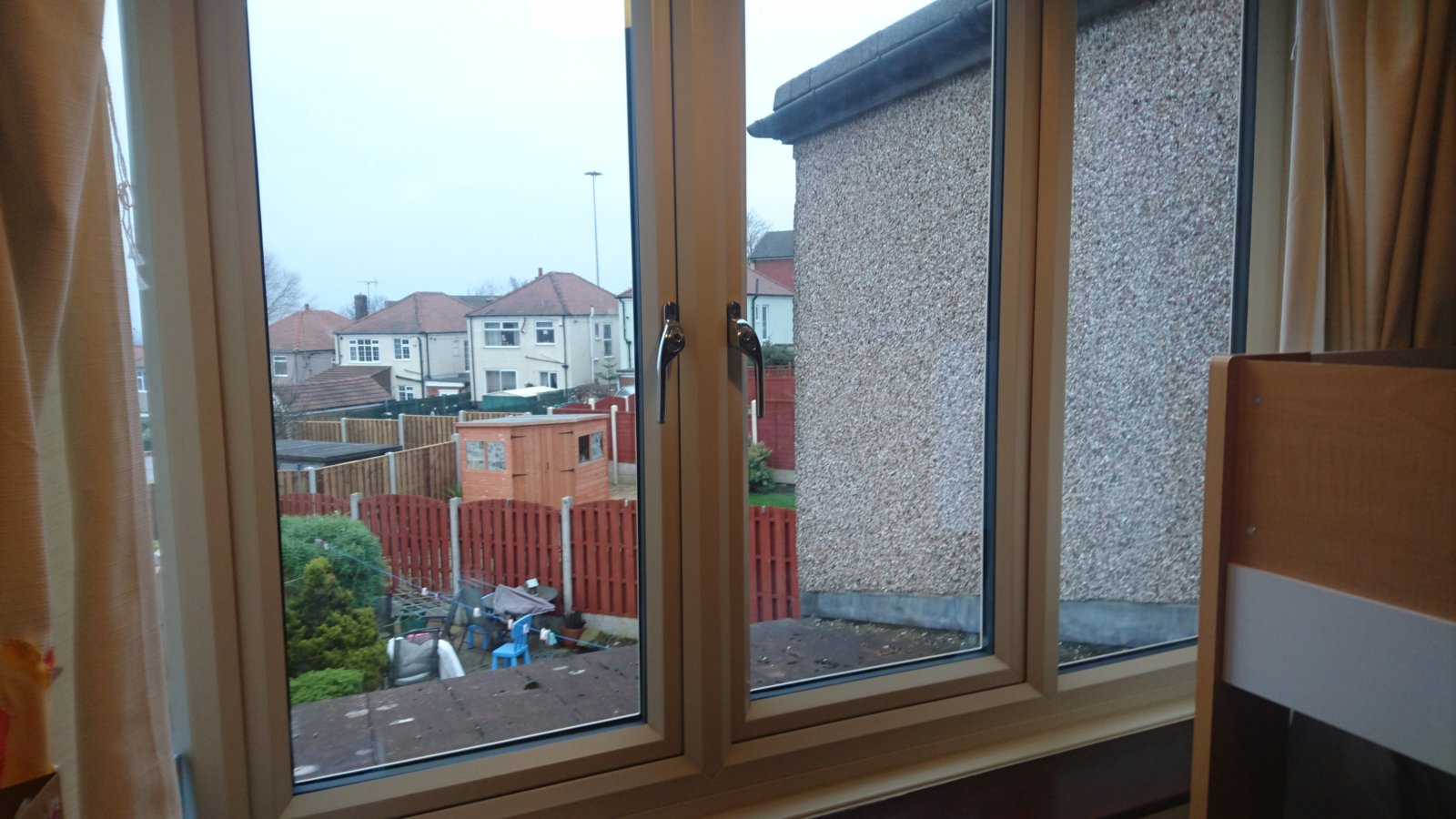

Here's a photo. Basically it'd not make much difference to the neighbour as he'd only see what we see now which doesn't block much light or view at all. Pic taken from inside..I'll take one from outside in a bit.

The 45° rule will prevent it, and the dominance of the new pitched roof will have an impact too for planning.
Access to any new room will be an issue for building regulations, making a lot of wasted of space (and money)
Wouldn't the 45° rule have been a consideration for the downstairs extension? The windows are in the same place upstairs and down. As for the roof, the current second storey is flat (although looking at planning, ot probably shouldn't be...)
Ground floor extension would be permitted development so council would not have had a say.
Many/most council's won't allow a flat roof at first floor level.
Some councils don't take the 45 degree rules into consideration. And many only take specific parts into consideration.
