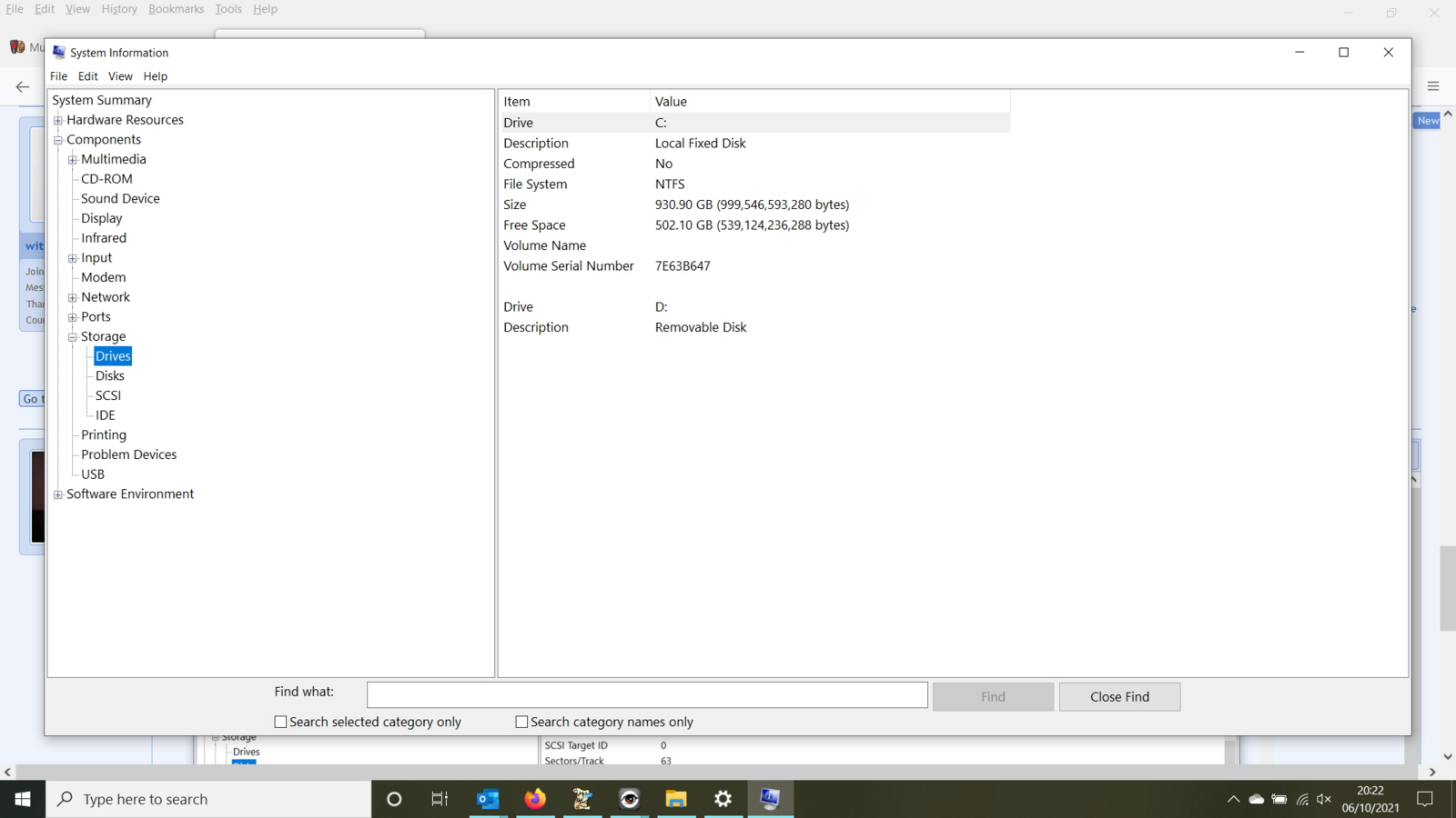

Search the start menu for 'system information' open 'system information' go to 'components' and add some screen shots here for 'disks' and 'drives' and i can I best advise you on what to do depedant on your use case.
Yep Optane memory so an HDD with a separate stick of optane memory (fast memory) usually 16 or 32GB where your frequently accessed data is stored, it's basically combining the benefits of high capacity low cost HDD and the speed of faster storages in a hybrid manner.
It shows D: as a 'removable disk' do you have a CD drive with this laptop or any usb drives/sticks plugged in?
Can you search 'this PC and open it up and take a screen shot of your drives under 'Devices and drives'
Also do you have a backup for your data?
D is a usb stick.
