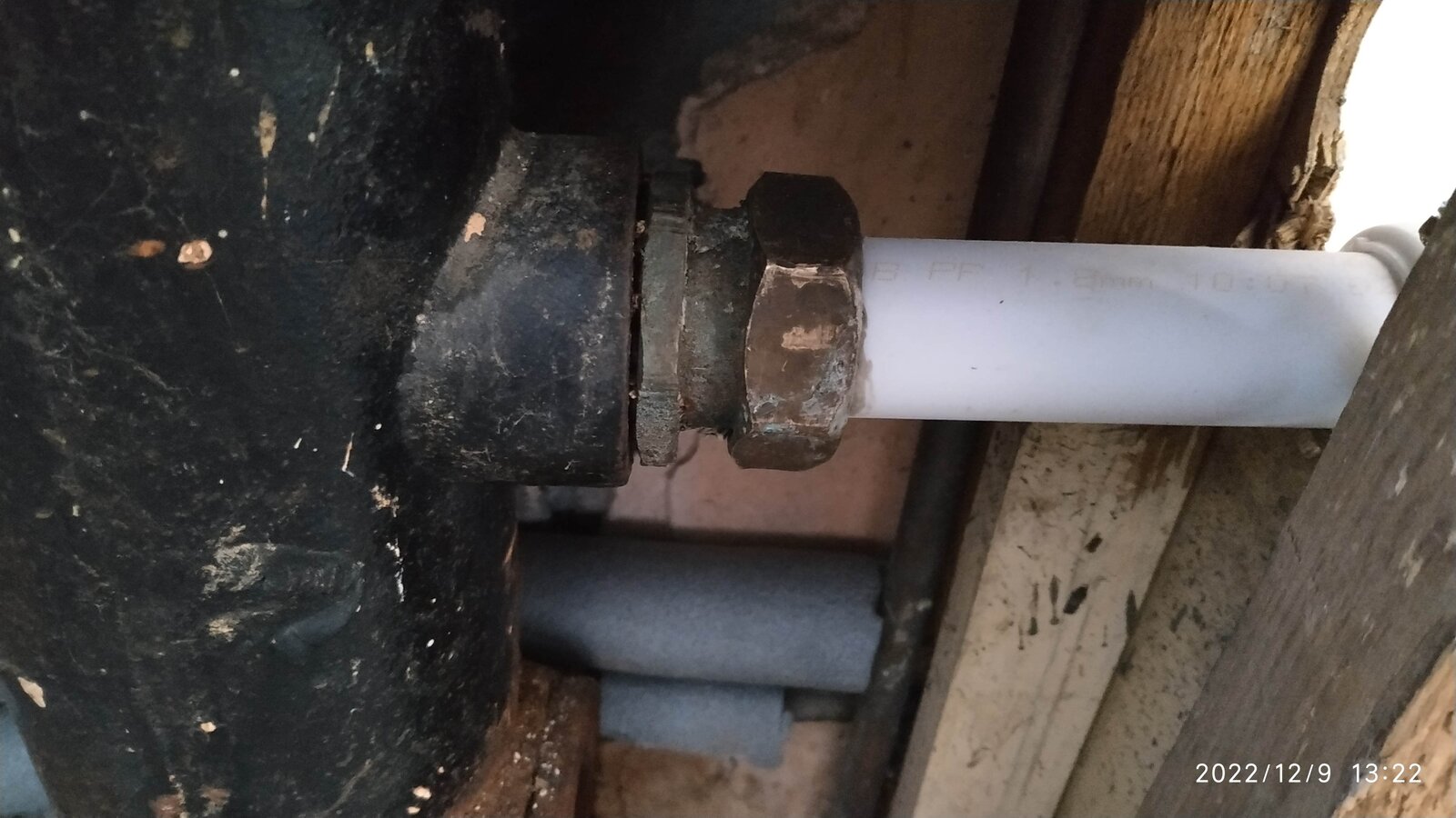

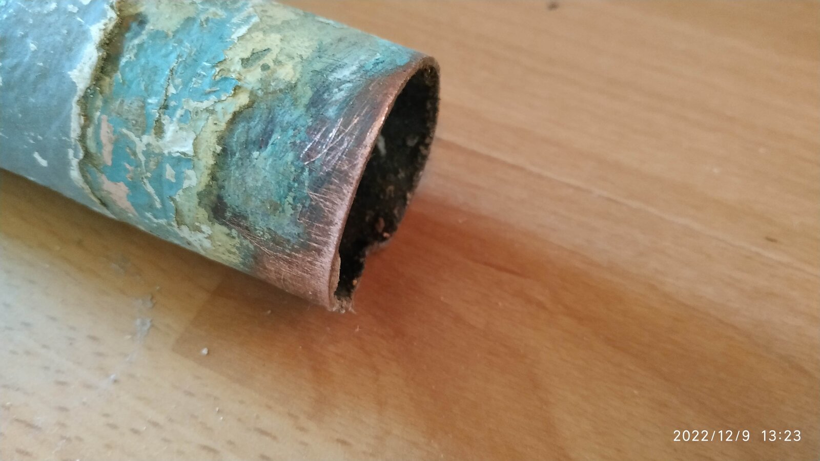

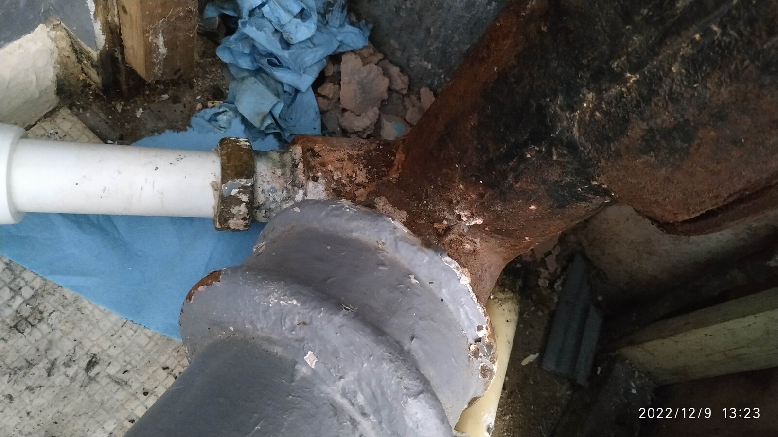

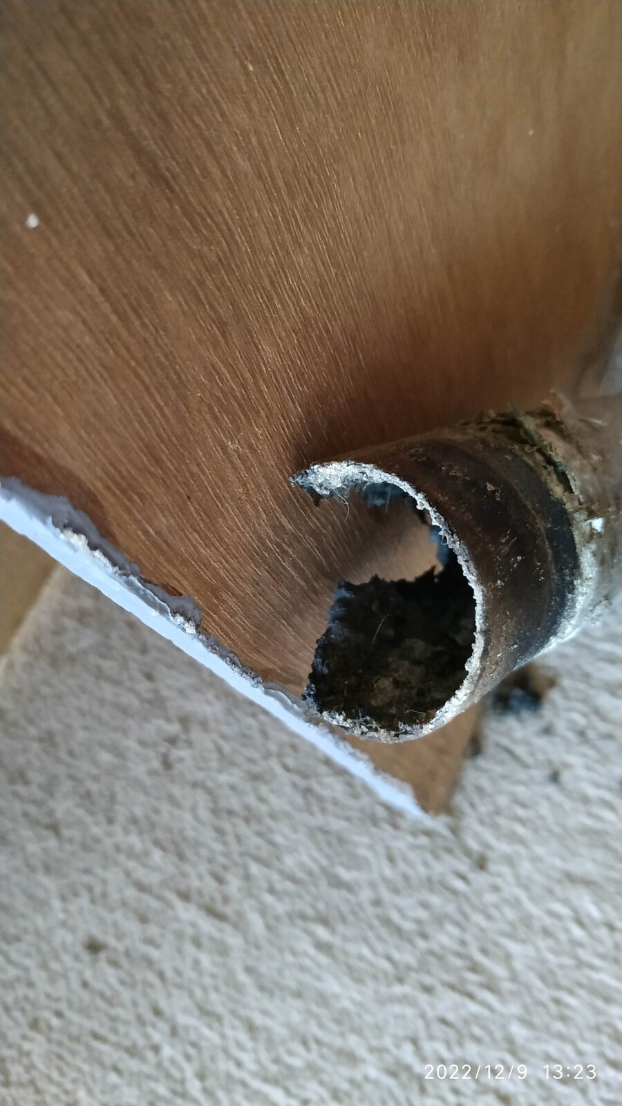

Hi,
I've had to replace all copper pipes into the soil stack, all corroded and leaking.
The last one finished today thank God but it was the worst, no flow, I couldn't push my finger through what was originally a 40mm hole.
The build up has been solid black, I've literally had to hack it off to get free flow again.
This has happened on all 3 I've had to do.
Is it a reaction between copper pipe and iron stack or something else.?
Is there a chemical way to remove it? as I don't want to see it again for a long time. I've used plastic pipe instead of copper so the corrosion problem is fixed.
Thank you !

As requested, do they help with the Q? but looking forward to replies.
1st two are of the stack with replaced pipe, there is one more behind you can't see, so 3 inlets in total. Next 2 are of the copper pipe removed.
All were leaking. The shared stack serves 2 properties, flats, so the one above was discharging into mine.. lovely!
Stack seems to be cast iron, my guess is the effluent discharge is reacting to cause solid build up which I had to hack away.

Are you sure that is a 1970's build, it looks as if it is very much older than that? I would suggest 1950's at the very latest.
