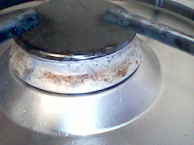

Stained gas hob burner ring
17 Apr 2007
2,666
141
Has anyone got the magic formula for cleaning off such stains?
I've tried bleach ans also a mix of bicarbsoda/white vinegar. Left it to soak in a bowl for 24 hours has not dissolved the stain.
full
Oven cleaner? Anything abrasive will scratch and a cause further staining even quicker .
The solution!
I got a Kilrock oven cleaner spray, emptied the contents into a bowl and let each burner ring sit in the fluid for a few hours.
That resulted in the rings being turned black which I then scrubbed off with a toothbrush to leave clean metal albeit slightly darker.
I've now painted the burner rings with aerosol exhaust high temp matt paint. I masked the gas flutes and sprayed the rings.
They're look splendid!
