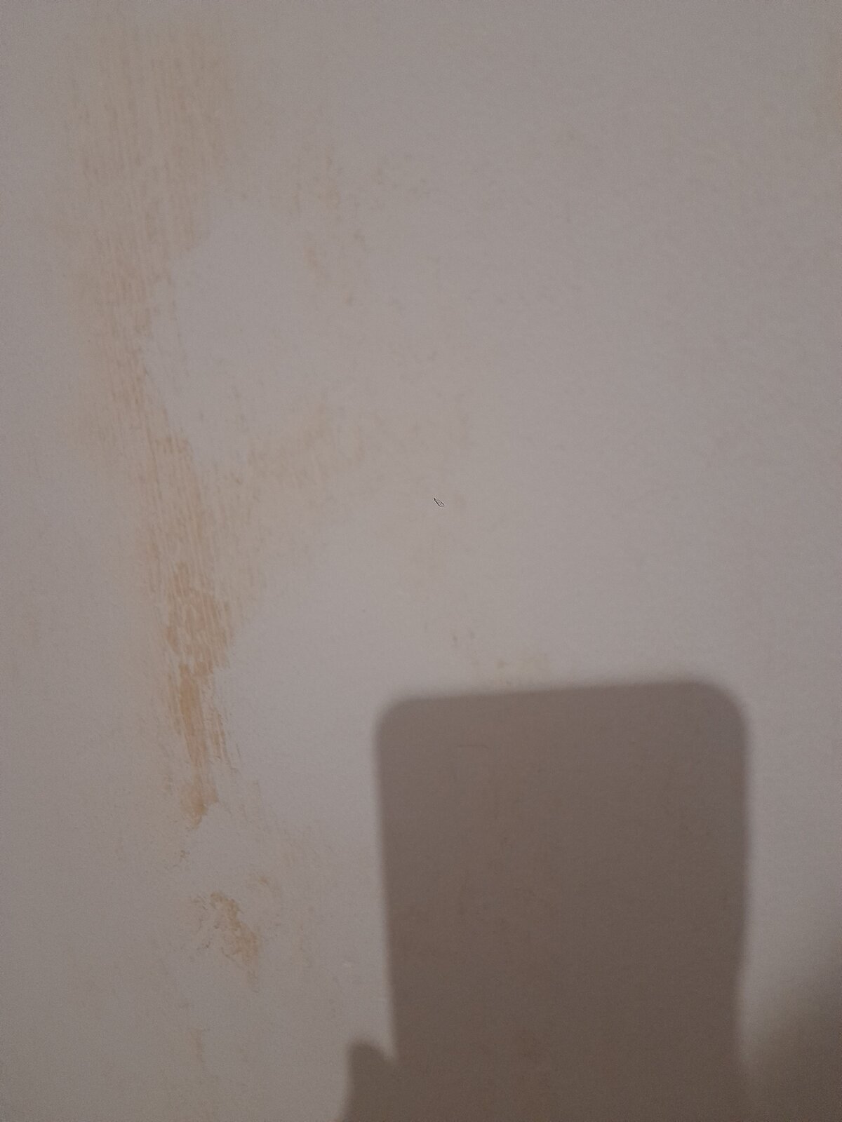

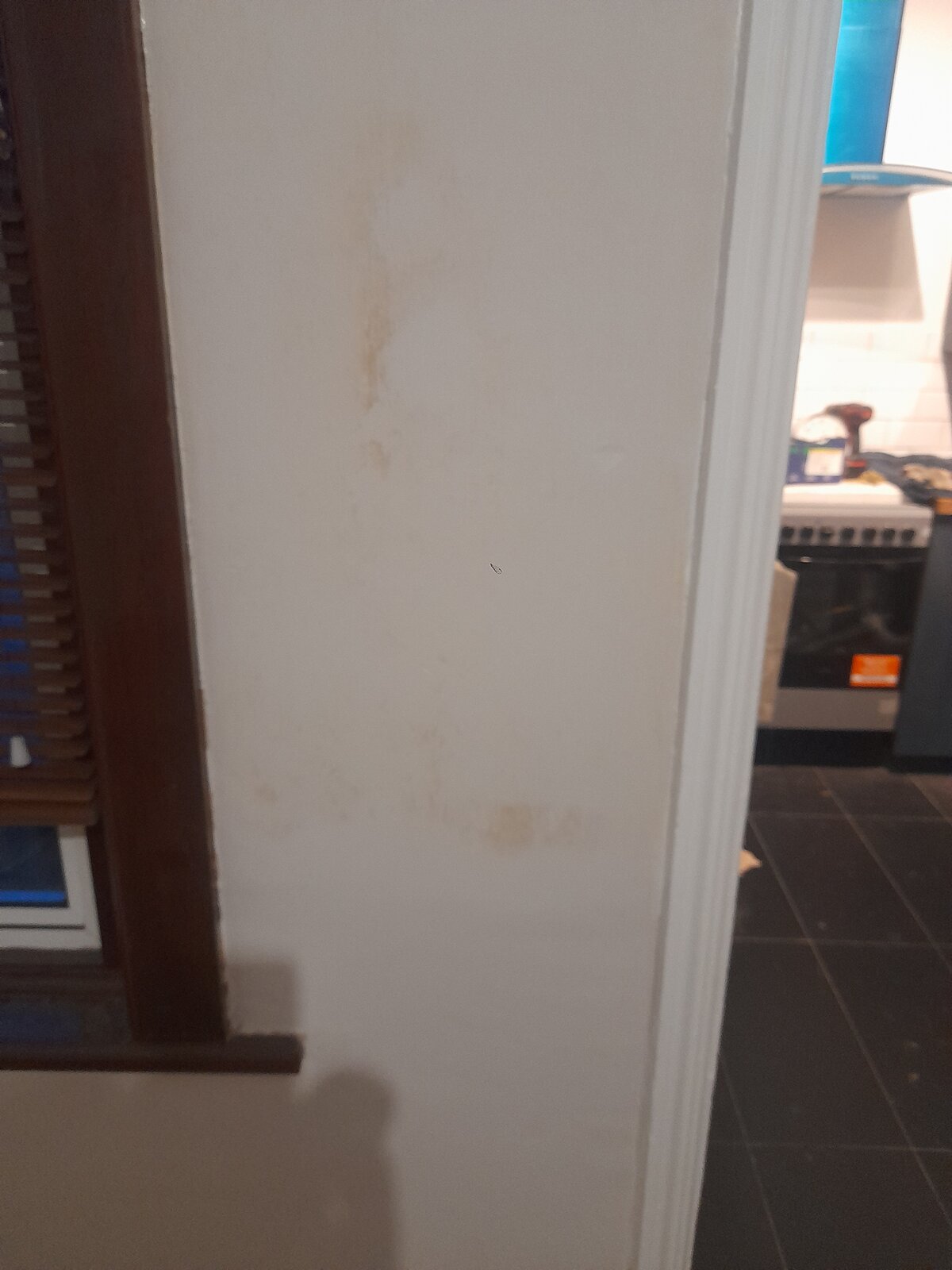

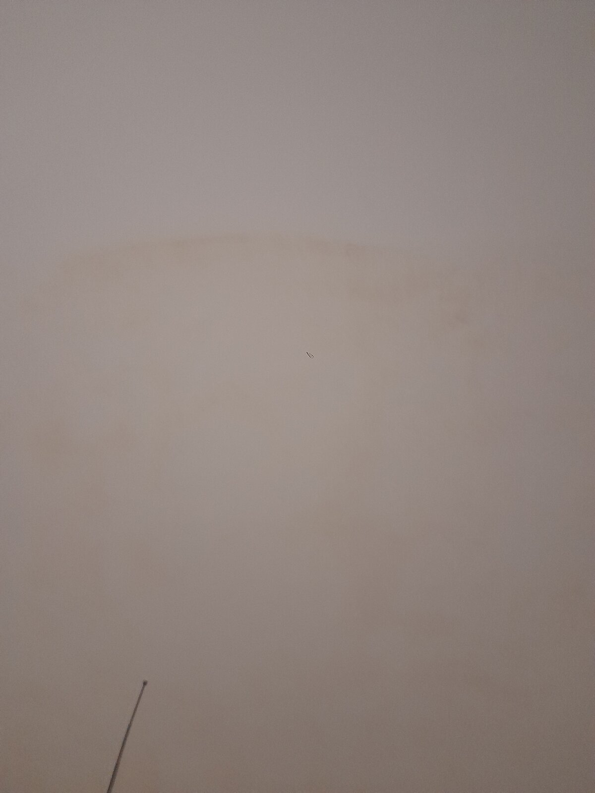

Stains showing through even though Zinsser and 2 coats of emulsion used
19 Aug 2010
289
9
Luton
Hi all, as the title says. Here are some pics. Only on 2 walls but those walls were the most stained.
I guess I shd use another coat of Zinsser and two more coats of emulsion.
Could that work?
Anything stronger than Zinsser I shd try?
Thanjs, Chris.

Just checked with Grok. BIN does have better stain blocking qualities.
As it is oil based, I guess I need a sponge roller no?
Zinsser 123 is not a a good stain block. It's misleading.
It's more for old dirt stains and for stains that won't push through emulsions.
It's a primer undercoat and sealer that's waterbased.
Can't beat zinsser BIN
I have been turned to bin by warners , its great
I leave the lid off the tin for 15 minutes to thicken it up
I like zinser cover stain but that's a 24 hour, at least , cure time
Wickes stain block undercoat is obviously a very similar product and I find ok after 6 hours
But bin or block and bond ...same stuff , different brand ....is the best
Yes its a good primer undercoat ...but if used as such ....very expensive compared to say leyland
Not good for kids pen marks , water damage etc
Bin or oil based undercoat or cover stain
