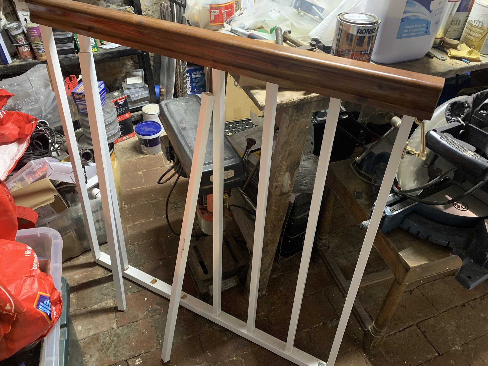

Hello all you clever people.
DIY'er here needing help.
A couple of years ago I spent a long time making a stairgate to match with our banister. It's hinged on one side obviously, and hence when it's open I guess there's a lot of torque running through it with the weight of the gate. I anticipated this to a degree and have a hook and eye for both when it's closed up to the banister and also when it's open against the wall, i.e. so it is supported at both ends. However, inevitably with a family it's been left open and hanging once too often and has come apart a couple of times now.
Any tips on how I can make it stronger, preferably without any diagonal bracing (which I guess would help seeing as that's how garden gates are made) as this would ruin the aesthetic. I made it originally out of good quality hardwood for all the verticals, with dowels both ends of each vertical - these have just snapped through now where the two have come out and others are loose. First time if broke I reglued, but without replacing the broken dowels as I would have had to take the whole thing apart to get new ones in, and added the small metal brackets. Not happy about them really and they didn't work.
Looks like I'll have to take it all apart and start again, but would love some advice on what I might have done wrong, or what I could do better to make it last please?

How about a sheet of say 4mm acrylic on one side, that would provide the bracing and would not be visible, at least not from one side.

Thanks - it's an idea, but being a 400 year old house I want to try and keep modern materials out - not the style I'm after.
Just a thought - are regular dowels made from softwood or hardwood - is it possible to get both? I just used what I had, which if both are available, could easily be softwood?

You could use short metal dowels, they wouldn't be seen.
Base rail looks flimsy , replace with something thicker which would allow you to cut off existing for quick fix.

My thoughts when making it in the first place was that this would add weight and exaggerate the problem I now have?
How would a larger base rail add strength though - it's not the base rail but the joints that failed due to the weight/torque?
Base rail is failing because it’s too weak .
I'm confused (rather than doubting you, I promise - just would rather learn rather than "accept and do!").
The base rail hasn't failed - it's completely intact. It's the joints (top and bottom) that have shown weakness and failed.
