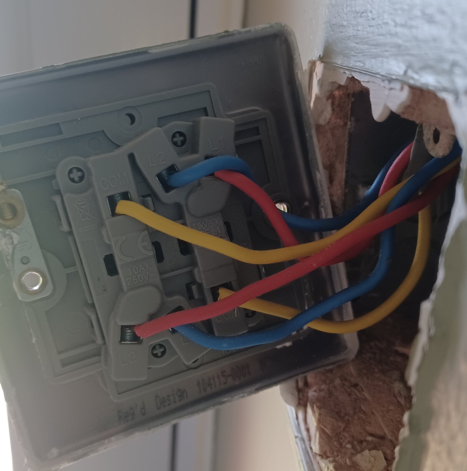

Stairs and Landing 2 way 2 gang switch help ...
4 Jun 2025
Have moved and light switches do not work correctly ...
This is the downstairs hall light switch - 1 switch for upstairs and the other for downstairs. There is a 1 gang 2 way switch on the landing and the same the other end of the hall
Any advice on the wiring I have found?
Much appreciated.

picture of the other switch - you have the same switch image twice
would they both be 2 way switches - the wiring (although could be anything) looks like it might be 2 way
that switch look like a 2 gang switch,
There is a 1 gang
not 1 gang
Seems like you have 2 by 2 way circuits one for the hall and one for the landing. One of the 2 gang swutches should switch on/off the hall light and it should also be controllable by the other switch you say is at the other end of the hall.
The other switch on the 2 gang one should switch on/off the landing light and you should also be able to control it by the switch on the landing. If this is not how they are operating please give a more detailed explanation of what is happening/not happening.
But, as ETAF says, we need to see the connections in the other switch or switches.
