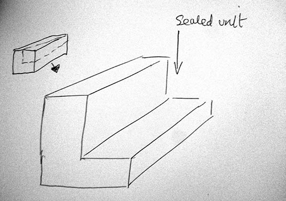

If you can advise on router that fits well into this would be great. I want to make some windows (insert sealed units into frames) window router.jpg
PS I bought and havent yet used an Erabeur plunge router but on reading up may not be best suited to table (IKEA) top?
