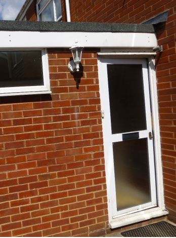

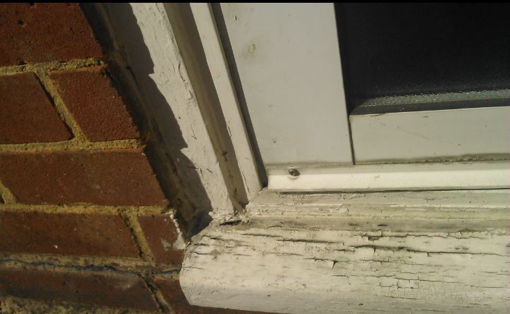

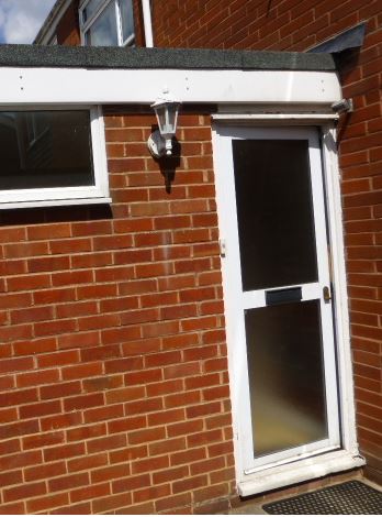

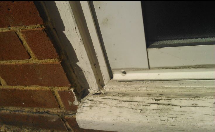

A couple of pics of the door/frame/sill that’ll be replaced.. :
The frame will sit in single skin (half brick) wall (and sub-sill).. There’s no brickwork above the head of the frame. Frame will abut the outer-leaf of the main house cavity wall (to the right).

If you dont have enough room to seal under the cill after the door is fitted then I put the cill in first bedded down. Looks like you have enough room to seal it afterwards though.
Turn the door on its side and see how your threshold sits on the cill, Some are flush and some the lip protrudes internally by about 3mm.
Dont forget to seal the back edge and the 2 ends of the cill.
