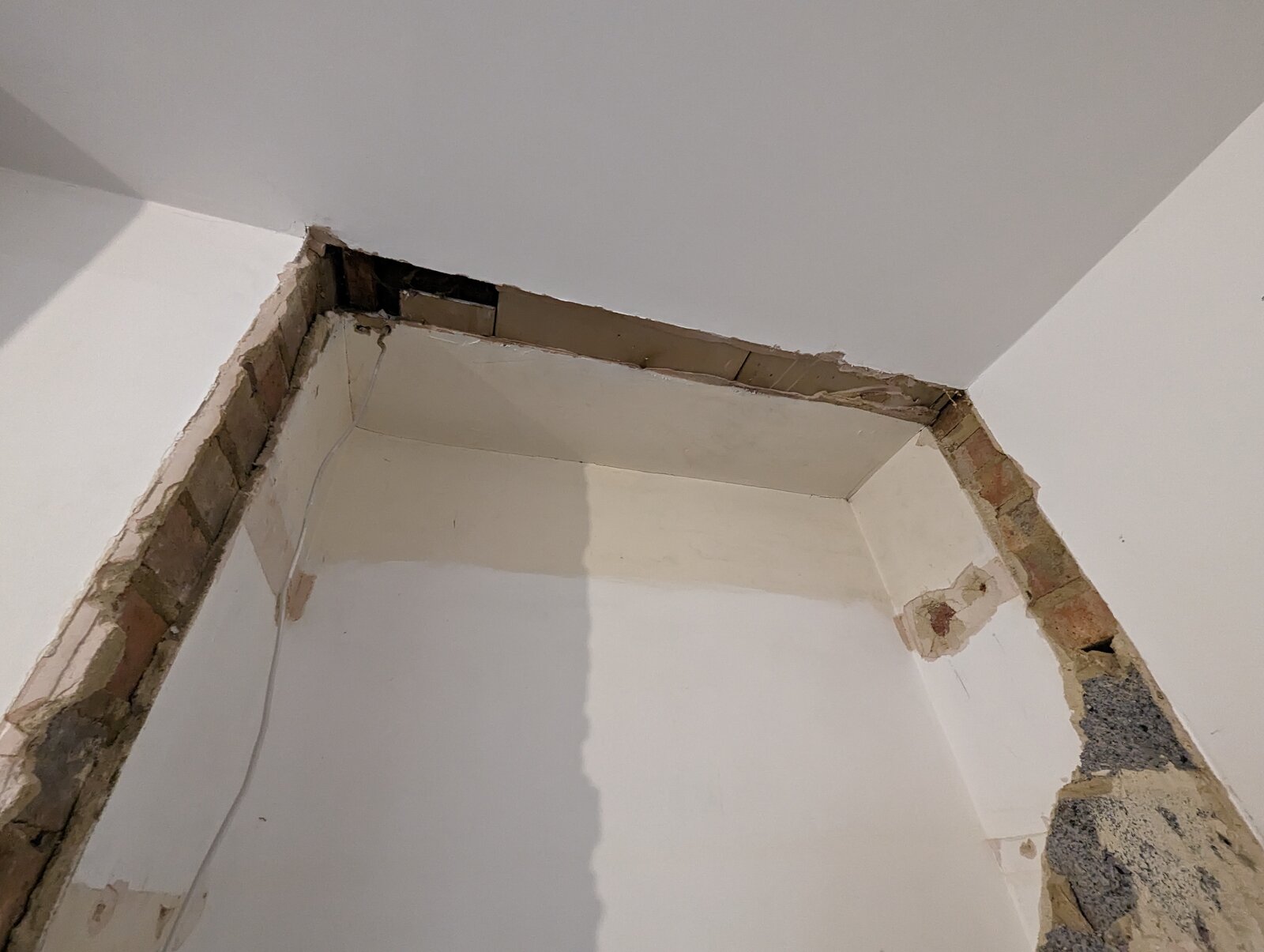

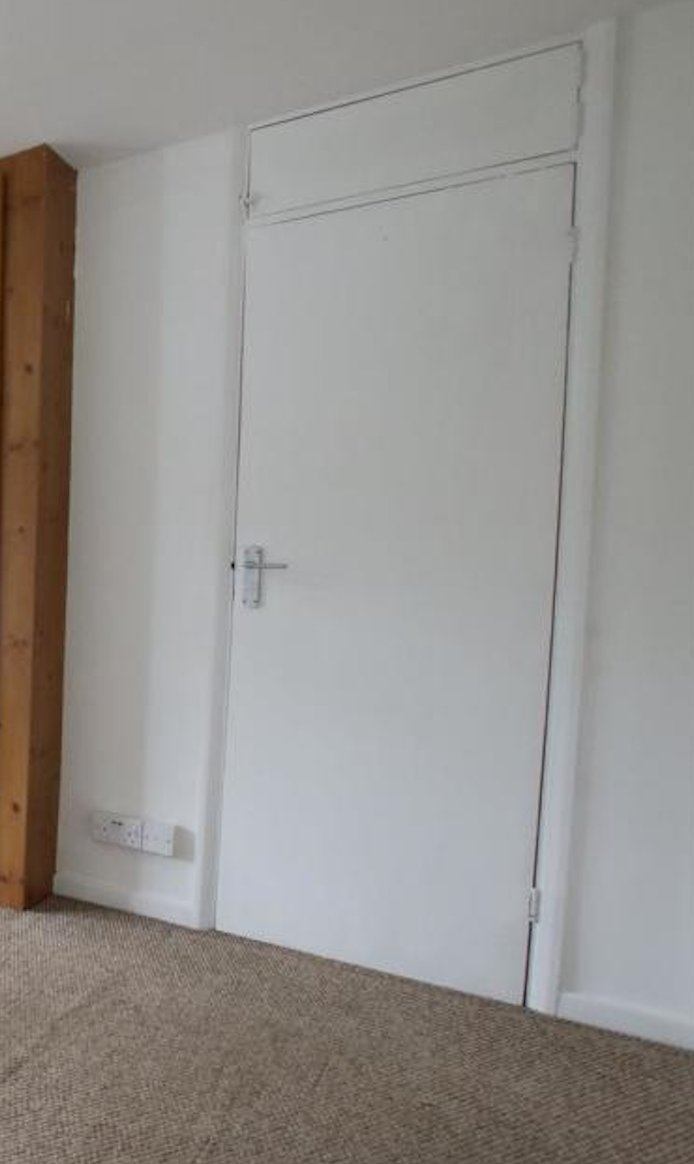

Recently moved into a 3-bed semi detached 1960s house. There is a built-in cupboard in a bedroom on the neighbouring wall. It sits between the chimney breast and a wall that neighbours another bedroom. This is how it looked before I started any work:

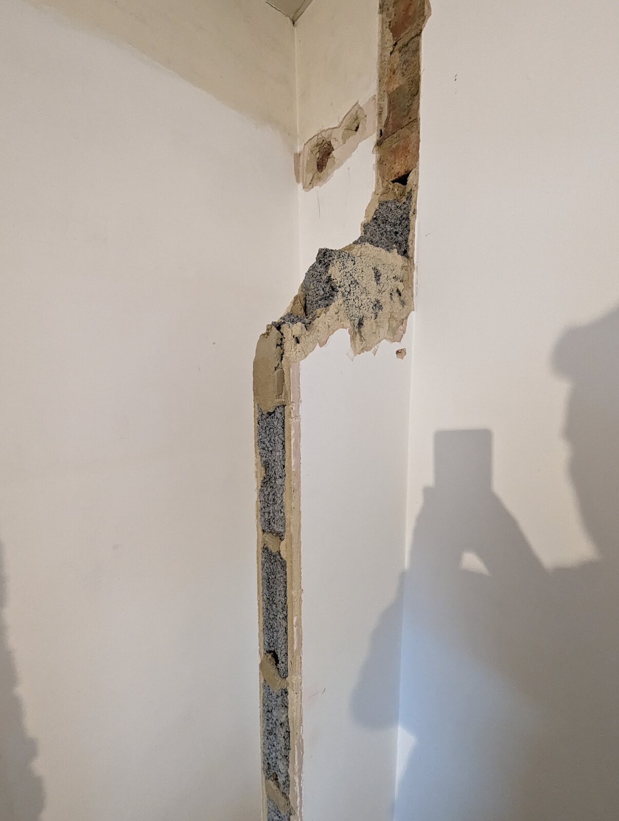

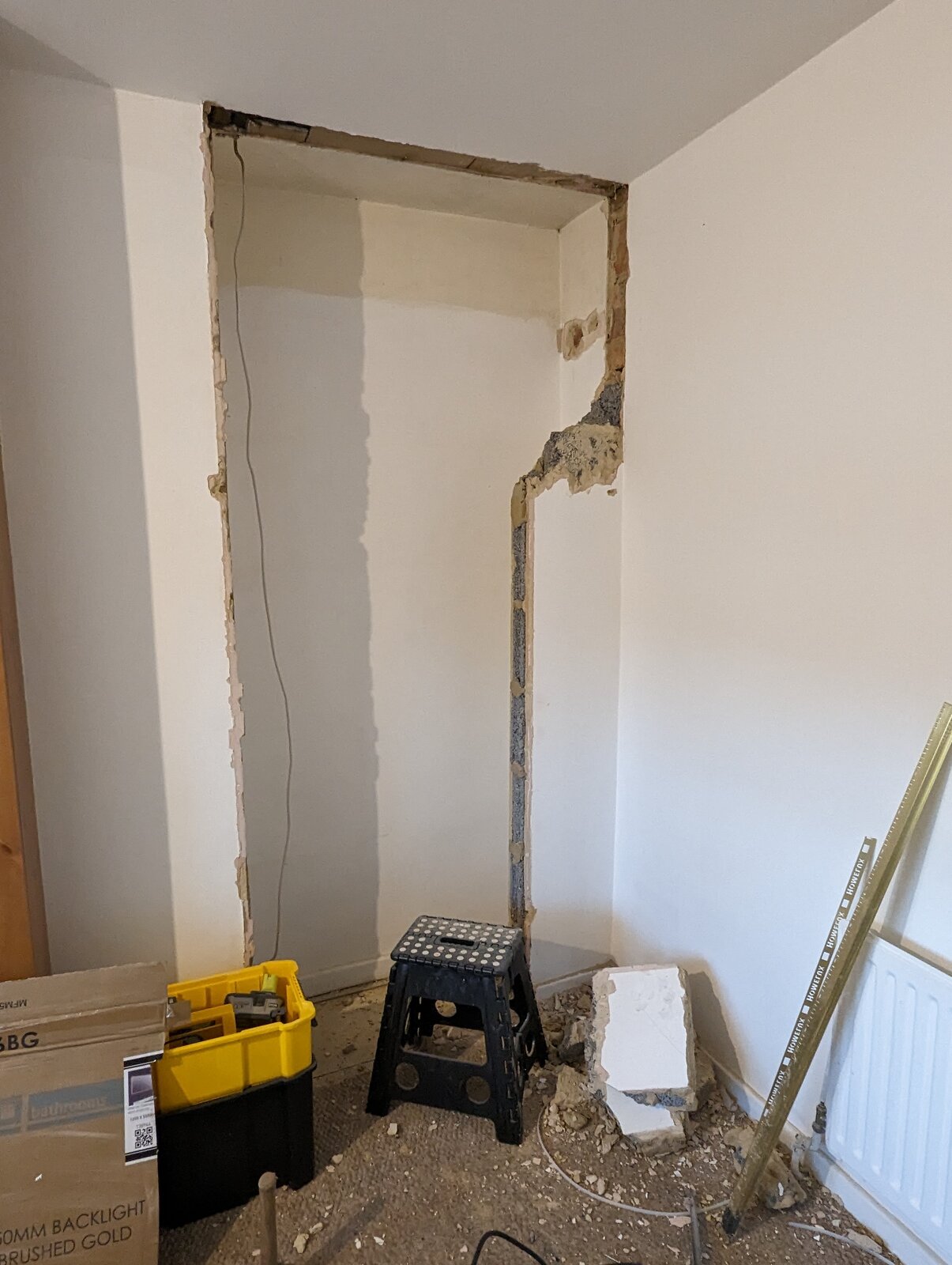

I removed the door and frame which opened up the space, but it left an awkward, small wall on the right side which is made from breeze blocks. I checked with a couple of tradies who happened to be round and they thought they were non-structural, non-load-bearing and could be knocked out. I also had a builder round who took a look and said the same. Up in the loft the joists run perpendicular to the little wall, but nothing is resting on the breezeblocks.

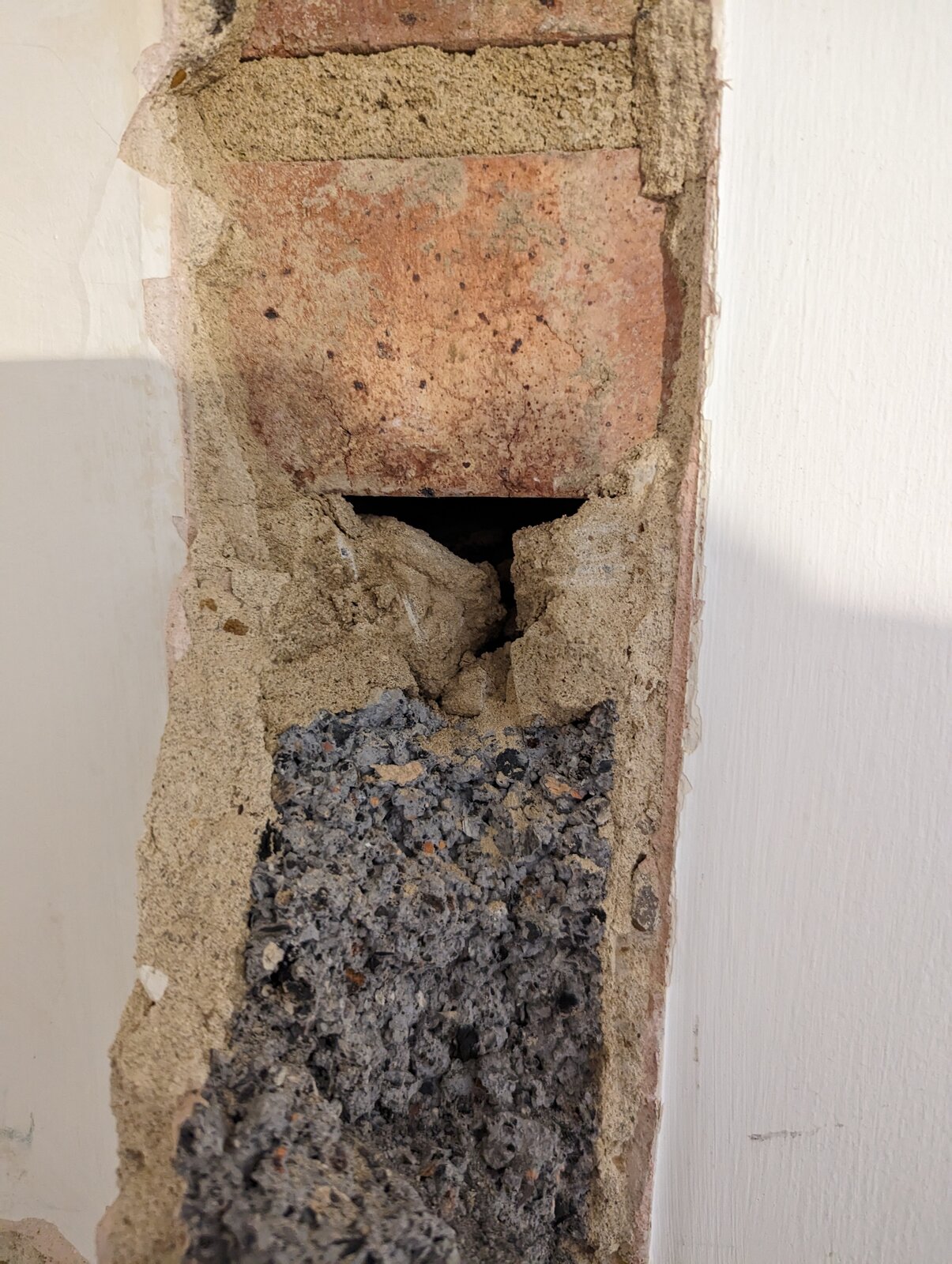

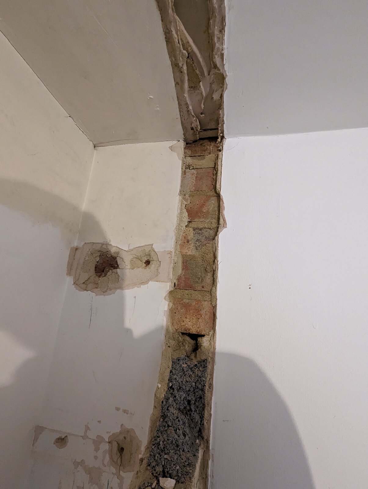

Based on this, I cautiously started chiselling away and removing the wall from the top down. Straight away it was obvious the breeze blocks were not supporting anything at the top, and the mortar was just butting up against the plasterboard above it - great I thought. First couple of blocks came down fine and revealed the brickwork behind them. Then after about the 3rd breezeblock, it noticed a hole in the brickwork behind it, seemingly filled partly with mortar. It also seems that the breezeblocks are now further into the wall and not butting up against the brick behind it if that makes sense.
My question is, should I continue? What is holding up the brick work if there is a hole in row? Is the breezeblock wall acting as a support to the brick wall even though it wasn't directly supporting anything on the top?
