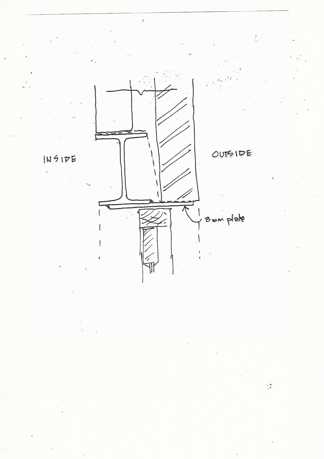

They seem to be a bit clueless about basic construction and just making things up as they go along. There is a concept, traditional i know, but has worked for a few years, and that is that someone draws plans and someone else sticks to them.
Now you have all the loads going on a thin plate that was not designed for the loads, and an ugly exposed steel on the outside that needs hiding in a risky way, whereas it should be on the inside where it can be covered easily.
This is how it should be done (stiffening gussets not shown).
How you you insulate the steel plate there that goes through the insulation layer? To prevent a thermal bridge.
You glue a strip of insulated plasterboard to the soffit of the plate.
Also, you pack fibreglass insulation each side of the web and up against the cavity tray.
Got it, so effectively put the beam on the"cold" side and insulate it well. Presumably you put a decent vapour barrier on the warm side of the wool too?
