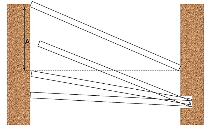

So I'm installing 4 steel beams for my loft conversion, and I'm pretty much up to all of it apart from the actual manoeuvring of the beam into the pocket and onto the bearer plate.
The problem is, the wall span is 4650mm and the part walls either side are 150mm depth. This is a total of 4950mm. The steel beams by the structural engineer are to be 4800mm. We're in a mid terraced property so we are not able to cut into the wall more than 150mm.
When the crane is lifting in the beams, how are they going to be able to be inserted if the face of the party walls are narrower than the steel. The beam will get stuck as it's being turned into place. Right?

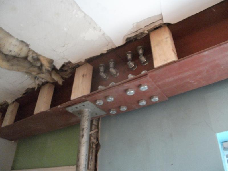

If the beams have not yet been delivered, you could have them cut and spliced to make it easier.
Splices for beams commonly consist of bolted flange plates top and bottom, and bolted web plates. There is a cost to this as the splice has to be designed, and the fabricator will charge for the plates, drilling and bolts.
But the cost might be offset by not having to hire a crane - shorter beams can often be manhandled into place.

I think you're asking about the "swing" room you'll need:
If the gap is indeed 4650, and the beam is 4800 long
then dimension "A" is given by (about)
SQRT( (4800*4800) - (4650*4650) ) which is 1191

If you have a pocket in one wall which is 150mm deep, which I think you're suggesting, then you don't need ANY slot in the opposite wall to get the beam straight across. (Pocket in left wall not shown...). The beams in the sketch are all the same length. Twice the width of the beam looks plenty, for the length of the pocket on the right.

I can't help thinking you only want to go 75mm into each wall.
That means you DO need a long slot in the wall on the left.
Adding 3mm to the length of the beam to allow for its width, dimension A came to 866mm long, which is about a metre ;).
If your pocket on the right is 100mm deep (not 75), "A" comes down to 712mm, etc.

Alternatively, cut the beam to 4600mm and insert two PFCs into the wall each end and bolt to the beam. You will need your SE to design the connection for you.
