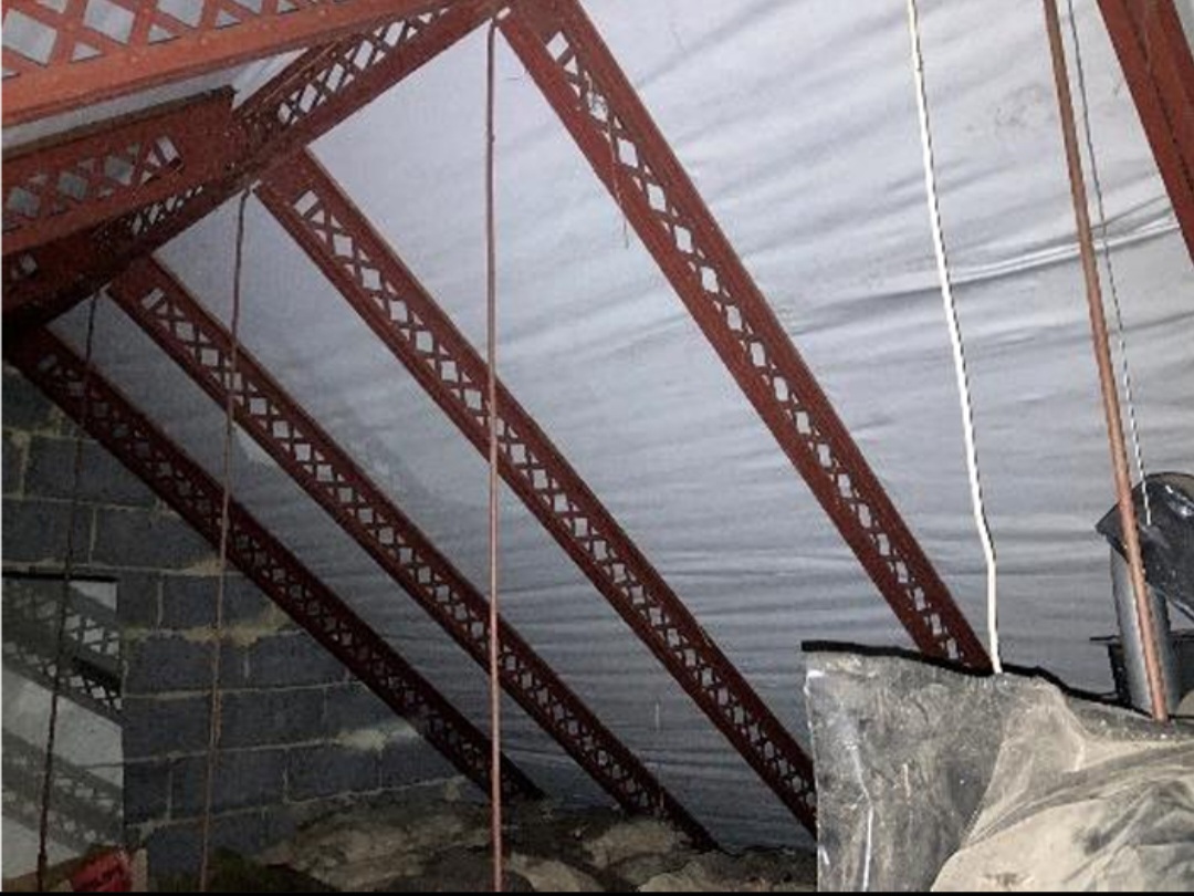

Chances are slim I know as this is an ancient thread, but you don't have any more information on the houses in hothfield do you?
As I'm currently in the process of buying one.
Whatever Metalguru was on about sounds a bit confusing. The thread was about Trusteel houses but MG first mentioned nusteel houses and then finished with Airey houses - which are not steel framed and are not fine. They are actually designated defective.
My advice is start a new thread and ask about your specific house type?

The houses in hothfield are in fact steel so I'm guessing they are nusteel.
I was more interested if he specifically knew how they were constructed.
I've attached a photo from the loft.
