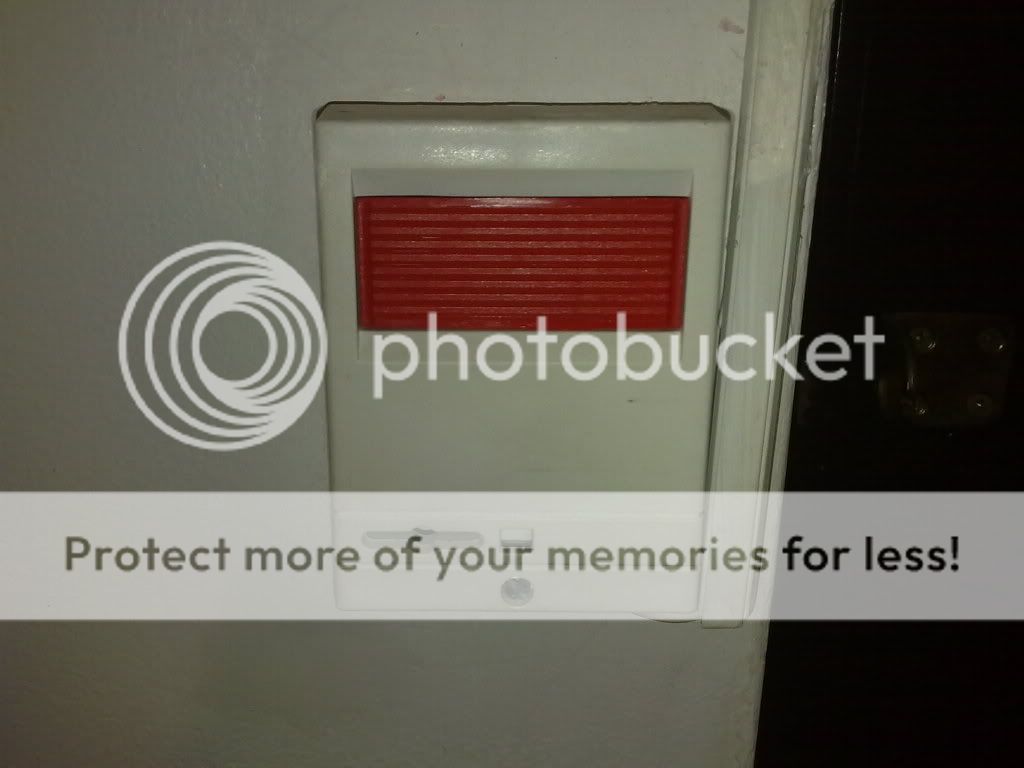

Heres the button my friend pressed to set the alarm off, Is there some kind of key or card for this ?
Just to add the alarm was not armed went it went off.

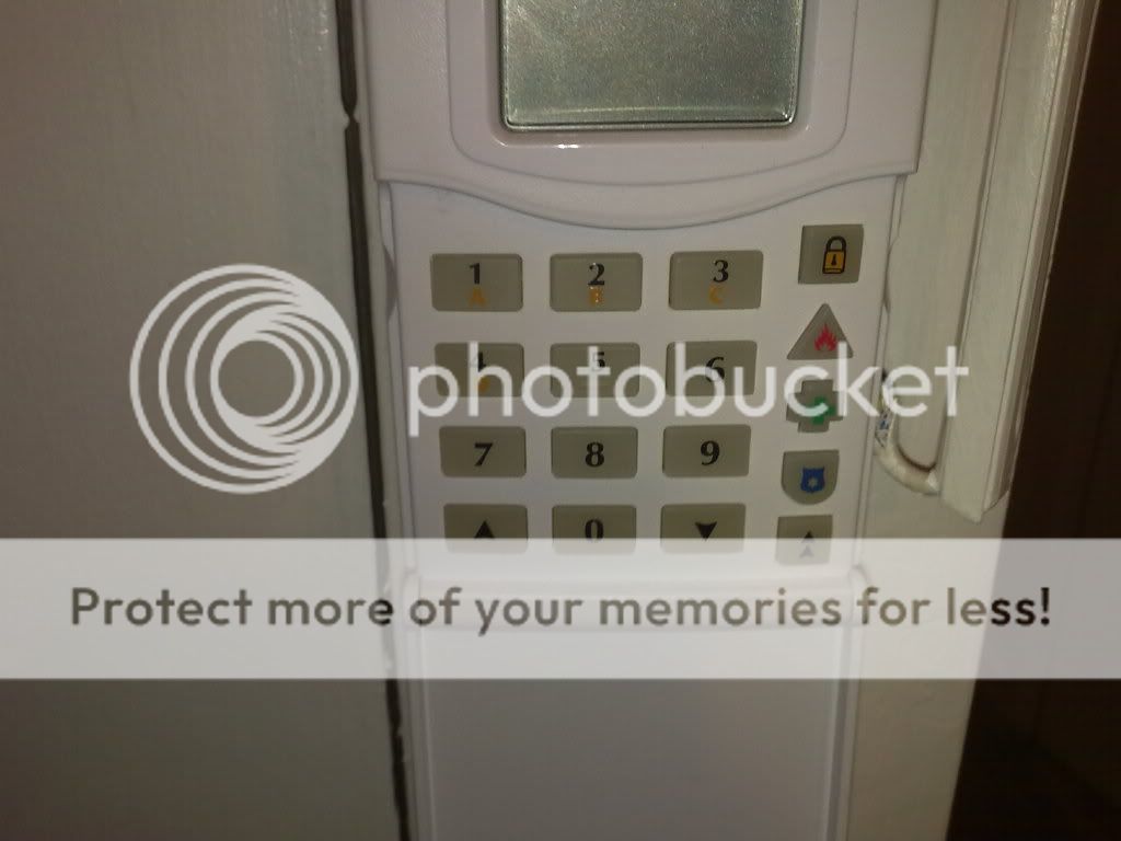

Heres the icon keypad (their are 2 of these )
So what do i do help please.
The thing he pressed was the panic button. There should be a double sided key that resets it. Looking at it, it doesn't look depressed (like the rest of us) as it normally shows red. If you have no key you can take the lid off and reset it manually. Then rearm the whole alarm and if it goes off you enter your code. If it starts that little bleep going then press the function button which on that keypad is the one with the two little triangles. If that doesn't work you need an engineer.

If you don't have the user code or the engineer manual you won't get very far.

I managed to download an engineers manual for it so problem fixed.
NVM reset and now works perfect.
