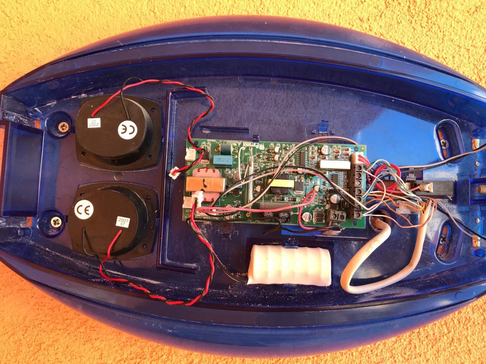

Need some help. Sterling Pyroxi 10 sounder not working.
A couple of weeks ago I had to remove the outside sounder bell and all the connections attaching to it. Now I tried to install it again putting everything as it was, making sure that all connections are attached to where they should be, but unfortunately its partially working.
When the sounder cover will be open it goes on even when removing its fuse from the alarm main panel. But, when alarming the system and triggering the alarm, the alarm main panel goes on but the outside sounder bell does not. (not blinking nor sound)

Thank you for your reply.
Here is an photo of what it looks like at the moment. I’ve disconnected the speakers on purpose to avoid waking up the hole neighborhood :)
One more thing i am activating the system as i was doing before this problem.
And this is how it was connected before i took the bell apart.

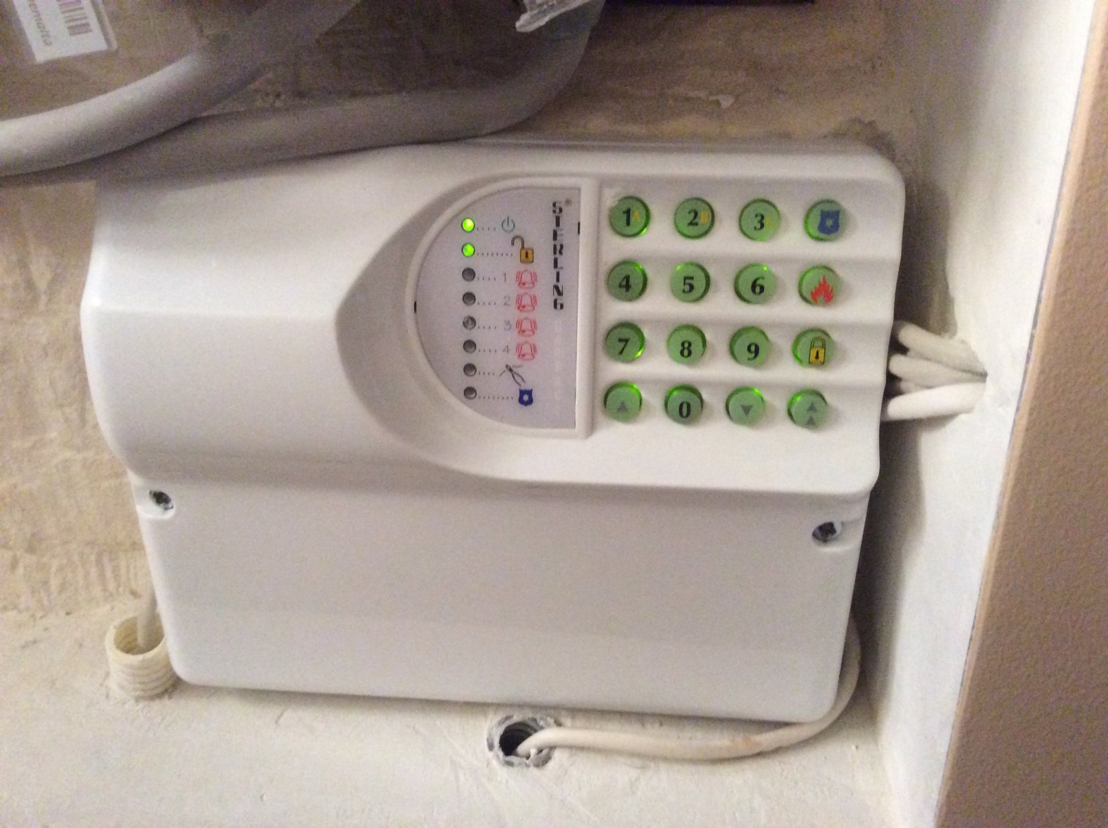

Below is a photo of the panel
Does the panel activate ( code needs to be put in to stop panel speaker and second from bottom led lights ) when you take the cover off the bell ?
Yes the panel activates when i remove the bell cover and the temper led switches on.
Ok then ....first step would be ...take lid off bellbox , wedge tamper switch closed ...get a piece of wire with both ends stripped back hold one on B- and the other on BA , it should sound ...if so ...it’s panel , wiring or how you are trying to activate the alarm

What devices do you have on the panel ? Any movement detectors ? Do they light up ? Only other thing I can think of is that some pyronix export panels have relays on the pcb , can you post picture of panel pcb ...
I’ve bypassed b- with ba as you suggested and the sounder does work. I did not disconnect any wires from the panel so wiring problem fro the panel side is impossible. I’Ave cheched and rechecked the wires on the sounder and everything is as was previously. Can you tell me which wire signals the bell to go of coming from the panel? Maybe i’ll check for continuity.
