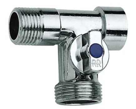

Hello. I have unusual problem now for 4 years. The water that is in the supply hose stinks or rots I don't know. It's not the drain problem, the washer smells nice, it only stinks when it pours out the water that stays in the hose then the water is normal, but if the WM/DW is off for 4 hours it already gets the stink again if you start it and it starts to pour water into machine. Searched whole internet literally did not find anything like this. I tried to unscrew the 3/4 hose on the supply line with ball valve and it doesnt stink from that place, but if you unscrew it from machine side it starts to stink , its literally like half of the hose has rotten water and the other end (the supply end) doesnt smell.. Since i searched everything I tried AI chatgpt and claude.ai both suggested to try installing check valve but the question is where. On the ball valve or on directly on the WM/DW? It said that I can do both just to make sure that there is not backflow into main water line (because if the ball valve is open then the faucet which is on the same setup also starts to stink like eggs but not that strongly so obviously if ball valve is open it starts to collect the gases/water from the hose.

Edit: I added a image of what tee valve i use to connect everything. I have cold water pipe going from the bathroom to the kitchen it has 1/2 male end, this tee valve has 1/2 female connector which i put on the main pipe and as you can see it has 3/4 connector for machine and on the top it has 1/2 male connector, so I take 2 of those and join them together so I can connect 2 appliences, the top which is left the 1/2 male is connected to faucet. Kinda unusual setup but I had a plumber installing this I did not make it up myself.

The water supply comes from city lines into this building and all apartments. Haven't heard anything but I also never asked them I dont even know how to approach them with such issue lol. Since I was living here for atleast 13 years this never happened before but for some reason it started to smell from the machines, not from faucets,toilet,shower nor kitchen faucet and they all share the same cold water pipe, when I tried to unscrew the 3/4 connector from the pipe the water there doesnt smell at all, it is literally on the machines side, when you detach it from machine side then it stinks. No I never tried the experiment with the hose, I guess I can try it but doesnt align with the logic that the faucet doesnt smell when the faucet water literally comes from the tee valve where the machines are attached, but of course if the ball valve is closed to the machine then it doesnt smell if I open the ball valve and forget to close it the smell creeps up to the faucet too but when you closed it instantly stops after running for 10 or more seconds.
So how about the experiment with check valve? at least to install it on the tee valve in case if its open the water from smelly hoses will not backflow into the faucet pipe/hose, and one on washing machine? Never heard of this method just thinking what AI suggested, if its washers fault it says that check valve on machine wont let any water or gas to go back into the hose and make the water smelly when sitting and check valve on tee valve in case if valve is open and nothing goes back to the main line from the washers. By the way I probably buy a new washer but I don't think that it will solve the problem because we had old dishwasher and had the same problem with same smell in washer and dishwasher and when we bought new dishwasher it didn't smell for 3-4 months and the same smelly rotten egg "infected" the new dishwasher too.. lol
So Check valve+new more expensive inlet hoses how does that sound?
Can you disconnect the machines one at a time to see if it peculiar to the washing machine or the dishwasher. If it only happens after they have been stood for several hours then I'm not sure what good fitting check (non return) valves would have as the water in the hoses will be under pressure from the supply.
