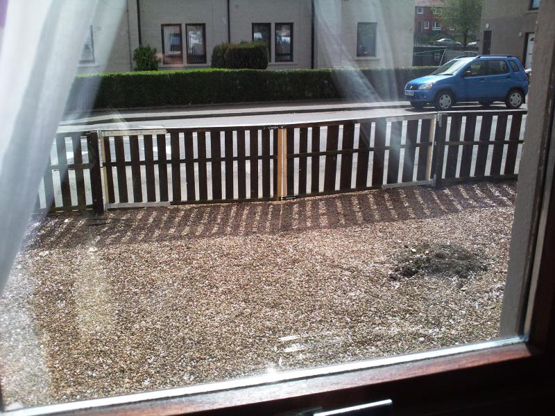

firstly im totally not great at diy im a welder not a builder lol recently my girlfriend has had trouble gettin her car window smashed an broken into so we decided to make gates in her fence an drive the car in the front garden the front garden has stones in it but has thick plastic below them which i guess stops us driving the car right in at the min im fearful the car would get stuck as the garden is little sloped and uneven.we were just wanting to get the car in off the street at the min would it work if i just placed few paving stones down loose on the stonesor can anyone give me some advice pls?iv added a pic below

I would suggest, and this is a Heath Robinson SHORT TERM possibility, is to run the car in - making tracks in the stones - take the car out, and assuming the young lady can accurately drive the car in using the same tracks time after time, you can reinforce the track area, by digging out 6 inches or so and put down some large aggregate, tamping it firmly down with a lage fence post.

its a short term fix at the min i will try drivin car on to make tracks but will the plastic underneath be ok to drive over ?
Depends what gauge it is - the worst that can happen is the pressure of the stones will make little holes in it. If you get any weeds later, stick some more poly down - it's as cheap as chips.

was just scared car would get stuckas stones are bout 5" deep in places but will give it a go :D thanks
Try probing the stones with the wrong end of a rake or hoe handle, or a bamboo cane, to establish where its at its deepest. If its deepest nearest the house (presuming car is front wheel drive) then reverse it in at a slight slant - that should do the trick.
