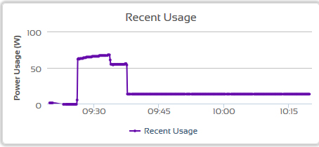

A Jaguar XE but I will guess most cars the same, if the battery is low, it disables the stop/start, we went around 75 miles yesterday and no stop/start, battery about 1 year old, but car not used much, so stuck on charge today.
I have an energy meter so seemed good idea to use it.
This shows quite a short time at 3.8 amp and 3 amp, then dropped to 0.8 amp which will clearly at that output take a long time to charge to a point where it drops to 0.1 amp and charger will then show as fully charged, but started charge 9:26 am and dropped to 0.8 amp by 9:38 am that's around 0.6 Ah, it's a 90 Ah battery, so that is nothing really, so why no stop/start?

I looked back at the monitor
2 watt = 0.1 amp it would take a long time to charge at that rate, the charger alternates between 0.1 amp and 0.8 amp with a battery over 12 Ah, so at 14.4 volts it drops to 0.1 amp, and at 12.8 volts it will switch back to 0.8 amp, so battery sits most of the time at 12.8 volt, each time it drops below the threshold it switches back on for a few seconds, at 0.8 amp then quickly hits 14.4 volt and drops again to 12.8 volt. Can only use smart charger as a AGM (VRLA) type battery.

That little 3.8 amp Lidi charger even on the Kia Sorrento battery or caravan battery does not charge at 3.8 amp for long, it may sit at 0.8 amp for days, but the 3.8 and 3 amp stages are completed in 5 hours even with a rather discharged caravan battery. So 20 Ah pushed into the 90 Ah battery at 3.8 and 3 amp, but the remaining 70 Ah can take days to get into the batteries.
But at 0.1 amp and 12.8 volt I am not sure if leaving the charger connected is actually helping? I note with the jump start battery 12 Ah VRLA even after 3 months standing the battery takes minutes before charge rate drops, the AGM or VRLA seem to hold their charge well, but Jag has not been filled up since March, it has done a few trips, but not enough to keep it fully charged.
