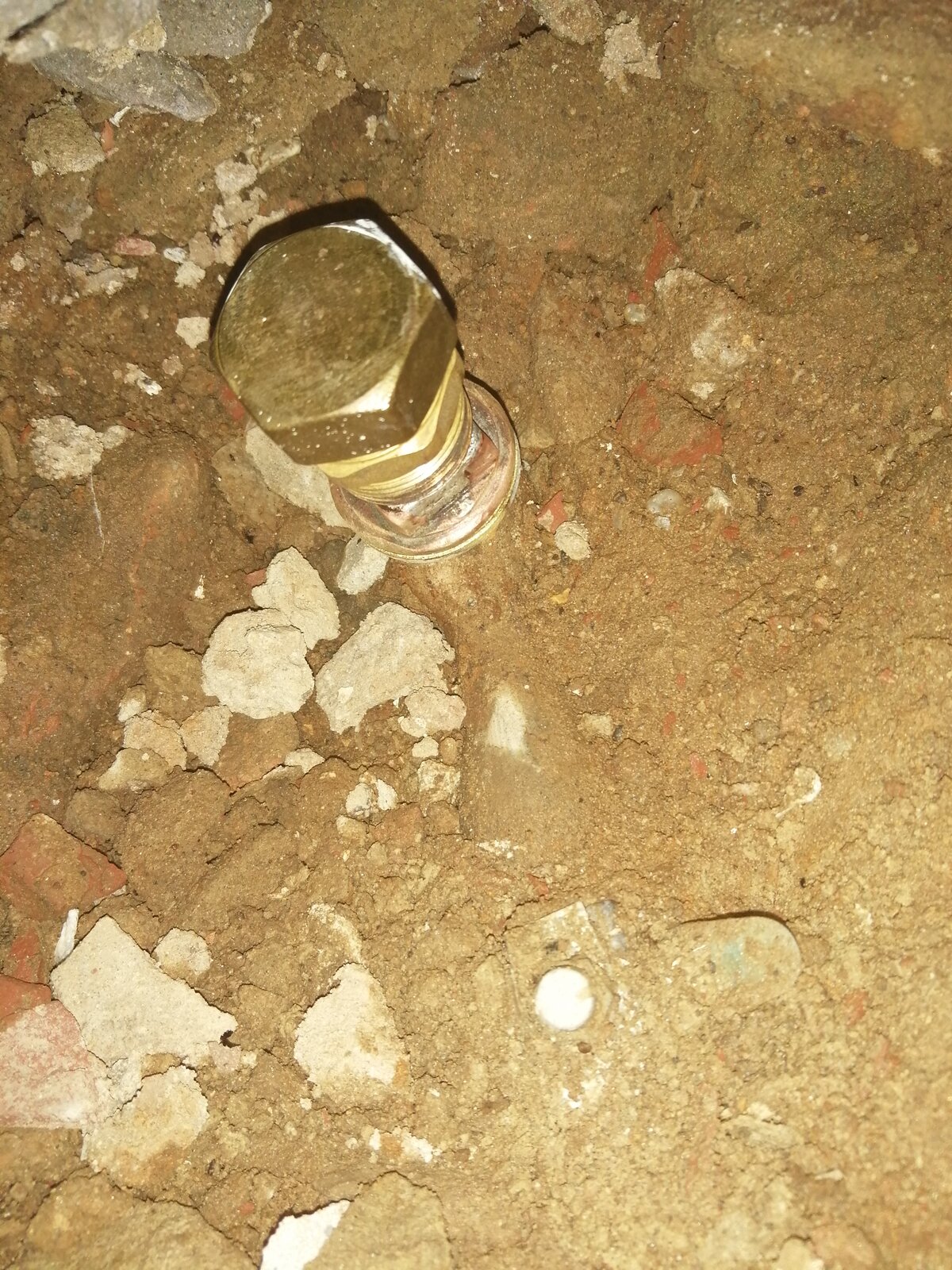

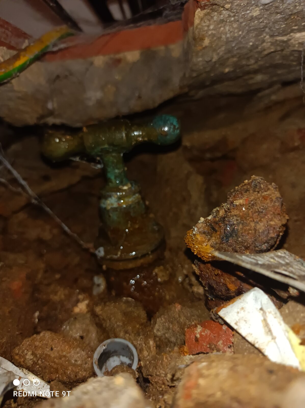

Hi, I have a c100 year old mains stopcock on lead pipe leaking from the gland nut area. Image shows hellish position. Note the glad nut end isn't hex but round/gnarled. I have tried to get some mole grips around the nut but given the proximit to body and lack of space to work that just isn't going to fly. I've resigned myself to digging out a bit of working space but would really appreciate sugestions for how to get that nut out - any tools, ideas or techniques would be really appreciated. Oh, and is the whole assembly likely to fall apart and leave me flooded/with no mains water. Many thanks in advance.

The problem you have here is if it's that old then any persuasion that it may need may be too great and it could then snap the tap or the pipe. A plumber would normally know how far to go before it's liable to snap and then stop and re-assess if it doesn't budge.
Clear access though is the first thing and is there access to the outside mains stop tap? The easiest thing may be to isolate and cut it out and then using a lead trans adapter (philmac/leadloc/plasson) to add a new run in after that point with a new lever valve attached. Again though that needs a competent or experienced touch to get the lead clean and round enough to accept an adapter properly.
Thanks all for the advice above. It put me off trying myself so I just had this done by a plumber - very glad that I didn't try myself else pretty sure I would have put too much pressure on the lead pipe. They cut out the stopcock head in several pieces with an angle grinder and sealed off. (Blow torch and wire drill attachment came into it somewhere) Two plumbers and took about 3 hours.
